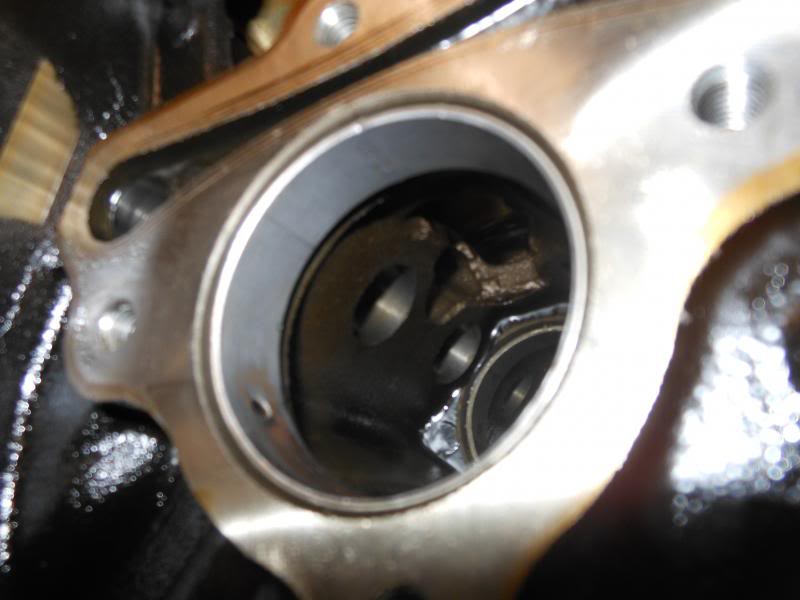

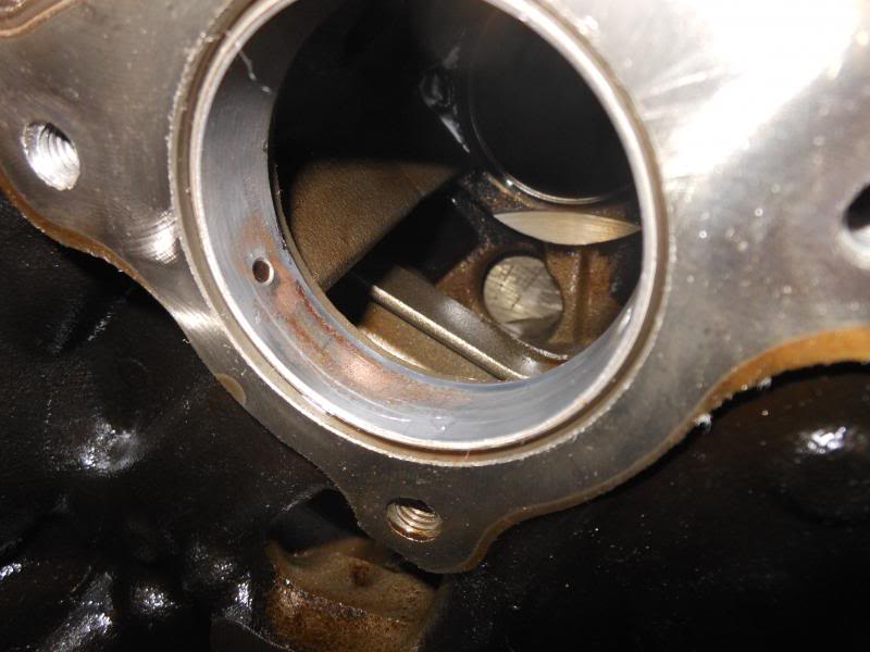

I can feel some wear one the top of the bearing as well.
Old Mar 9, 2014 | 11:36 AM
  #105
GMCtrk's Avatar
iTrader: (27)
Posts: 12,275
Likes: 19
From: Dallas
It does appear that there are some scratches there. Are those the ones you can feel? But that copper appearance is supposedly normal.
Old Mar 9, 2014 | 11:44 AM
  #106
Mortiz's Avatar
Formerly PurplePearl (2014-04-06)
Joined: Dec 2011
Posts: 262
The other ones I can feel are at 300-360 degrees. I was surprised when I got it apart since it only had 60k on it.
