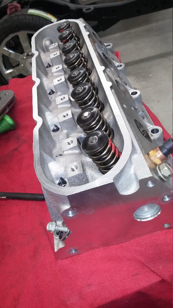

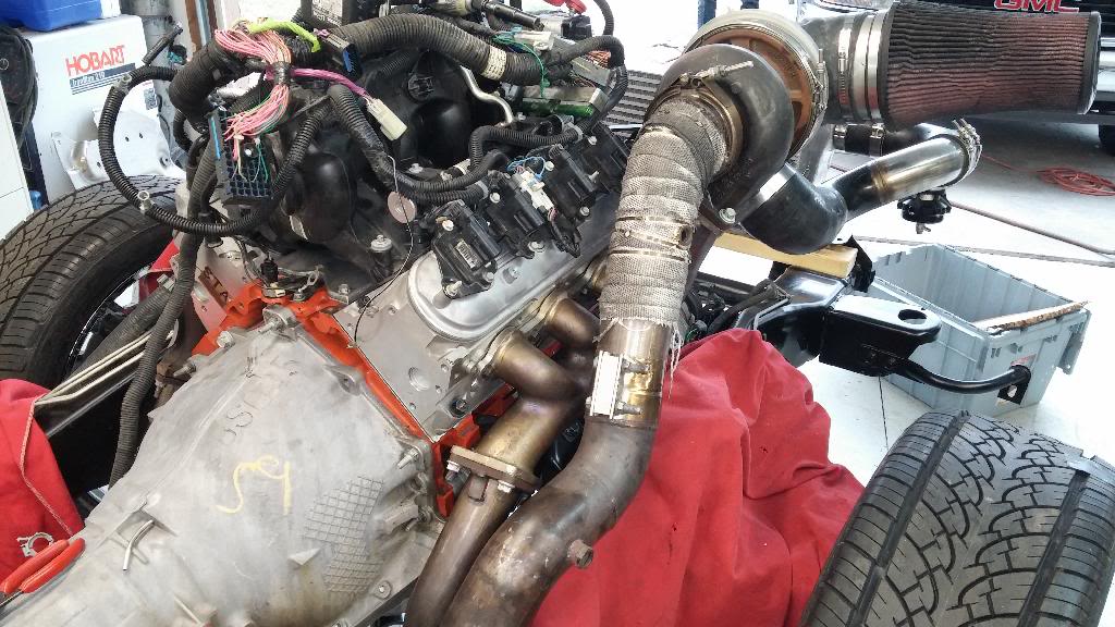

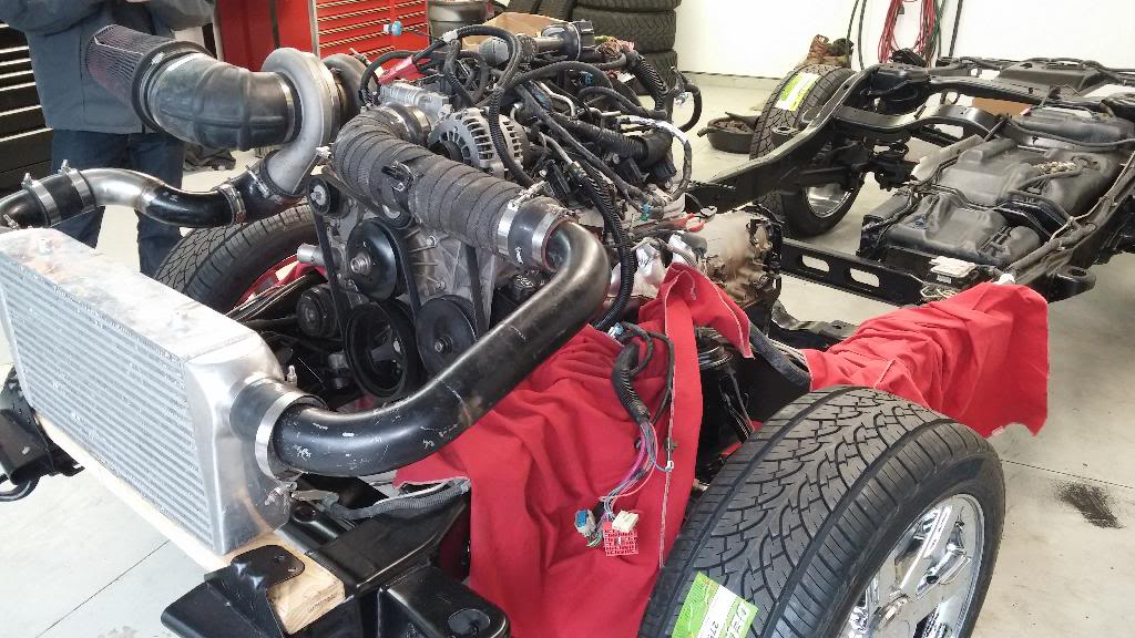

Dual Springs installed!

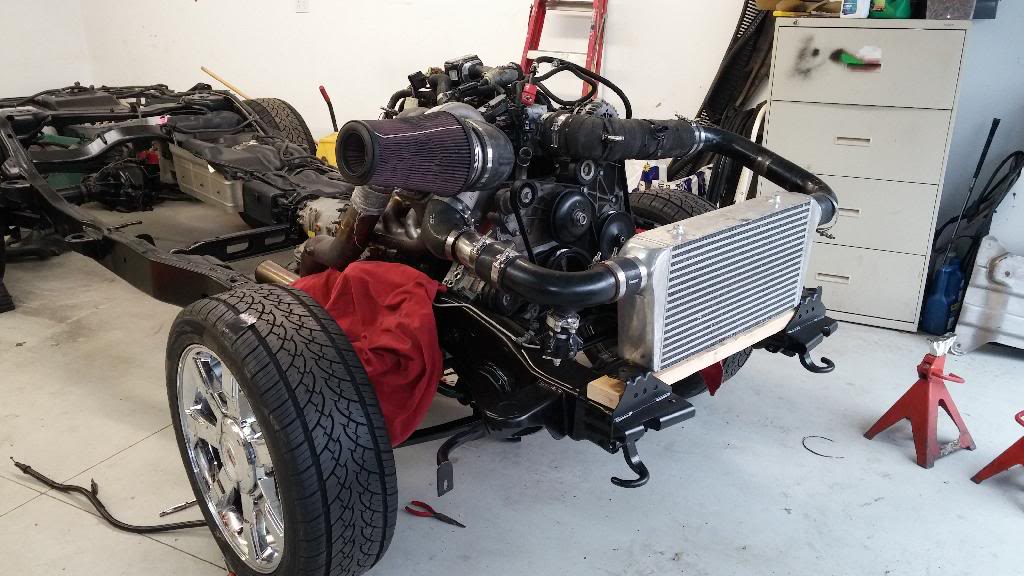

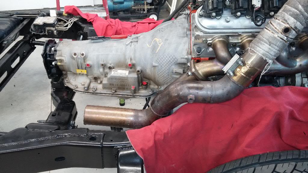

This look correct for the intercooler piping?

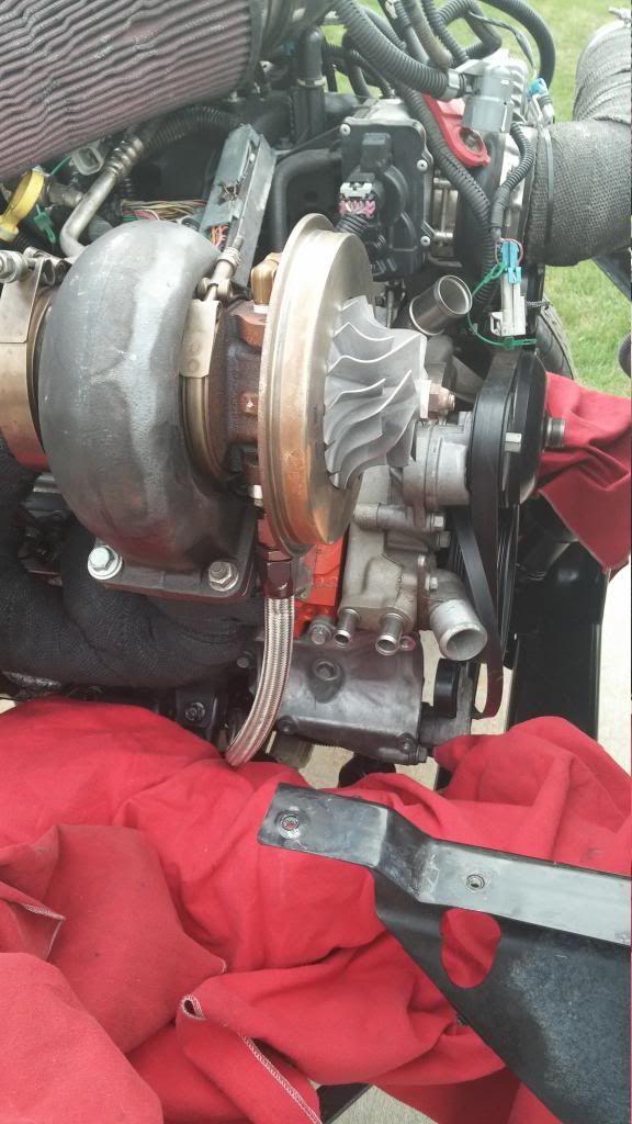

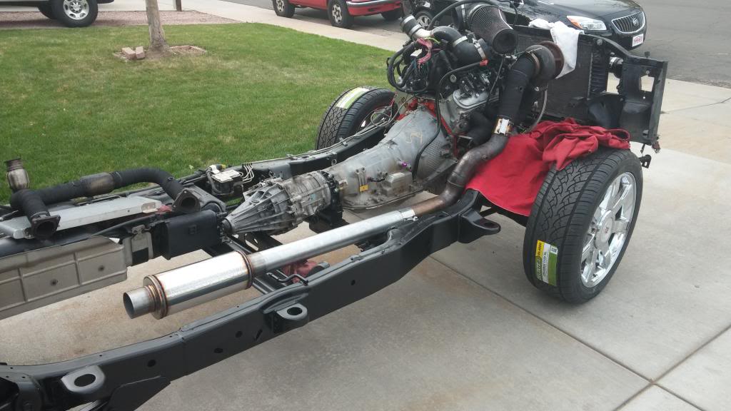

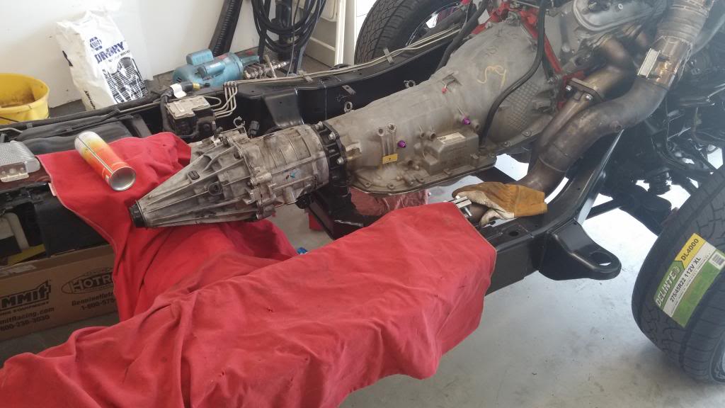

Input Shaft changed and tcase in.

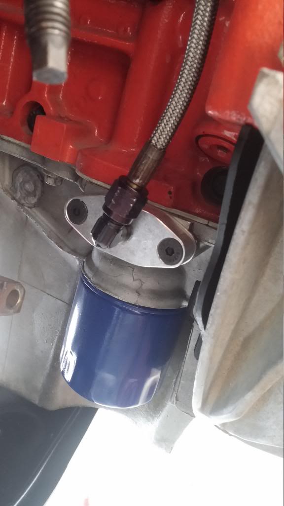

Oil feed.

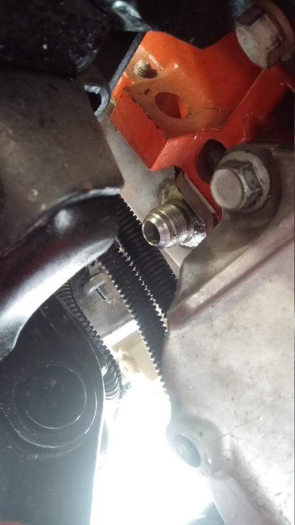

Return

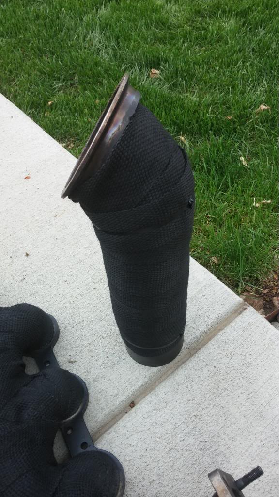

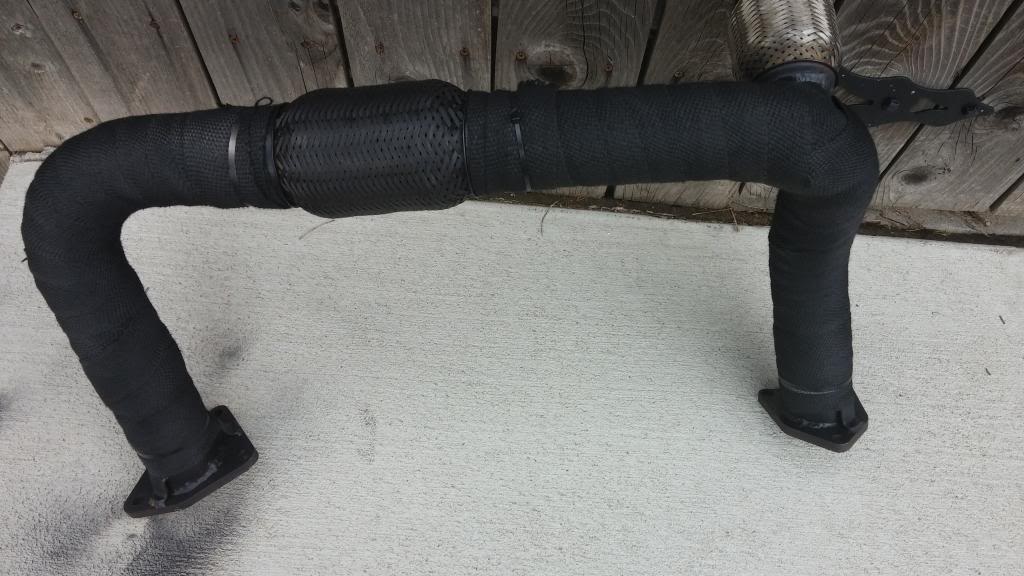

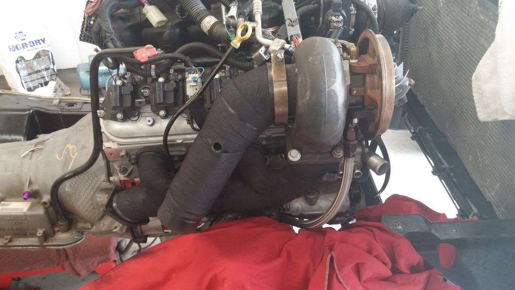

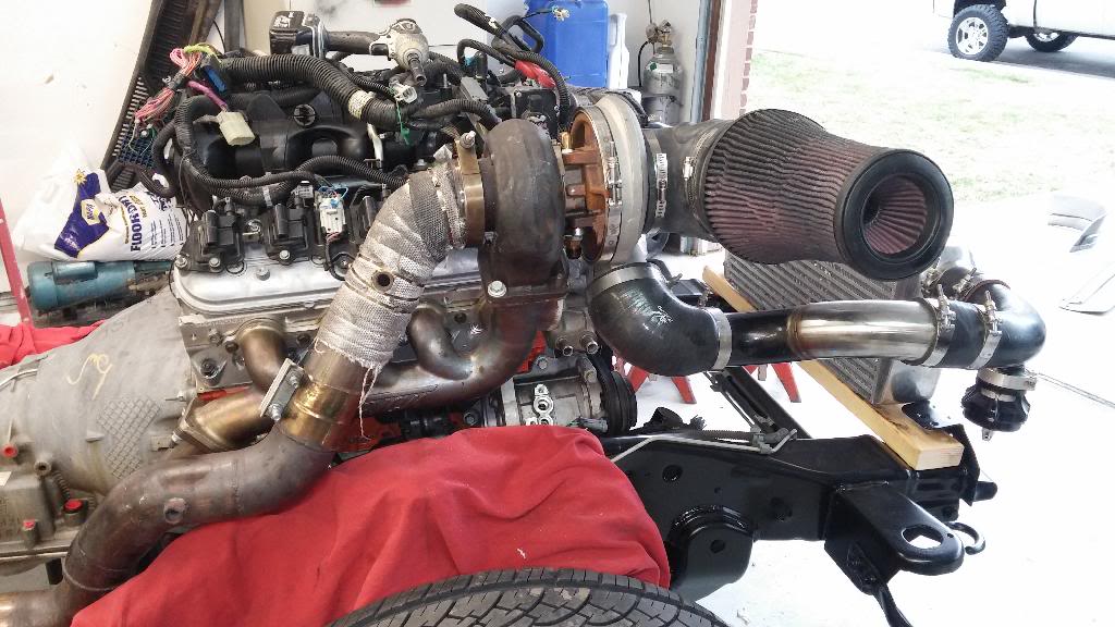

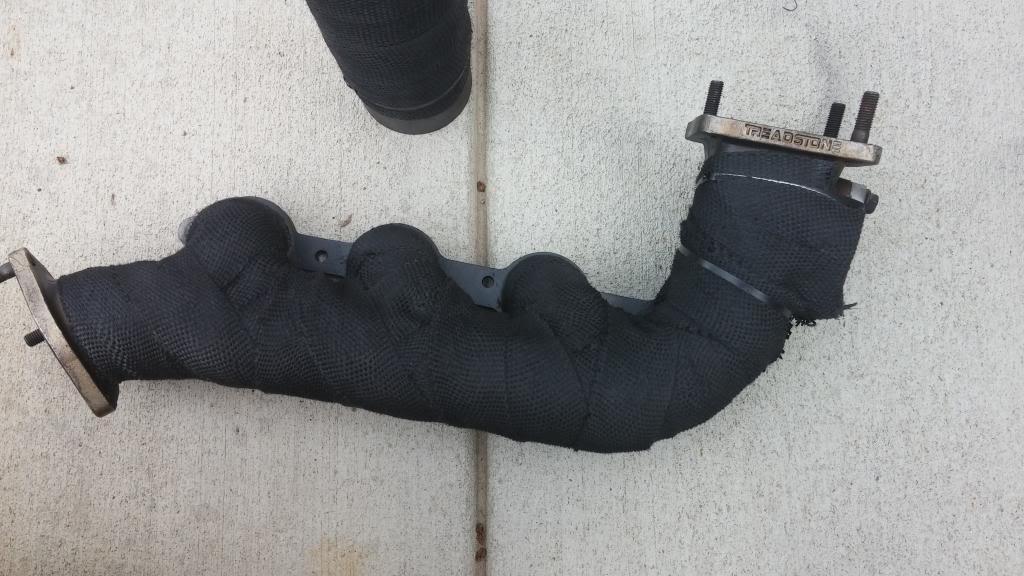

Hot Pipes Wrapped. (Used 100ft and had a little left over.)

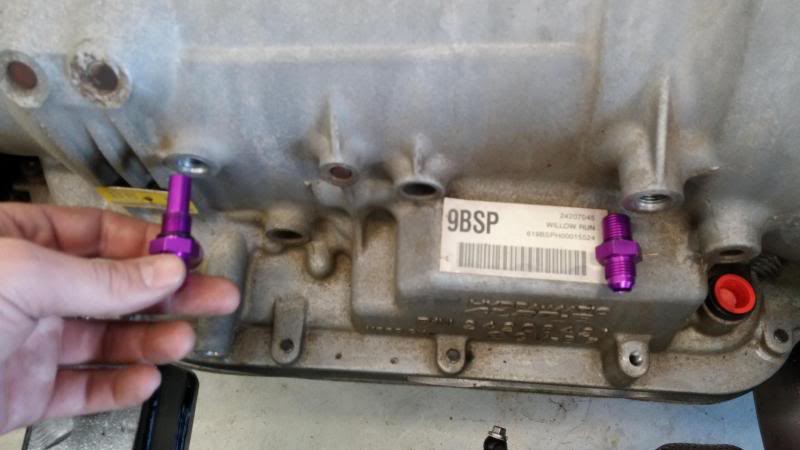

How come the 4l80 have different fittings?
Old May 4, 2014 | 10:11 PM
  #137
1FastBrick's Avatar
Custm2500's Rude Friend
Posts: 14,593
Likes: 900
From: JunkYard
The rear feeds through a Support. If you don't direct the fluid all the way through the support, it will cross leak losing pressure and burn the unit up.
Rather quickly from what I have seen/heard right hear on the forum's by people that have used the wrong fitting.
