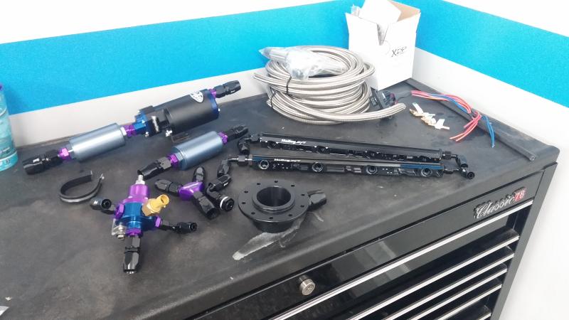

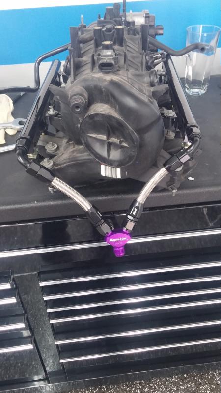

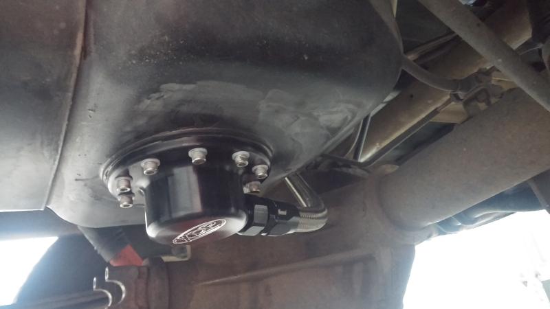

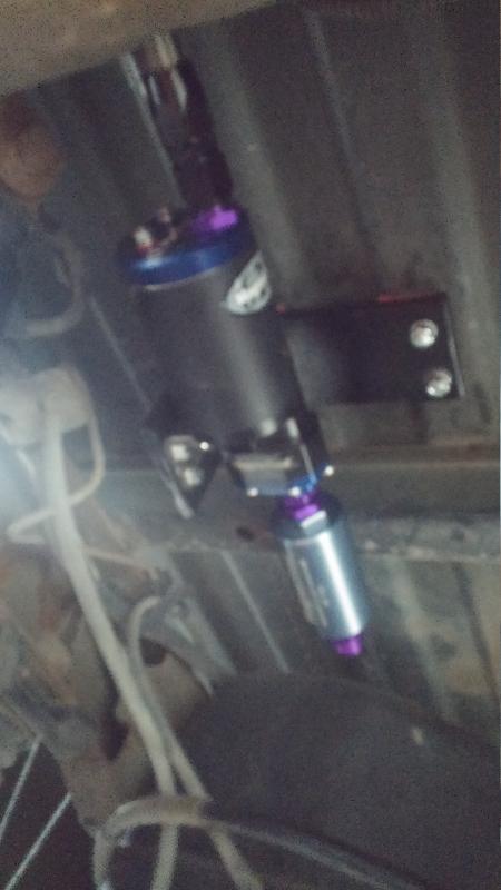

Here is the fuel system for e85.
127ln injectors
magnafuel 4301 pump
magnafuel filters
magnafuel regulators
holley rails
diesel sump kit
12 an to pump- 10an y'ed into 8an to rails- 6an to regulators- 8an to tank

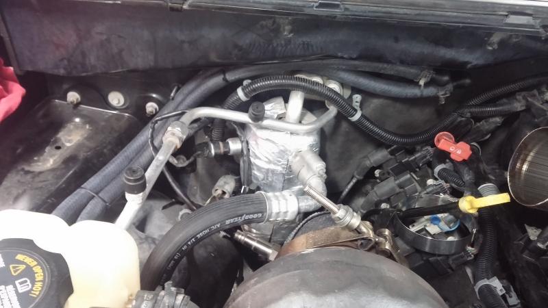

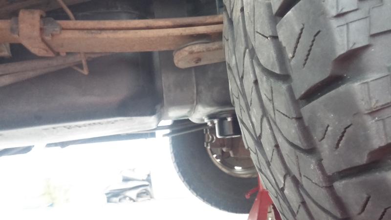

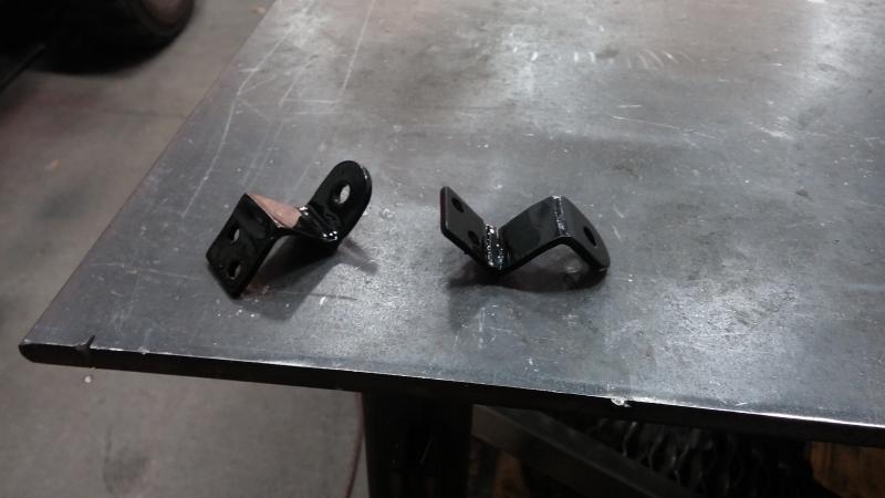

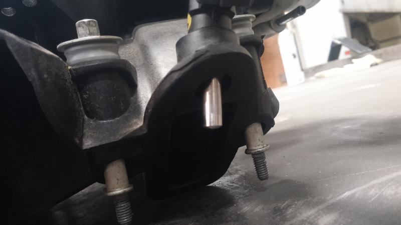

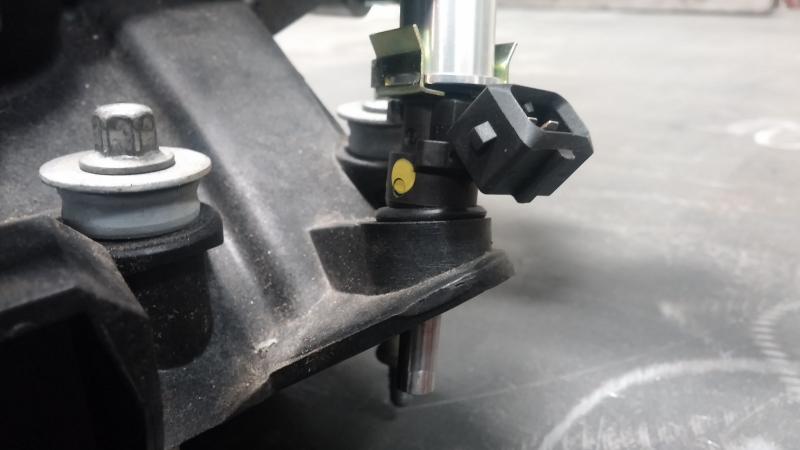

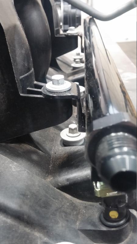

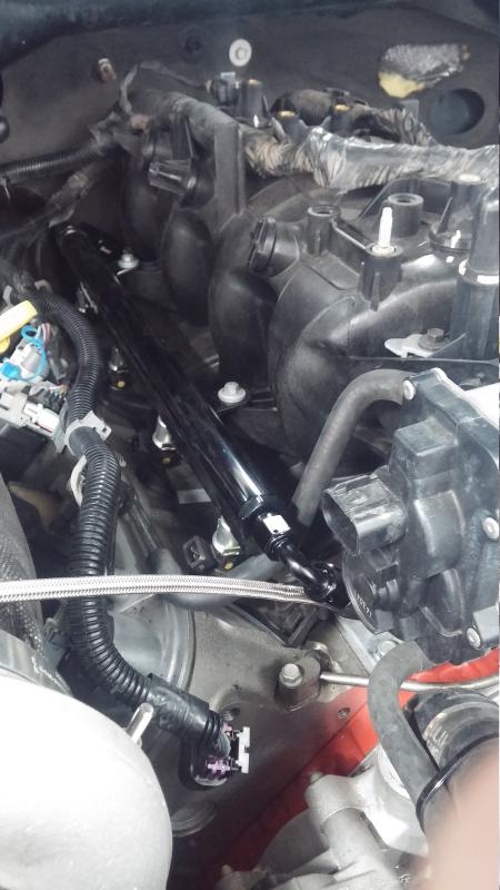

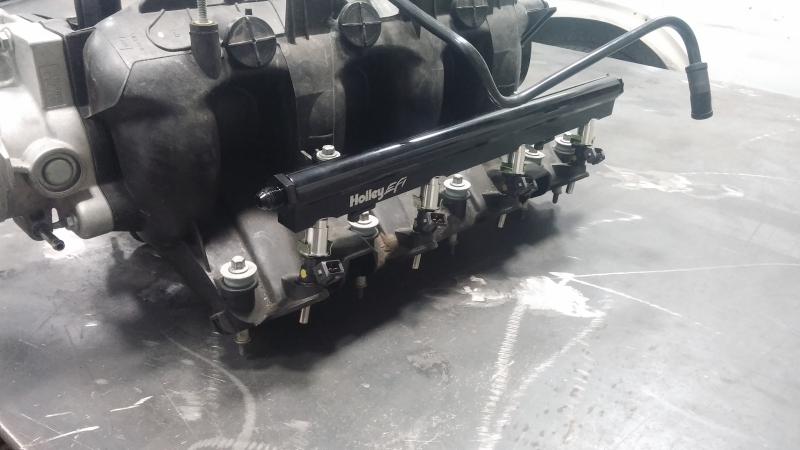

Interesting mounting these holley rails and injectors. Please let me know if you think this would be an issue. I built custom brackets. But they rails dont have a way to hold the injectors in besides down force. But the injectors go all the way through until the plastic on the injector hits the plastic on the intake. So I put an oring on the injector. I think this will work.

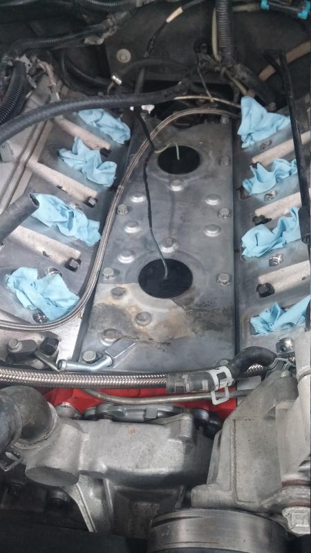

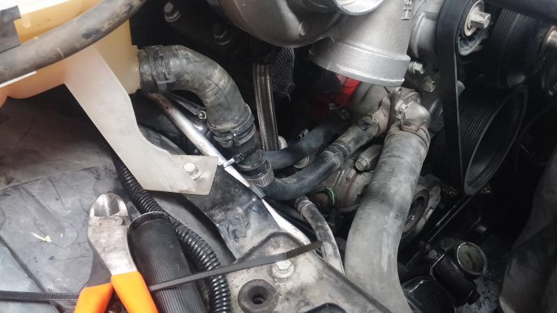

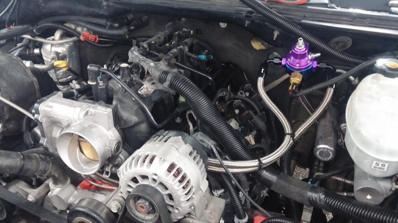

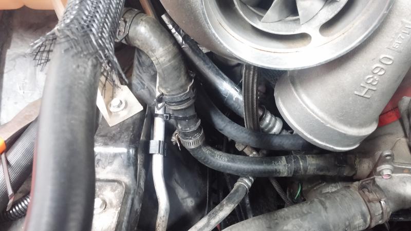

LS6 Valley Cover Installed
