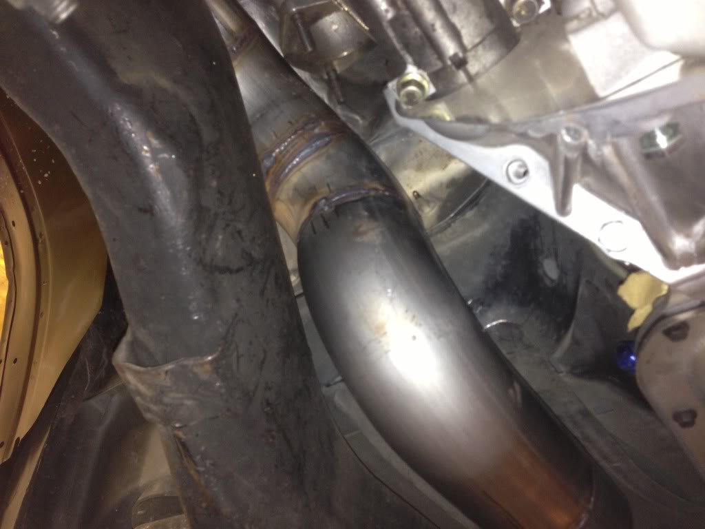

Just got these pics from Rick.

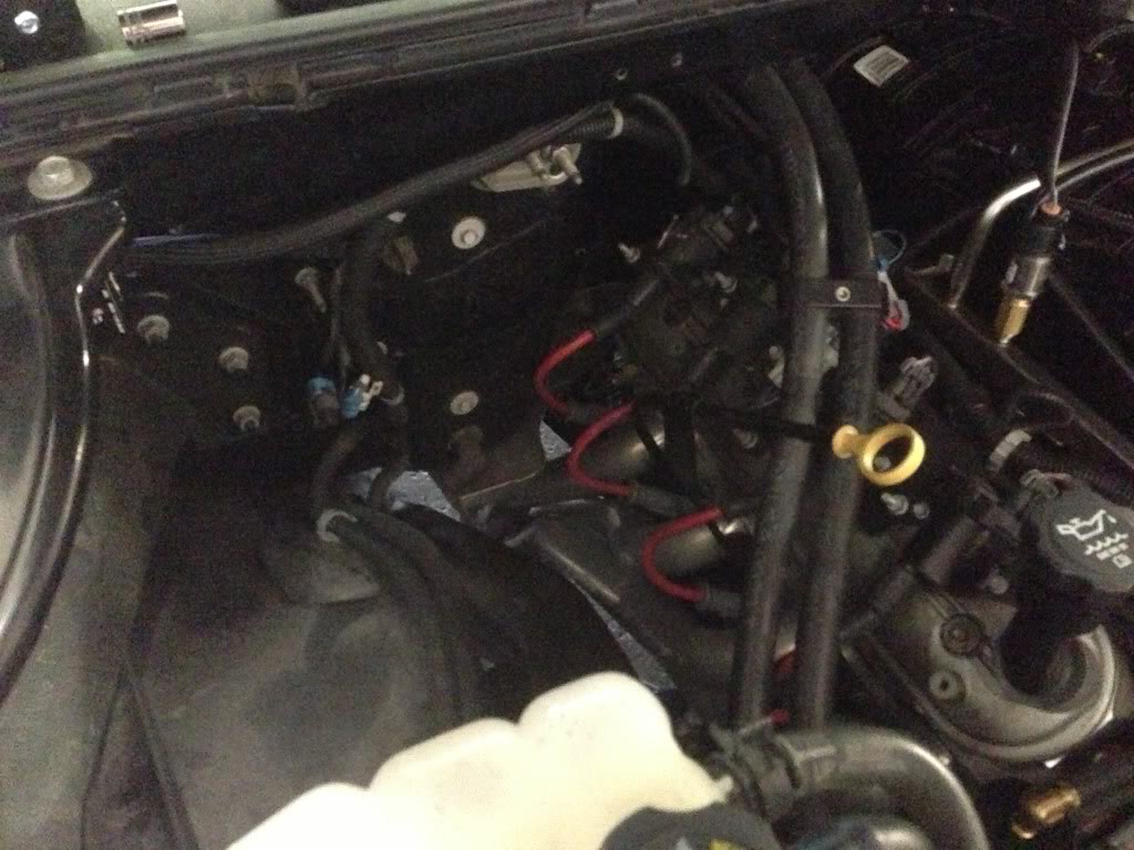

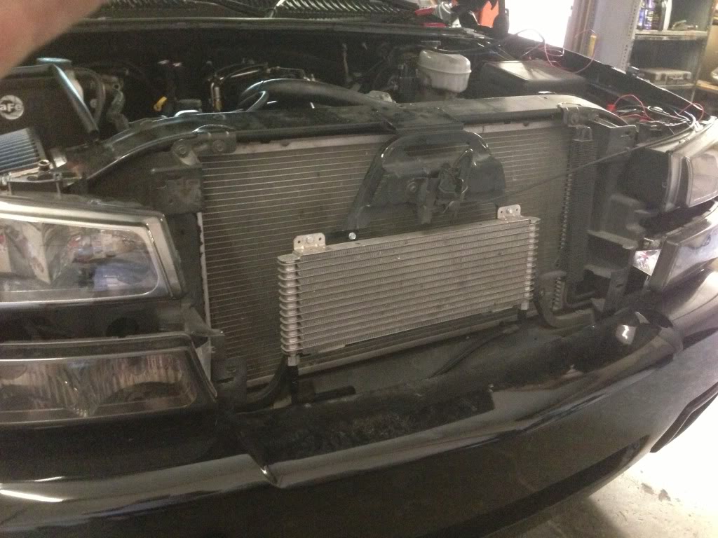

Got the two step installed today. It literally took less than 10 min to install and mount since I already had an unused momentary switch in the truck. Its pretty fun to use with open headers. I cut the exhaust out of the truck yesterday and stripped the A/C today. It sucks knowing I will never have A/C in the summers here but it has never functioned properly since I put a V8 in this truck. Could never figure out what was wrong. Anyways here is a vid of the 2 step and some pics without the A/C. So much room for activities without the accumulator and lines there.
MSD 2 Step with Open Headers - YouTube

Thanks buddy! There will be plenty more I'm sure. I can never leave this truck alone
Originally Posted by UBLUZIN03
Whats custom about your trick kit? is it a different kit or just some custom pieces?
I had Rick build me a 4" downpipe because I didn't think the 3" would be enough for when I put my 408ci back in this truck. He also set me up with a 4" thick intercooler, wg vented to the downpipe, and IAT/wideband bungs.
