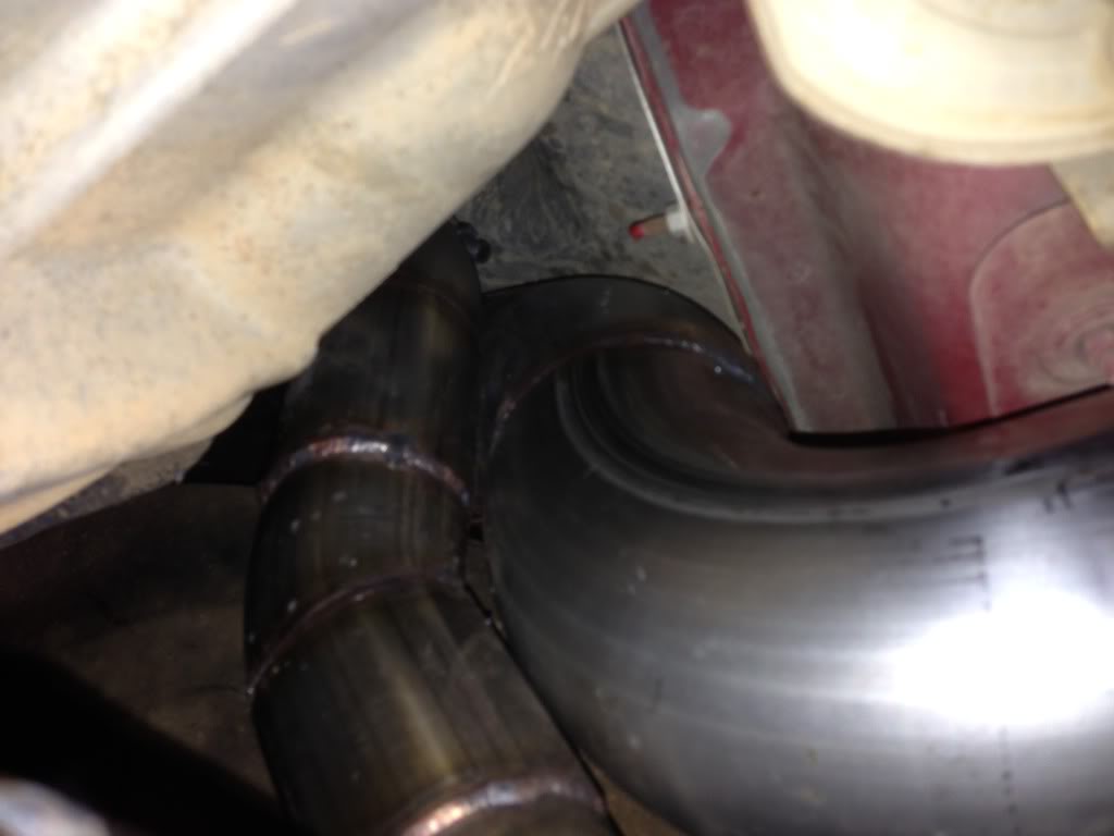

Rick finished up the hot pipes and sent me a couple pics.
Looks like a tight squeeze between the dp and crossover. Should ship out real soon!
