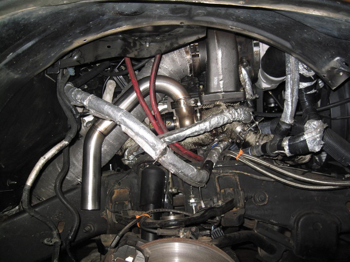

My favorite gopro spot

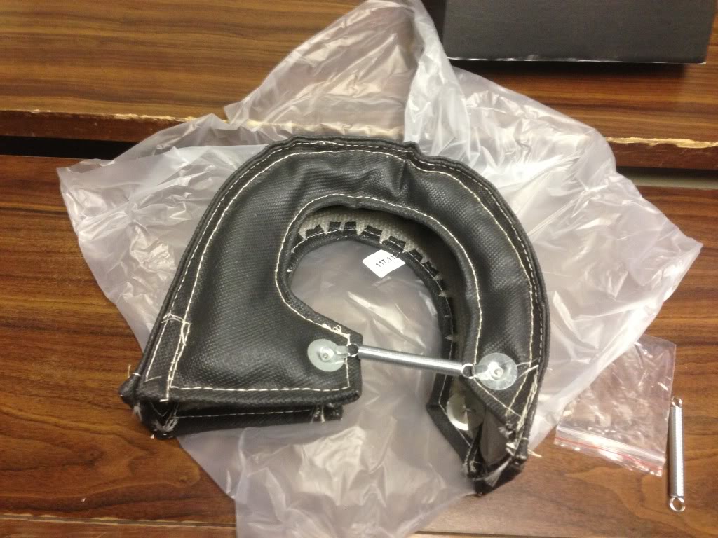

Turbo blanket came in today. Just need a turbo now

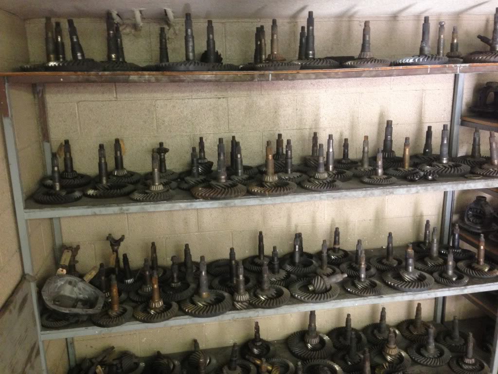

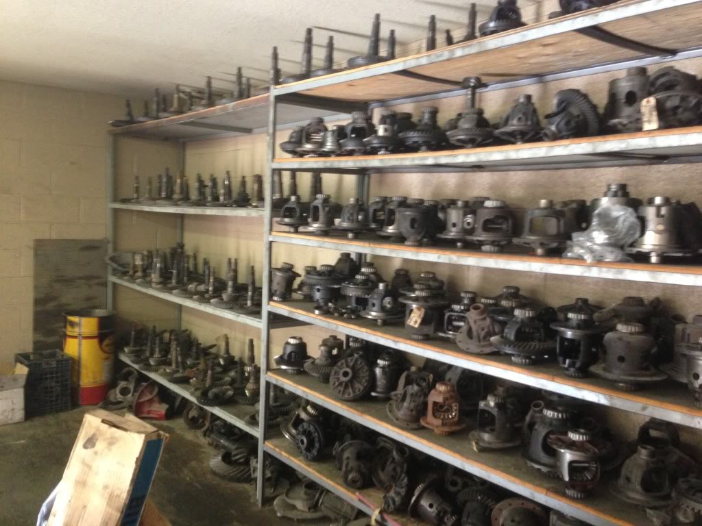

Anyone want this stuff?

Dam do you rebuild differentials or something? May need to come to you for mine... Hah!

I used a 4" nipple to try and get the hose as far away from the turbo as I could...didnt want the rubber melting.

My grandpa opened Driveline Service of Las Vegas 40 years ago and these are just a percentage of good take outs from over the years.

Any pics of this? Did your turbo come tapped for an NPT fitting on the return side or you tapped it yourself?

I used an adapter piece that had 1/2" npt thread...
You can kind of see it here:
It goes down to 90 degree fitting and the hose is wrapped in that heat wrap and wraps around to the oil pan.
