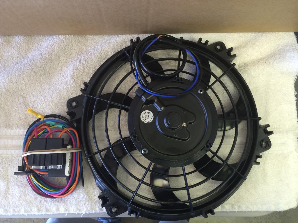

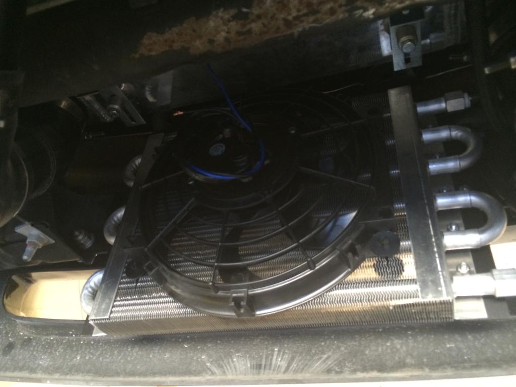

So I got a flexalite fan for my transcooler and a hayden automotive relay/controller for it. The fan is a 10" s blade that pulls 800cfm so I'm thinking it should work well. The fan will come on at 160* and hopefully keep the trans fluid temp around 175 or so driving around town.

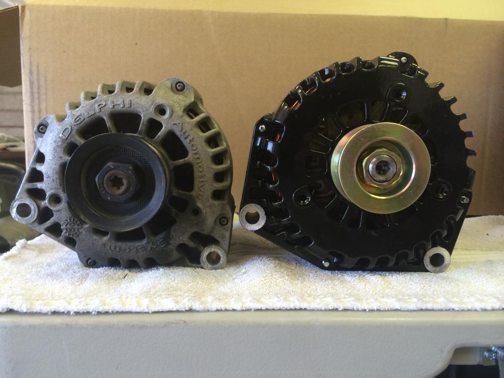

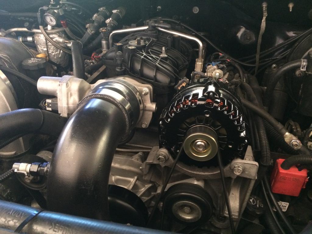

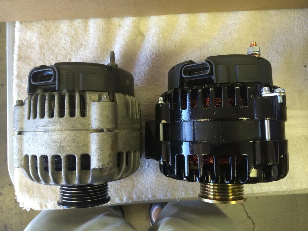

I was having some voltage issues since I installed the A/C in the truck. With that running and the fans on high, my stereo system ect., I was seeing voltage down around 12v or below. So I ordered a 8237B Tuff Stuff 200 amp alternator and a 2 gauge charging wire. I read a couple threads about this alternator where they came from the factory dead so I was kind of paranoid about it. I got it installed and what do you know... Not charging at all. The first start, voltage dropped down to 10.5v.. I redid a 10 gauge ground wire for the top of the alternator like stated in the box thinking the ground I was using was bad. This time I ran the ground strait to the battery. Still no dice. So I was pissed and took a break. Eating lunch it just came to me that I didn't plug the harness into the alternator Went back into the shop, plugged it in, and it works like a champ. Voltage sits in between 13.5v - 14v and doesn't budge from that. Talk about a retard moment.

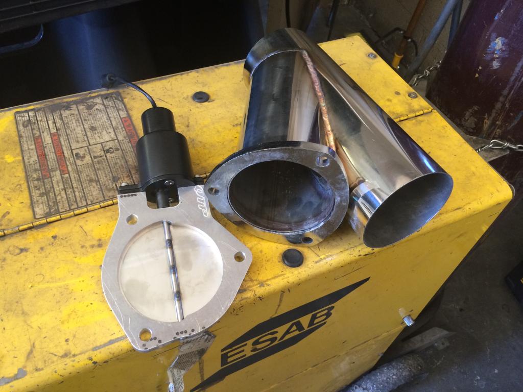

Next I got a QTP 4" cutout for my exhaust system. I never planned on running a cut out on this set up but it was an impulse buy. I already have a QTP switch in my truck from the 383 SBC set up I ran a while ago but never took it out. So I thought it would be a real simple bolt in that I could add. 4" looks cray big compared to the dual 2.5" I ran with the 383. I also ordered some VHT gray primer to hit my welds with when I get the exhaust in to keep from rusting. No that that is a problem here in Vegas but I thought I might as well. Anyway, here are some pics of the parts and some install pics.
Compared to my 105 amp ALT

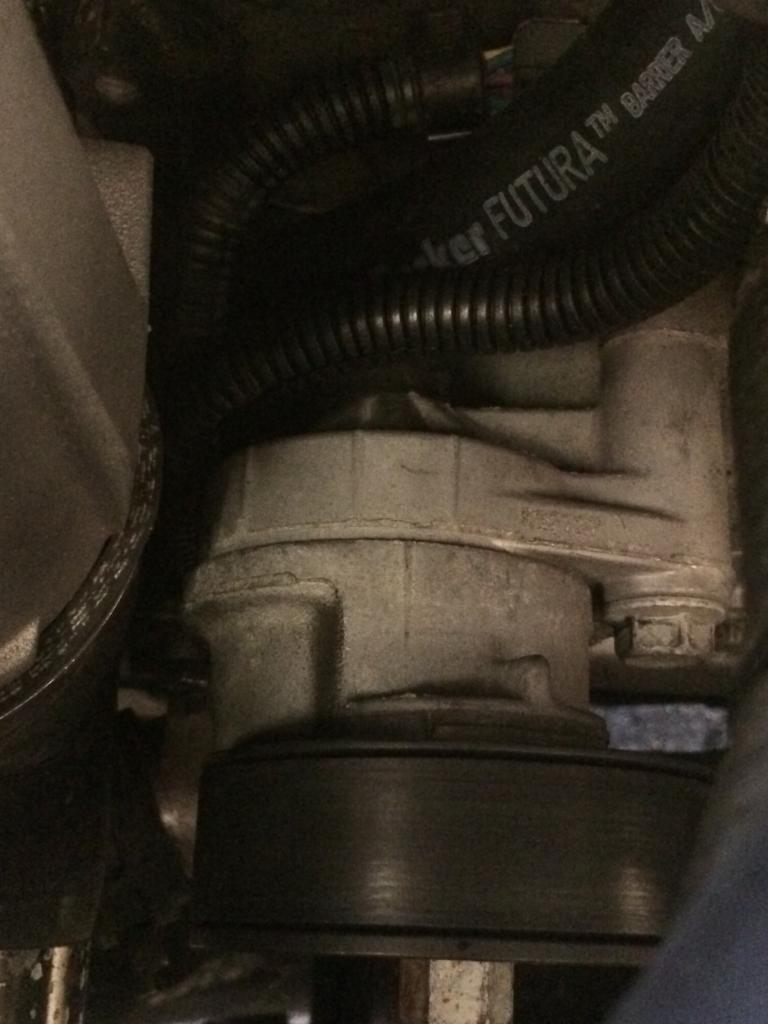

Here is the tensioner. You can see it is on the tight side. Probably could use a 1/2" or so shorter belt. I don't want to post up a non sponsor link but I bought mine through atech/summit for $255. Part number 8237B
