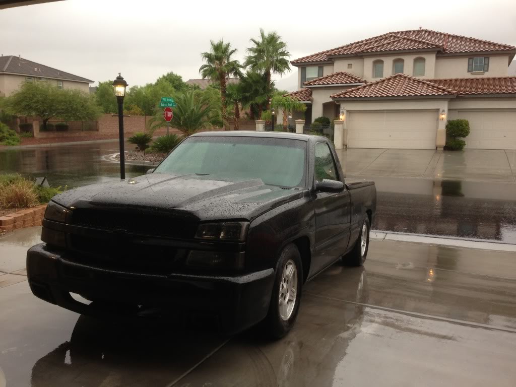

It's flash flooding here in Vegas. Cooled off 30 degrees so I thought I would see how the SD tune reacts to such a drastic weather change. It defiantly is more picky than a MAF tune. But it still ran great. I was walking out of the door and saw my Go Pro laying there. I popped it on the window and went for a little cruise. I think I will use this mounting spot for future vids. Anyways, nothing fun to see in the vid, but there will be in a few weeks when the turbo stuff gets here
New 4.8L with SD tune in the rain - YouTube
