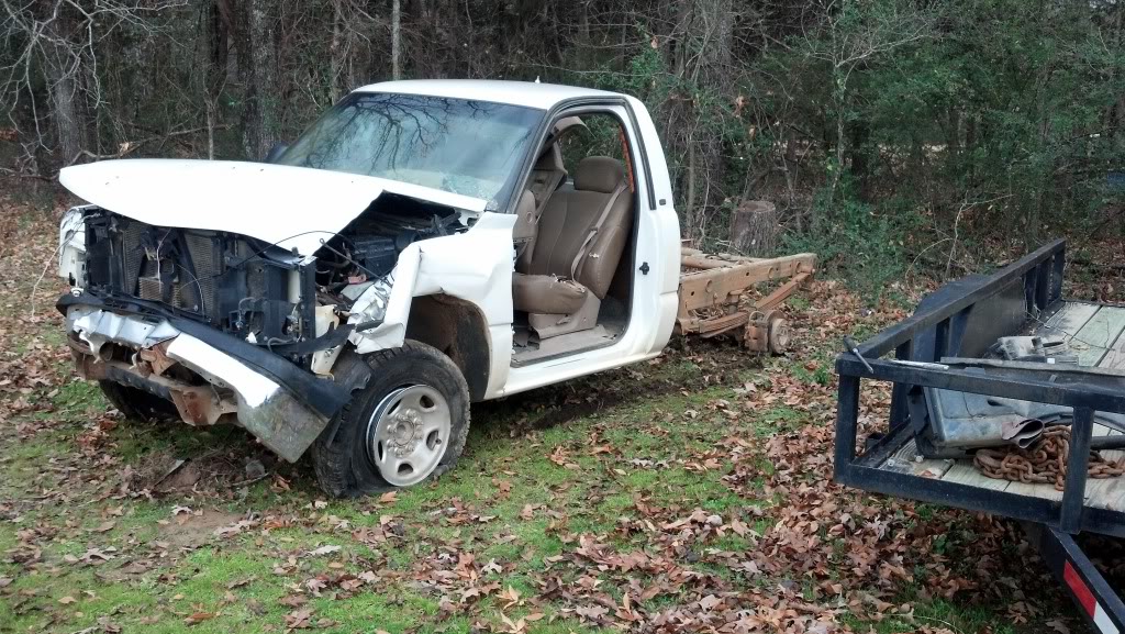

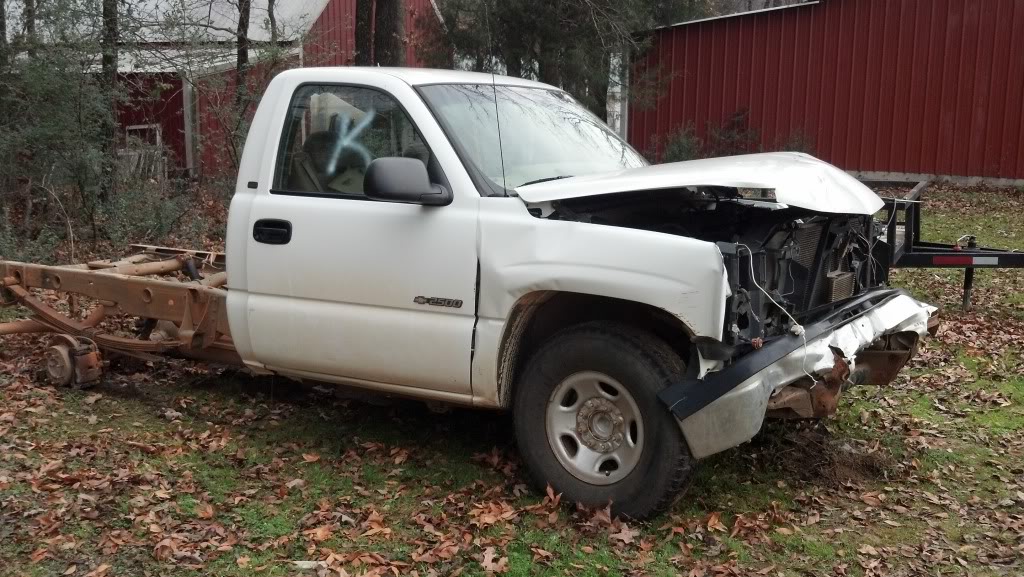

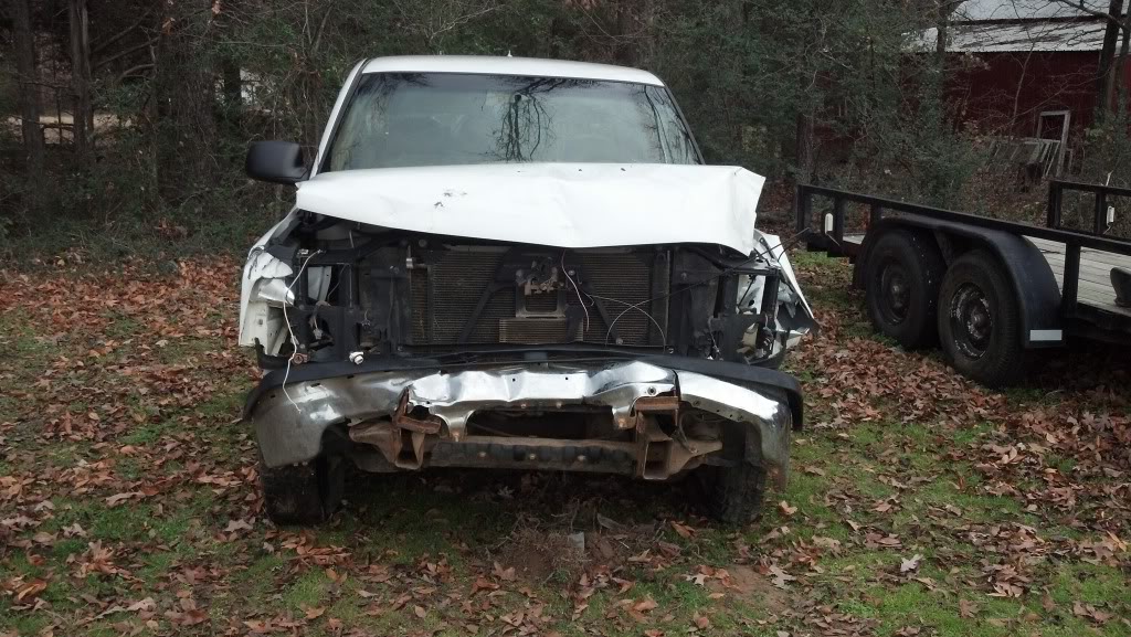

Hey guys. I found a lead on a wrecked 2000 2500 at a local junkyard. Hustled around, did some trading, and got into this thing for about $500. Although, I didn't know anything at all about the truck, I thought I might try the gamble. I had a thread previously about the truck.
Donor Truck:
Did some searching around in the truck and found this:

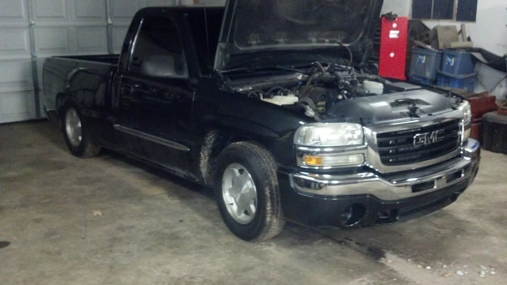

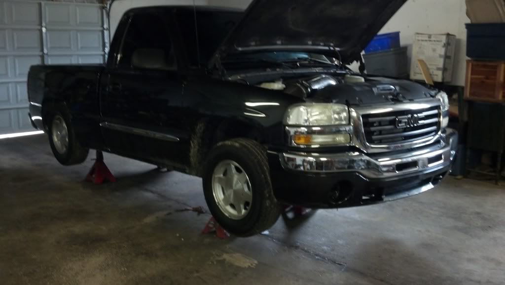

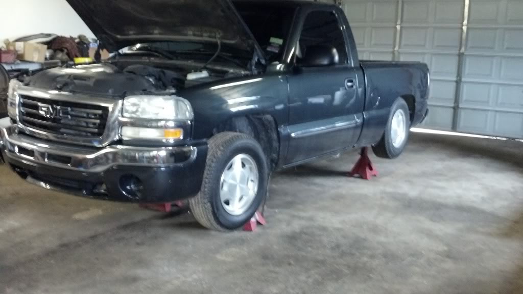

So hopefully, this will end up being a good gamble. Before I went throught with the trade, I checked all the fluids and made sure the motor turned over. I'm going to keep my fingers crossed that it turns out to be a good motor. Here's some pics of my truck as it currently sits, waiting for the swap.

Haven't been able to do a whole lot here lately. The weather has been terrible here, and the donor truck is outside.

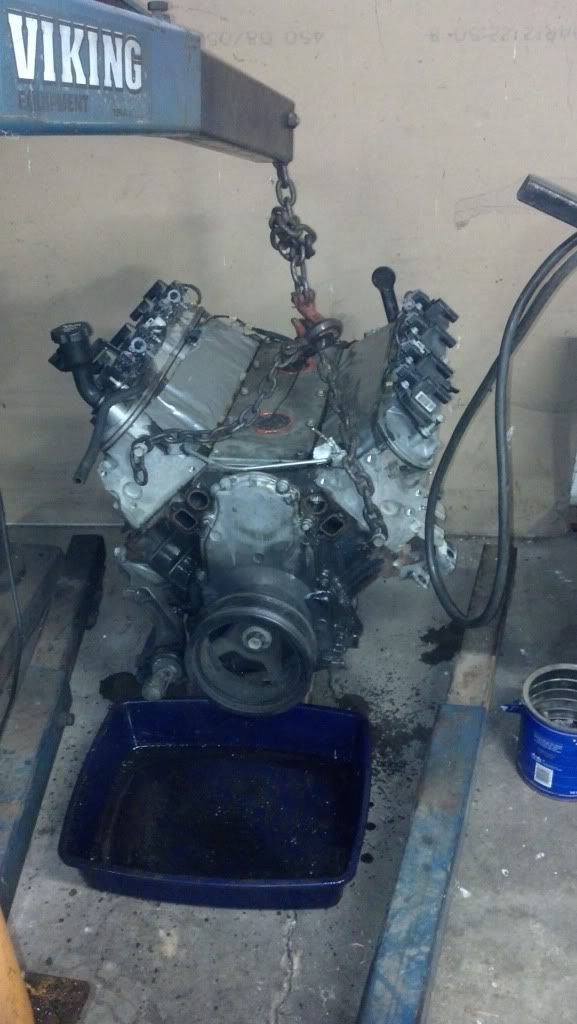

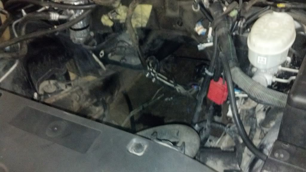

Got the old 5.3 out:

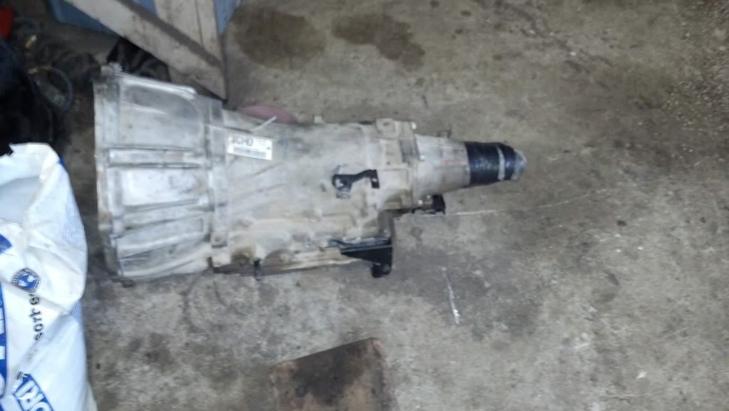

Old 4l60:
The truck as it sits currently:
Donor truck likes the starter and tranny cross member and it will be ready to come out. I plan on swapping my old cam into it while its out. Also gonna throw a new timing chain on it.
