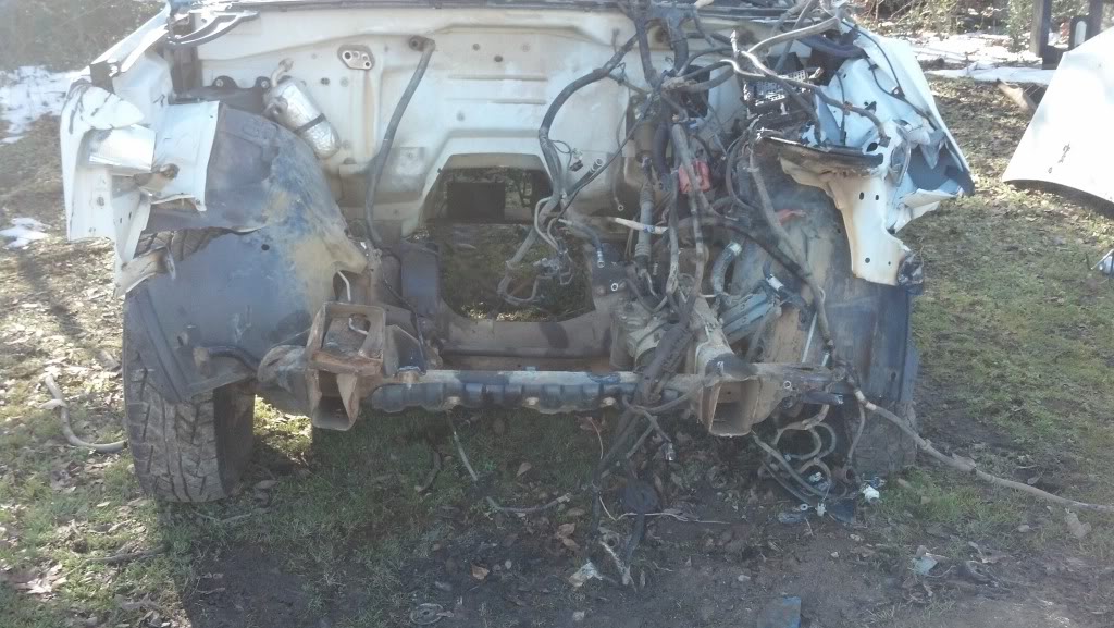

A little update:
Got the 6.0 and 4l80 out of the donor truck

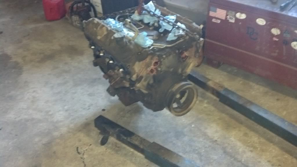

Motor and trans were nasty

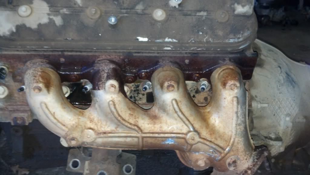

Found that the driver side exhaust manifold had been off before. The exhaust manifold bolts were broken off in the head in the front and back.

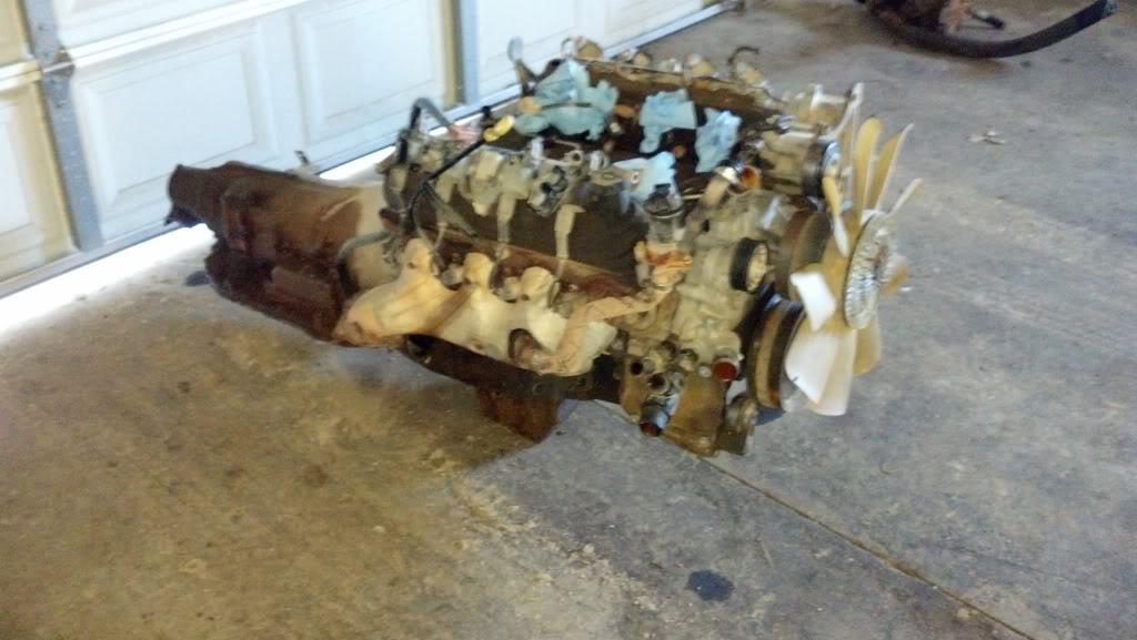

Engine separated from trans

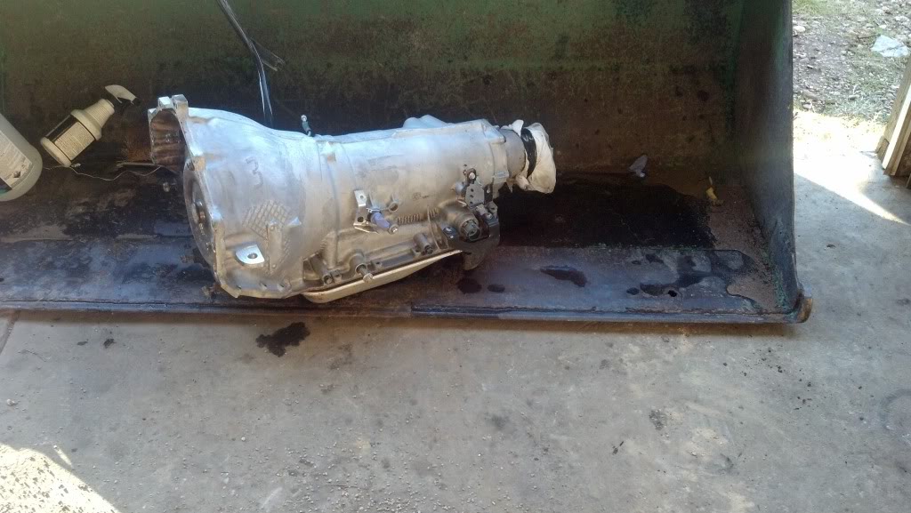

Got the trans cleaned up. Alumakleen does wonders

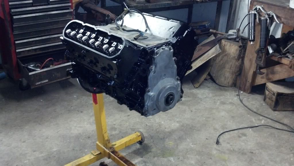

Another little update.
Been cleaning stuff for a week, and it seems like I'm barely making any progress. I did get my cam swapped and my HD timing chain on. Going to have to get a new o ring for the pickup tube tm. Here's a pic of the motor currently:
I'm still trying to figure out what I'm going to do for the trans wiring. Is rather do the 60e tune, because I will not have to perform a segment swap, but I cannot find much information on how to do all the wiring.
