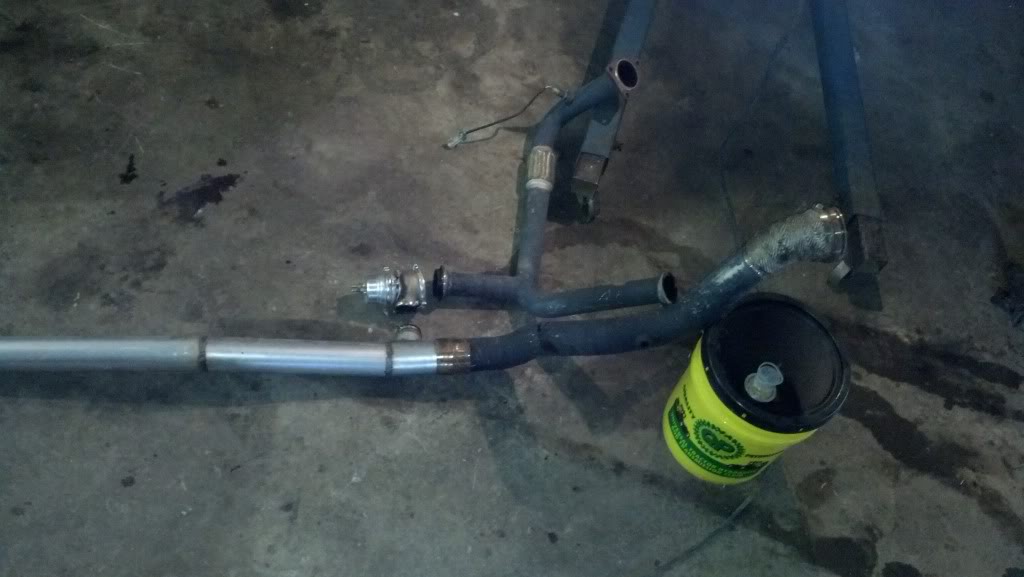

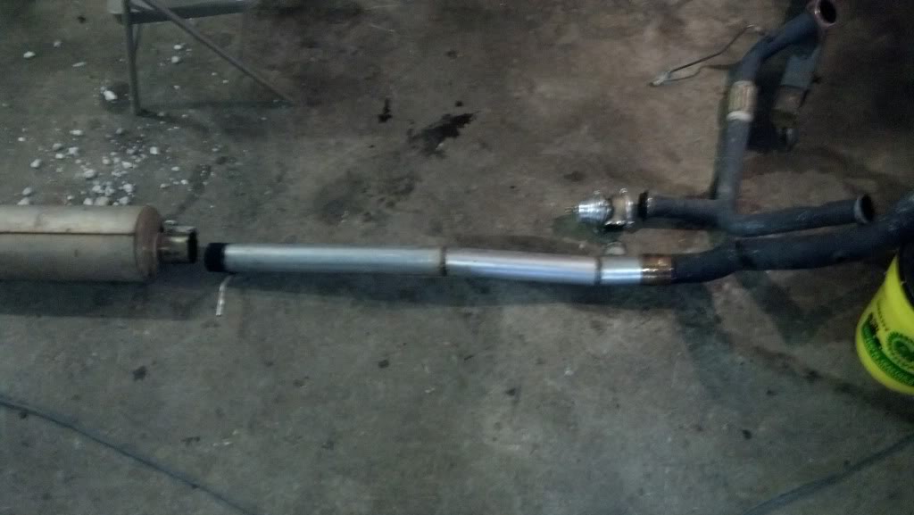

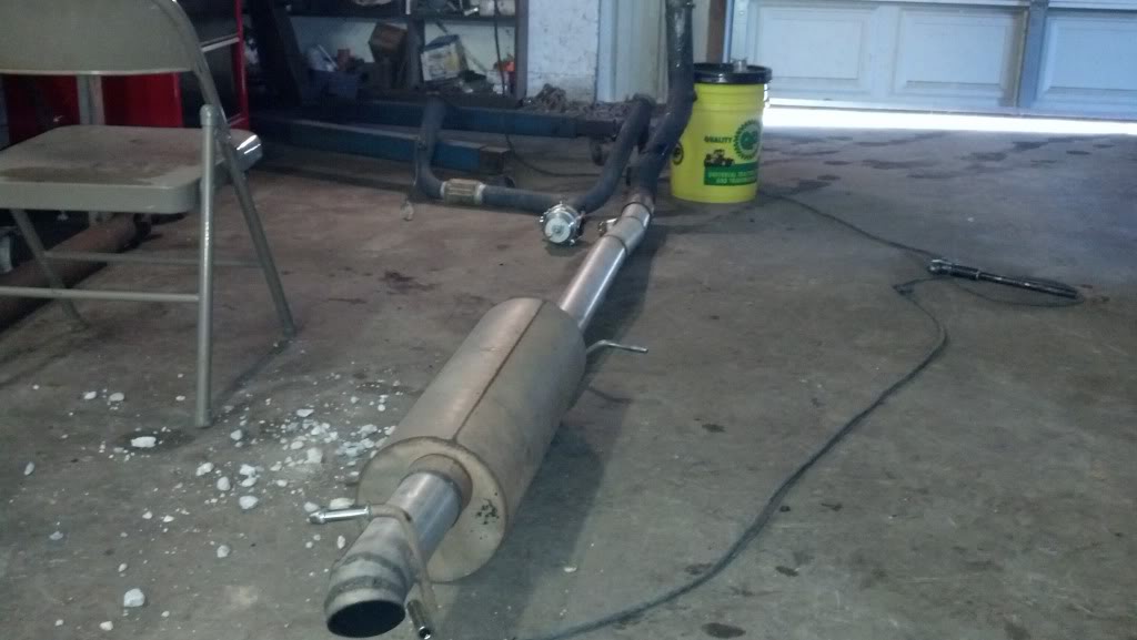

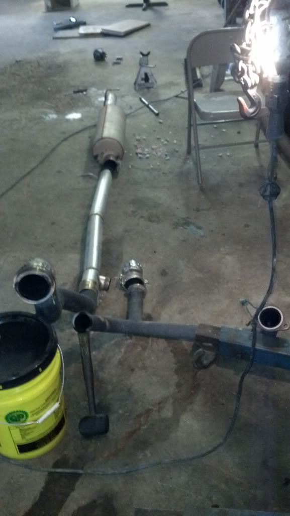

Well Ive deceided as of now, that I'm going to let my converter ride for a little bit. Im hoping it will loosen up as my power goes up.
I did take some pictures of my exhaust while I had everything apart. Everyone always asks me about my kit. So, I figured i'd get some pics while I had it down. The shop was a wreck when I took the pics, and the lighting sucks in there. But for the people that ask about building their own hotpipes, maybe these will help.

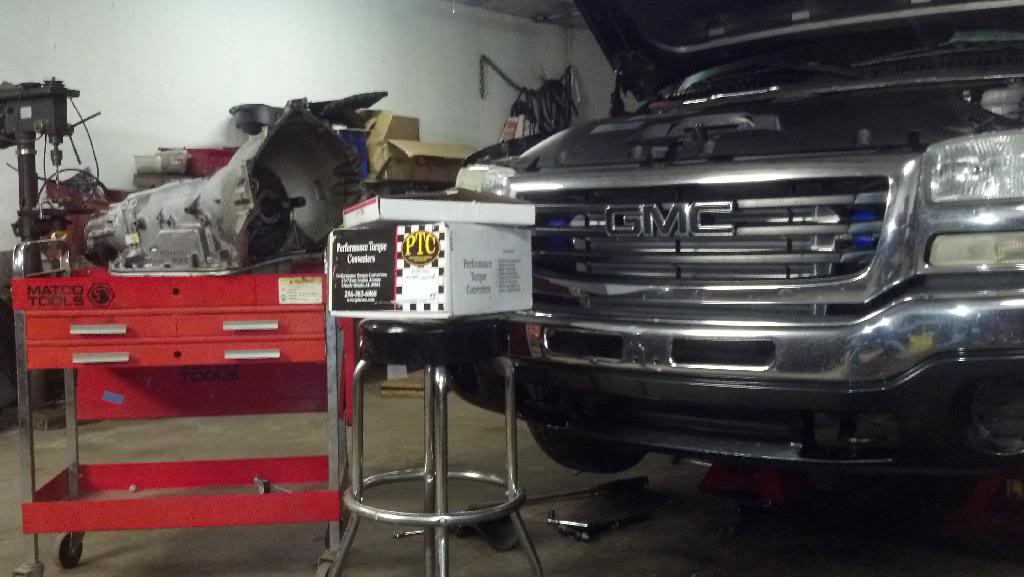

Figured I would do another little update.
Long story short, the snout on the converter I was shipped was .400" too long. The snout ended up bottoming out in the crankshaft area, and knocked the pump out in the transmission. This took a few hundred miles. Anyways, the low line pressure attributed to the pump cause my torque converter clutch to drag. I think this affected the converters performance. Also, broke the flexplate. It feels much better now. Here's a picture I took during the re-install.
