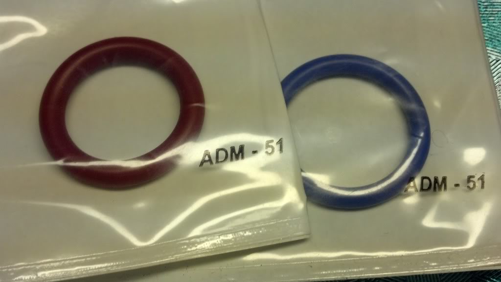

I grabbed both o rings because I wasn't sure what revision I needed. Should i use the blue or red. Its a iron headed 2000 6.0. What's the best way to install these without pinching them? Put it on the pickup tube first?

Which pick up o ring did you use? Did your pickup tube have the indentation against the flange?
I used the blue one. The red one did not have a chance of going on. It didn't really have an indentation, almost like a loose fitting flange around the tube that bolted to oil pump.
