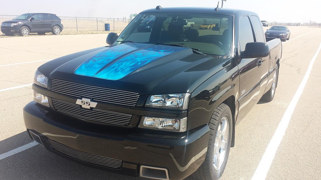

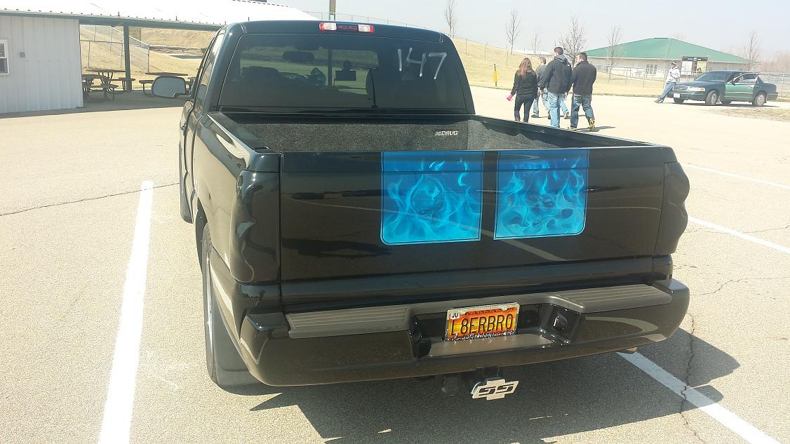

Went to Heartland Park Topeka yesterday to get a baseline on my truck before the blower and other engine mods start going on. Here are my results...
https://www.youtube.com/watch?v=Qc5HozWM2vM
Attached Thumbnails LVL 4 FLT 80e Swap into an '04 SSS-my-sss-track-times.jpg   LVL 4 FLT 80e Swap into an '04 SSS-march-29-rear.jpg   LVL 4 FLT 80e Swap into an '04 SSS-march-29-track.jpg
