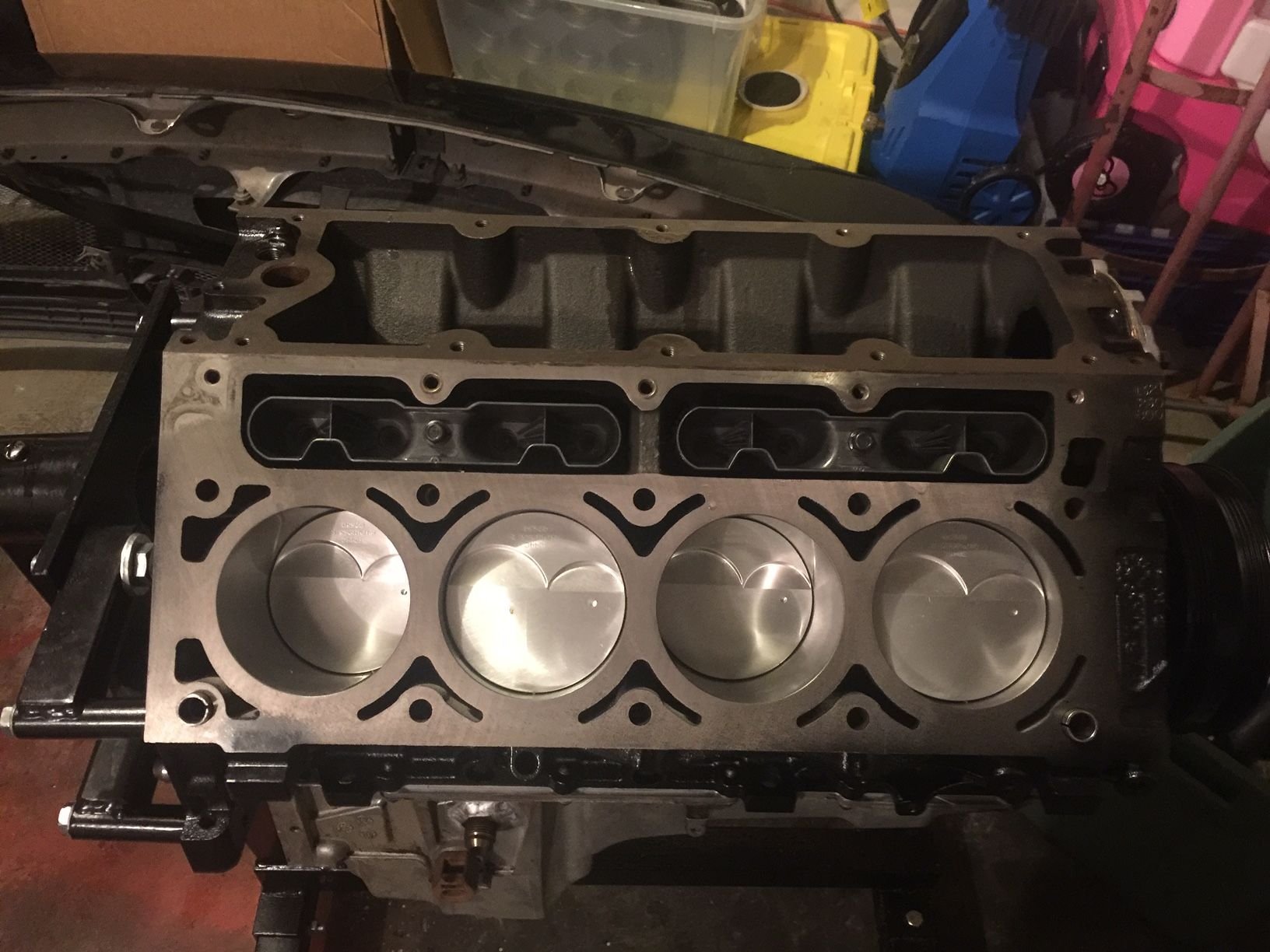

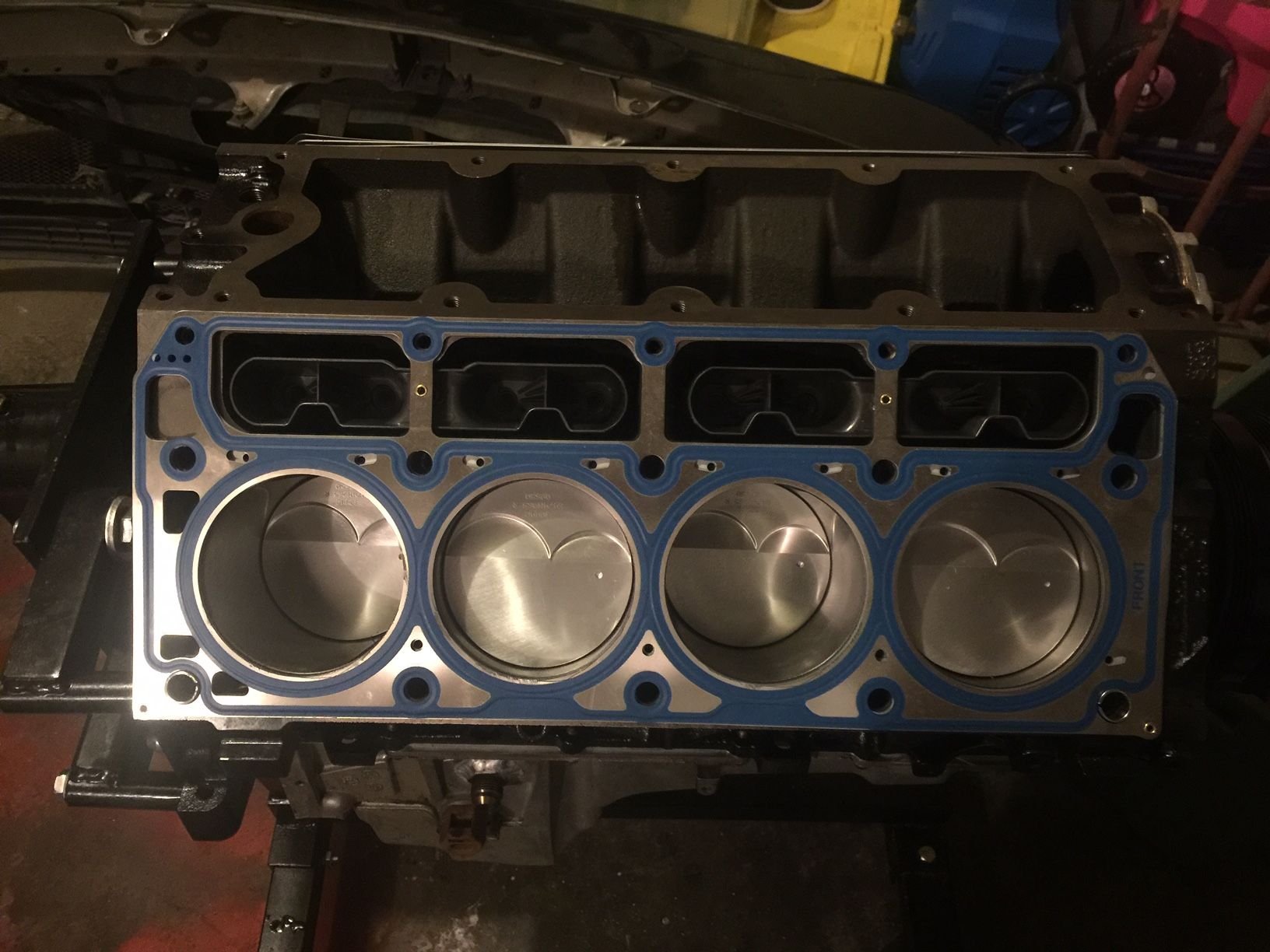

Drilled and Tapped for the oil feed. Used 1/4" drill bit all the way in then 25/64 bit for the fitting and then 7/16-20 tap.
Block came
Mmm Forged Pistons and H Beam Forged Rods also has a new Z06 Crank all balanced with in 1 gram
Milled .020 off my LQ4 317 Heads
Stuck the Heads on just for some pictures
