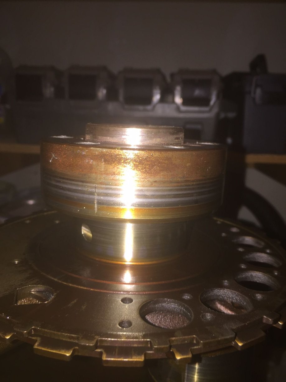

Yes he said if my old setup had a spacer I can take it off the crank I think he said I put it on mine. If not he said that I have to buy a new flex plate with one attached because he doesn't think they sell them separate that he has seen. I'll upload some pictures and maybe guys on here or you can help me out because I am clueless.
Old Oct 31, 2018 | 09:51 AM
  #44
RA62025's Avatar
Banned
Joined: Jun 2016
Posts: 243
Flex Plate Bolts
Old Crank
Old Crank Again
New Crank
New Crank 2
Front of Flex Plate
Back of Flex Plate
To me the cranks looks like the same size to me and my untrained eye. Any thoughts guys?

did some searching and came up with this! it might help you out
click me
Old Oct 31, 2018 | 12:46 PM
  #46
RA62025's Avatar
Banned
Joined: Jun 2016
Posts: 243
click me
That was a good read and helped out a ton. So if you have a 1999-2000 crank you don't need a spacer. But if you want to put in a 2001 or newer engine in than you need a spacer like me. I ordered a FRA-450 flex plate that comes with a spacer. I hope this helps someone out in the future.
