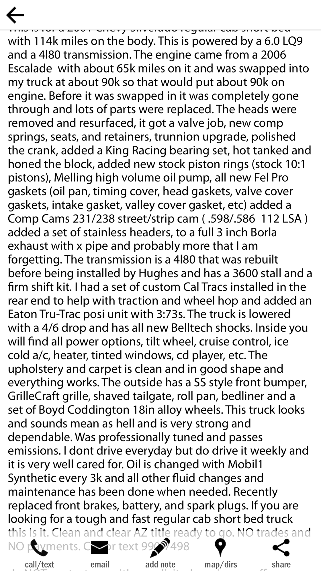

Finally found the original post of the truck the guy had.

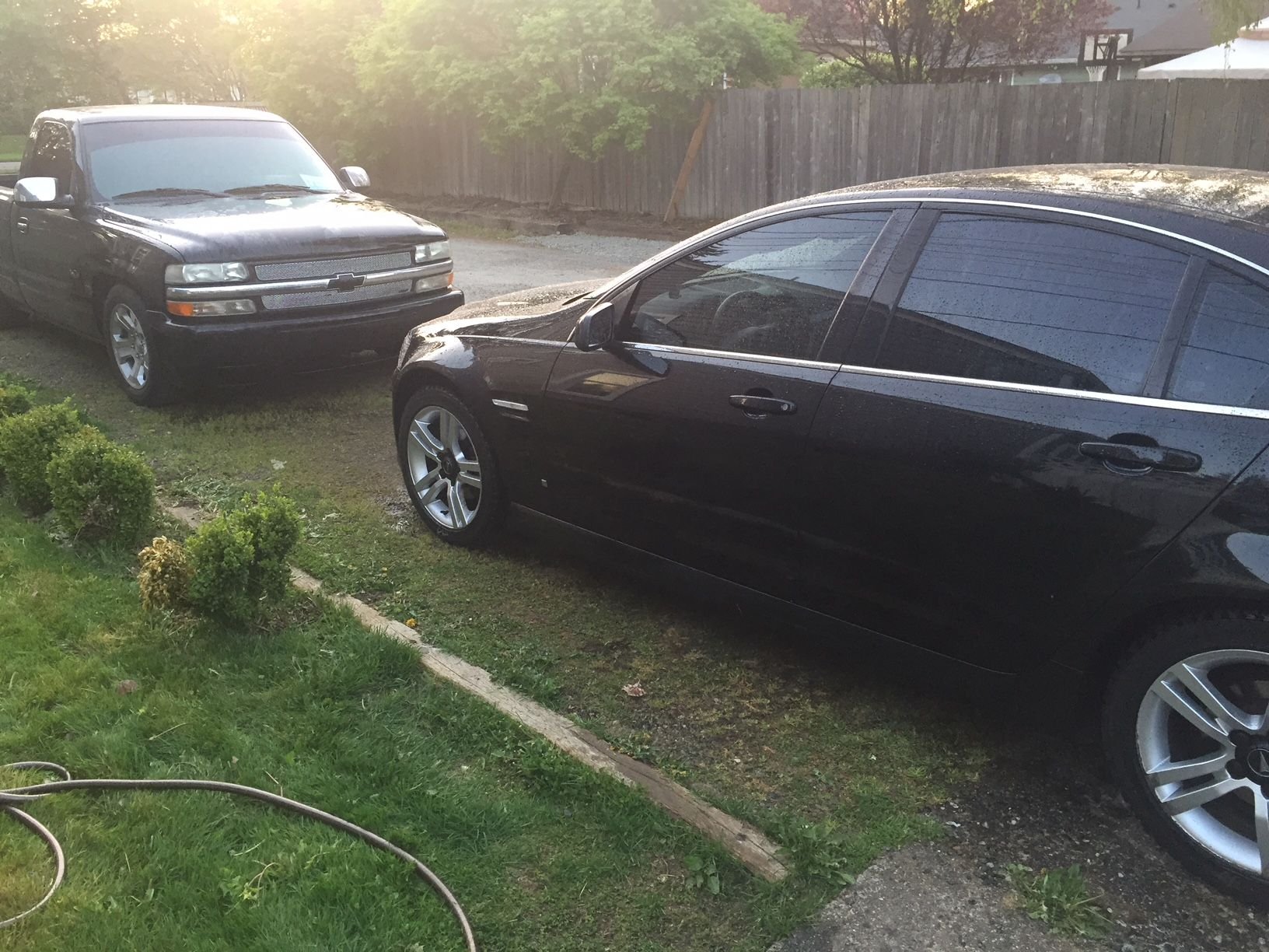

Base G8 with Silverado

she isnt ugly at least! I used to have a G8 too. Yours a GT? I had an 09.5. Kinda miss it. Mostly dont haha.

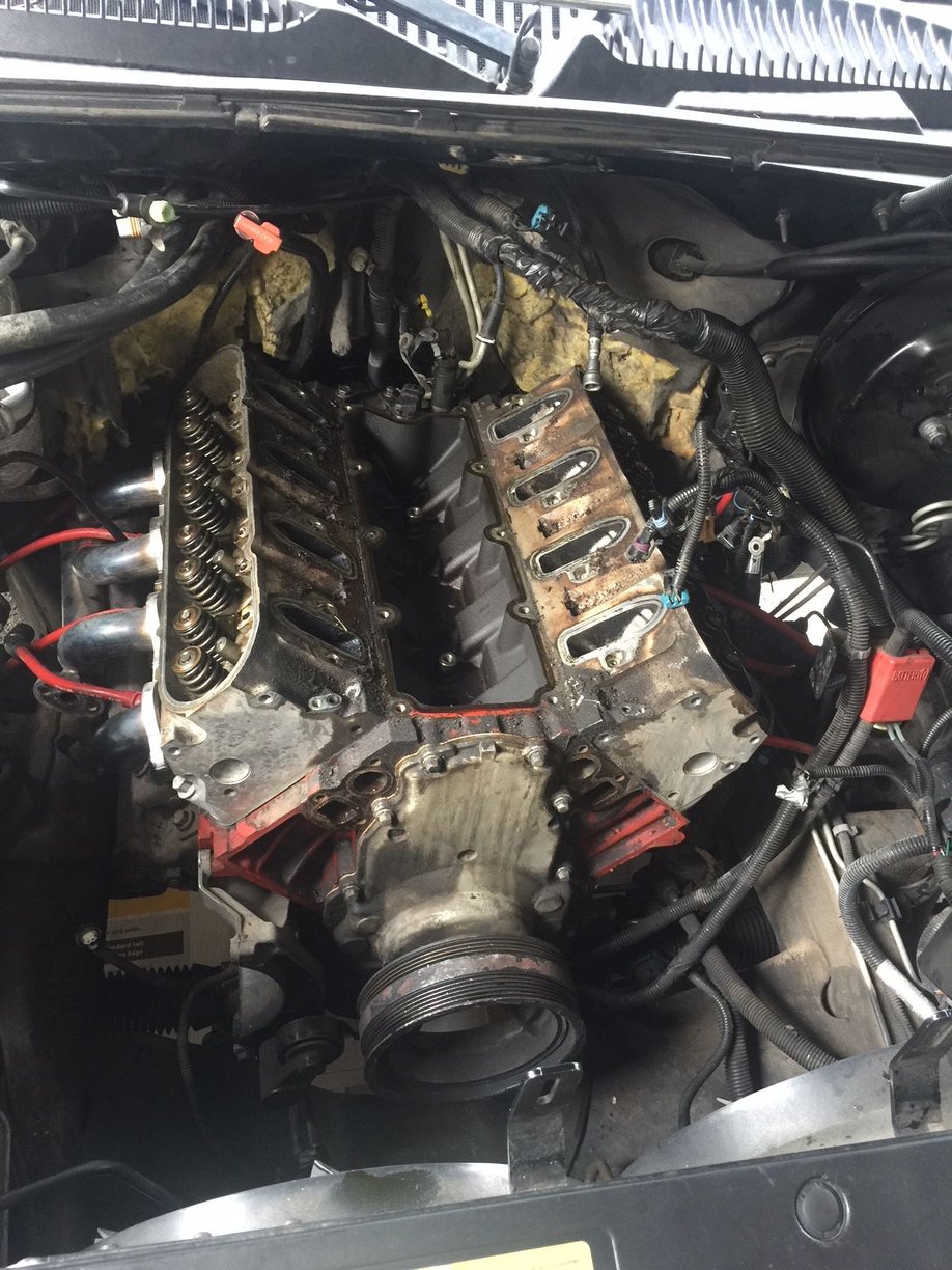

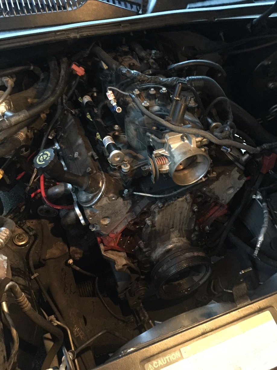

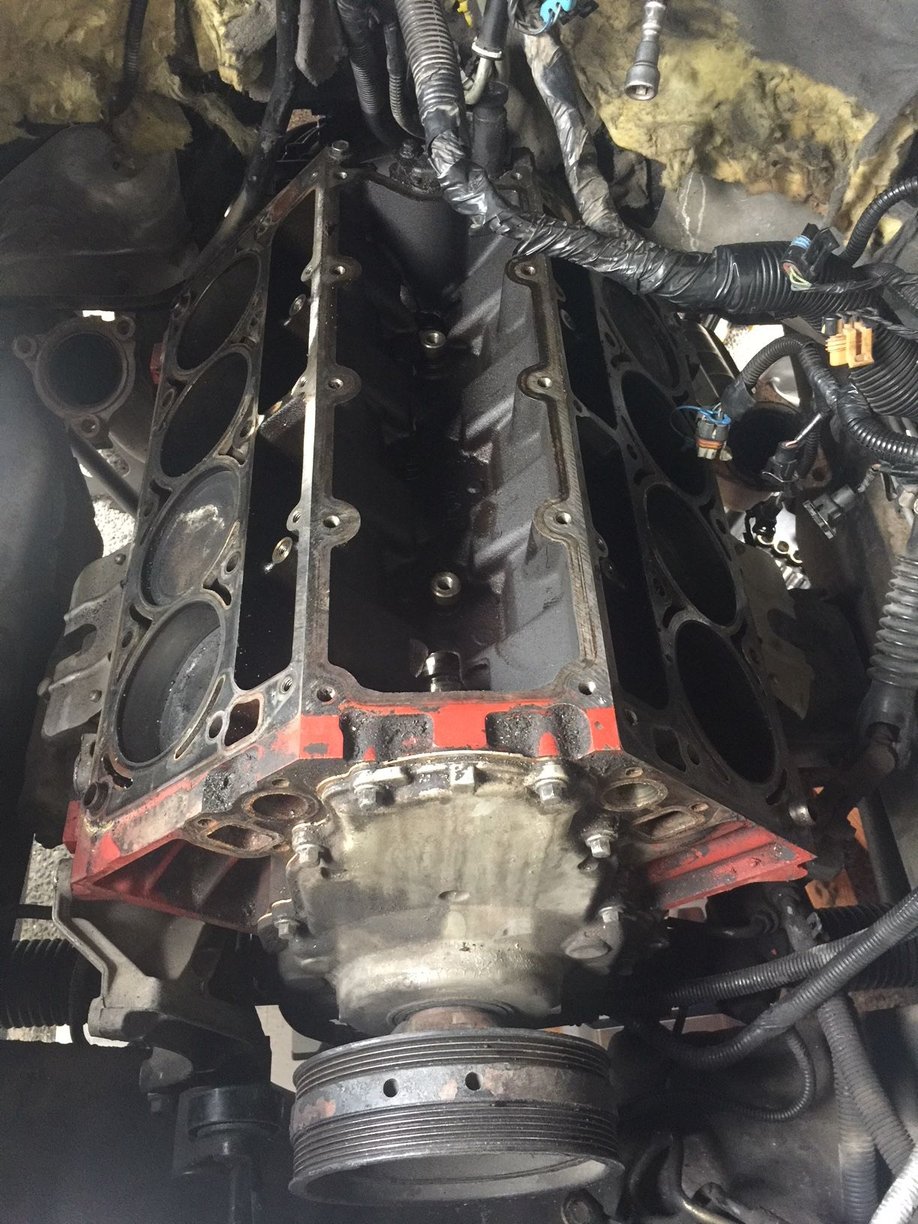

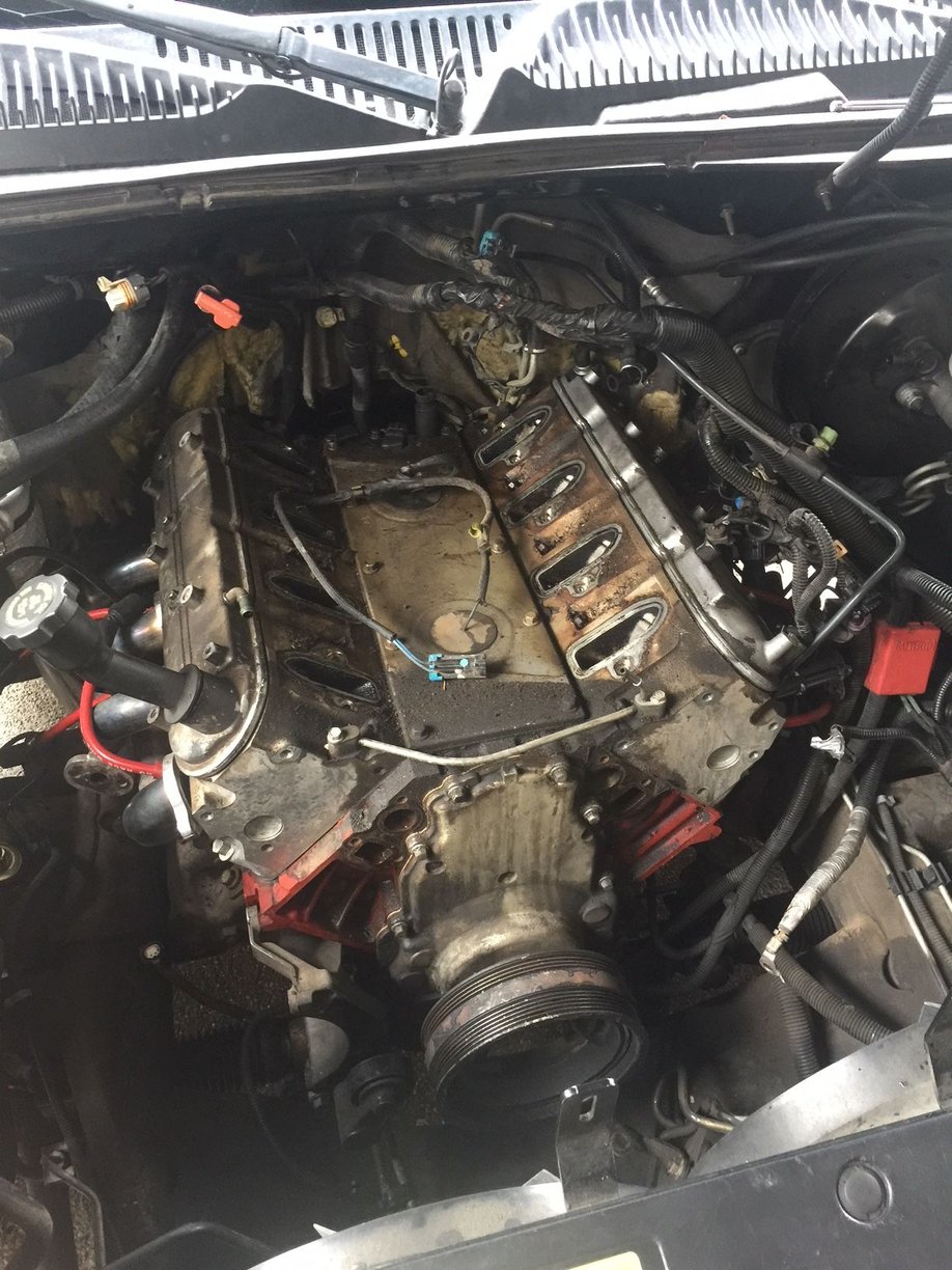

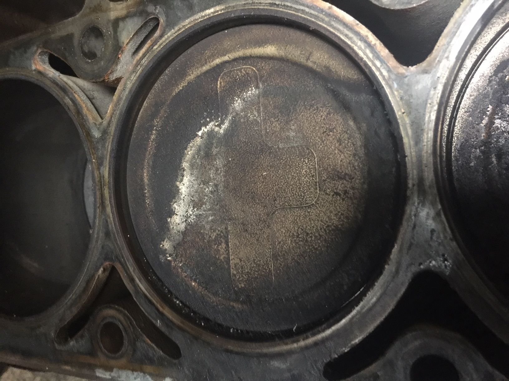

Only pictures I took of removing parts getting ready to take it out. You can see the NO2 fitting
LQ4!!!!

Yeah suckered me into buying it because it looked clean. It is a Base G8 not Base GT I had to change it in the pic.I got it for $9,000 with 38K miles. Salvage title insurance totaled it due to the floor in the trunk being cracked. I guess it falls into the category of being totaled. Runs perfect had no issues. But I see the timing cover leaking a tiny bit of oil and I am dreading changing that. It has been a good car for wifey and kids. But guess who is driving it now cause his POS truck? It has the best trim and it is a 2009.5 also.
