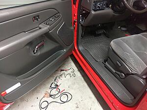

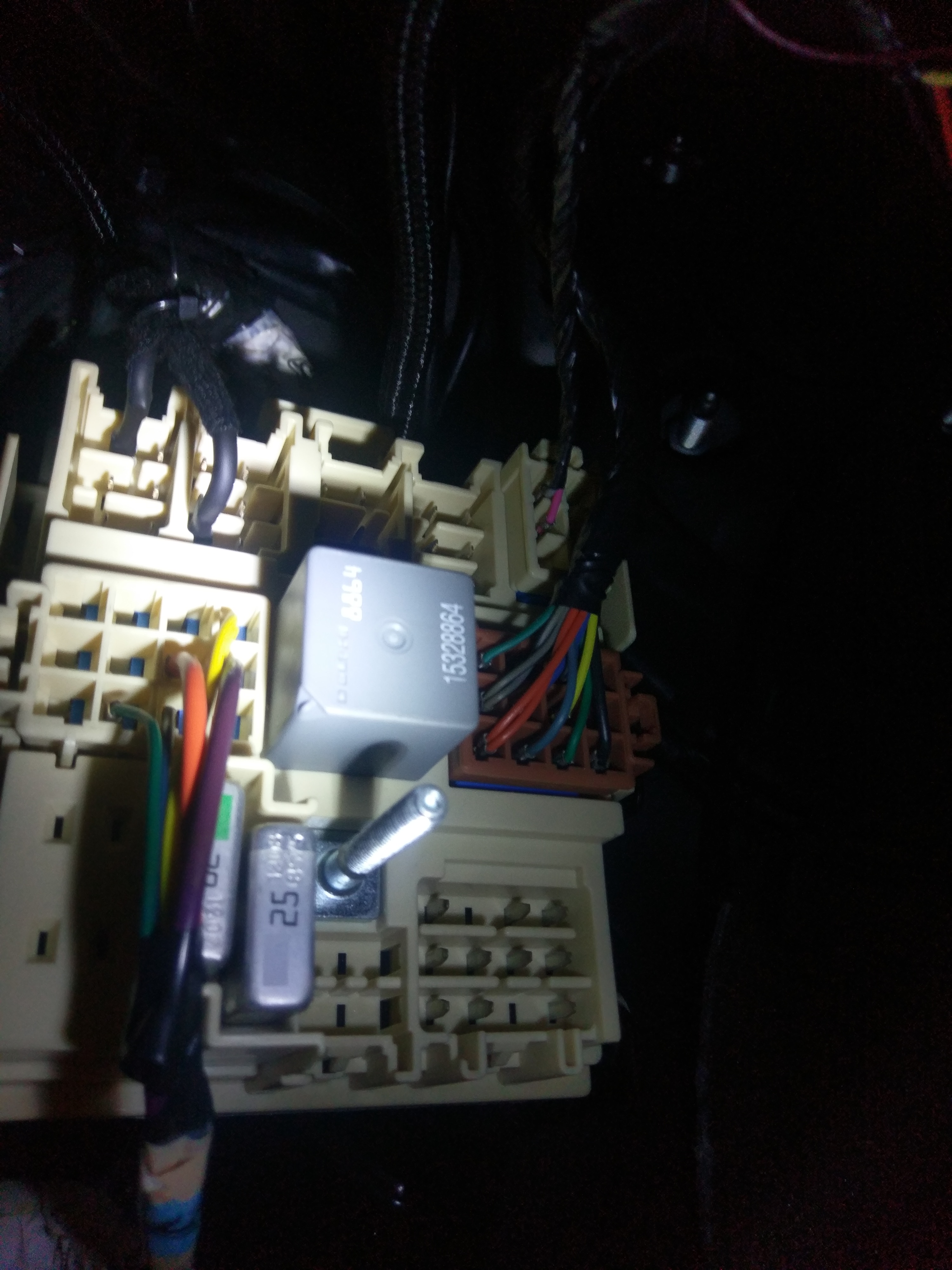

Redid the gauge wiring to the MBEC panel. Didn't like that my gauges would shut off and reboot during crank, so I found a switched 12v that stays hot during crank in the SEO plug. Also chose to use the illumination wire in the trailer brake connector just to keep it clean.
ILuvJDM's 2007 NBS RCSB Build - Turbo/4L80e/Coilovers/Wilwoods-eeppylg.jpg
You can see them top left of the panel. Top left in SEO is switched 12v, bottom left in trailer brake is illumination

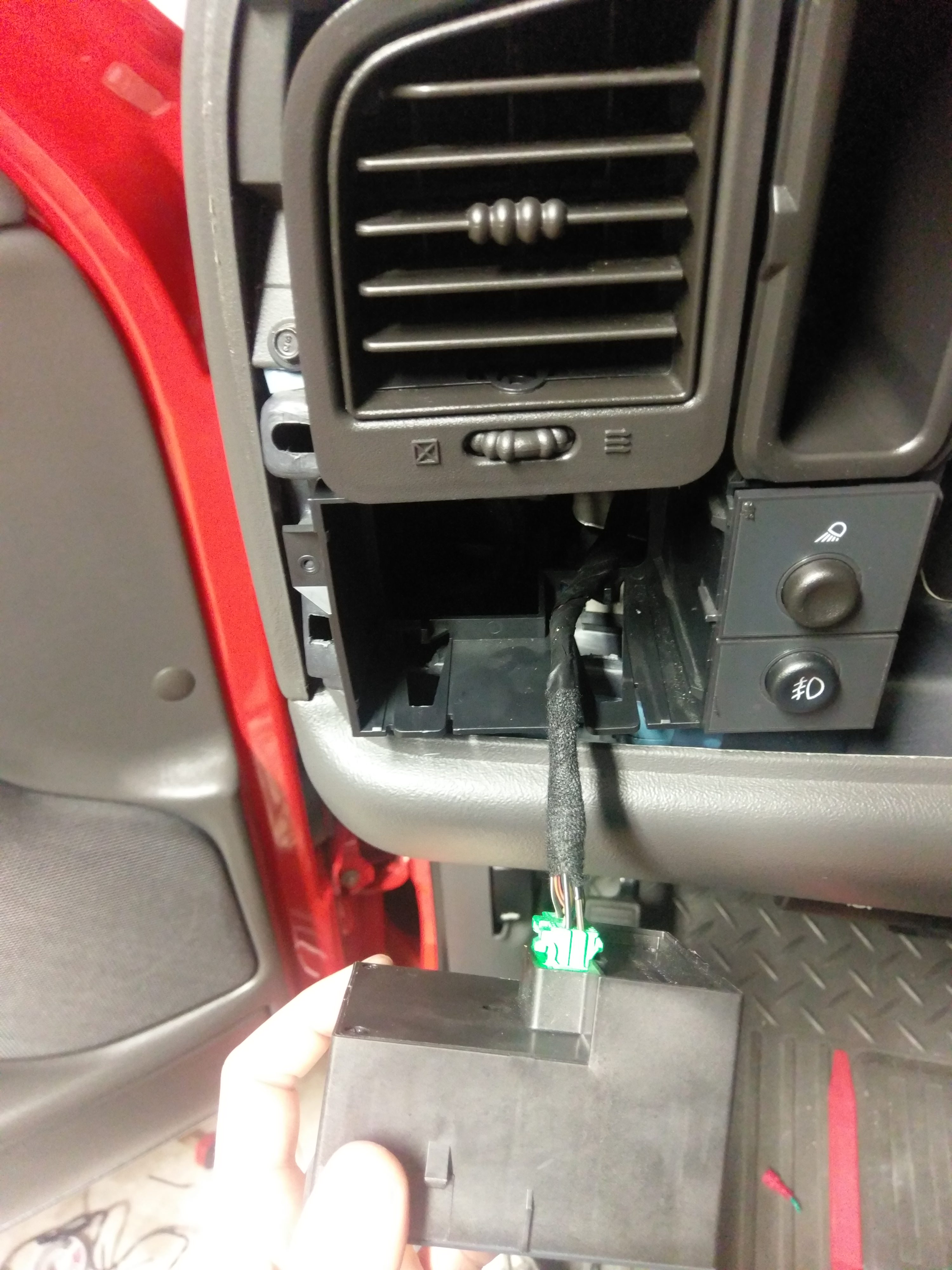

Removed the quick connector from here and got it back to looking factory

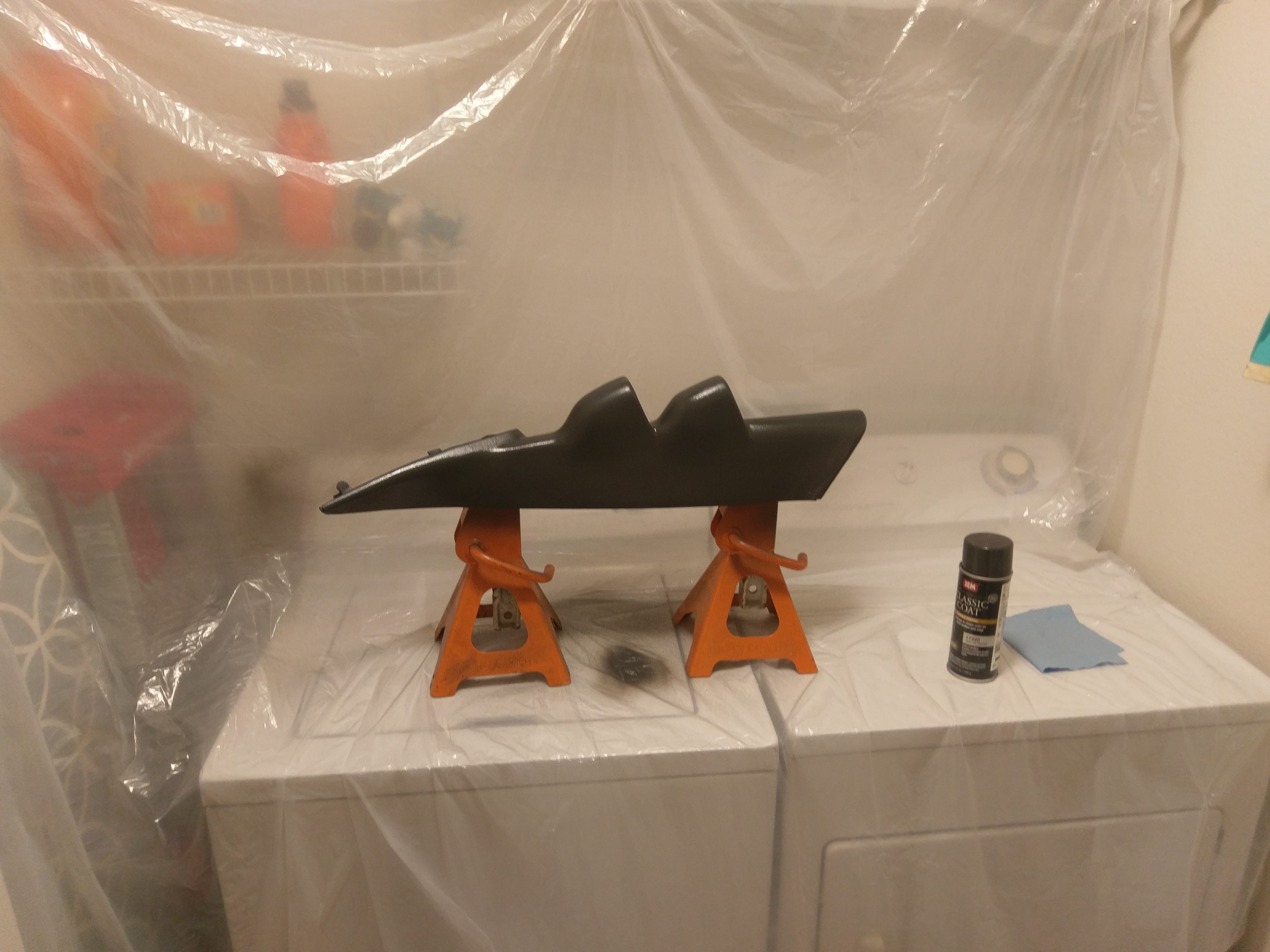

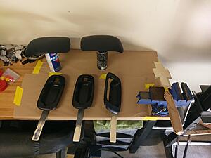

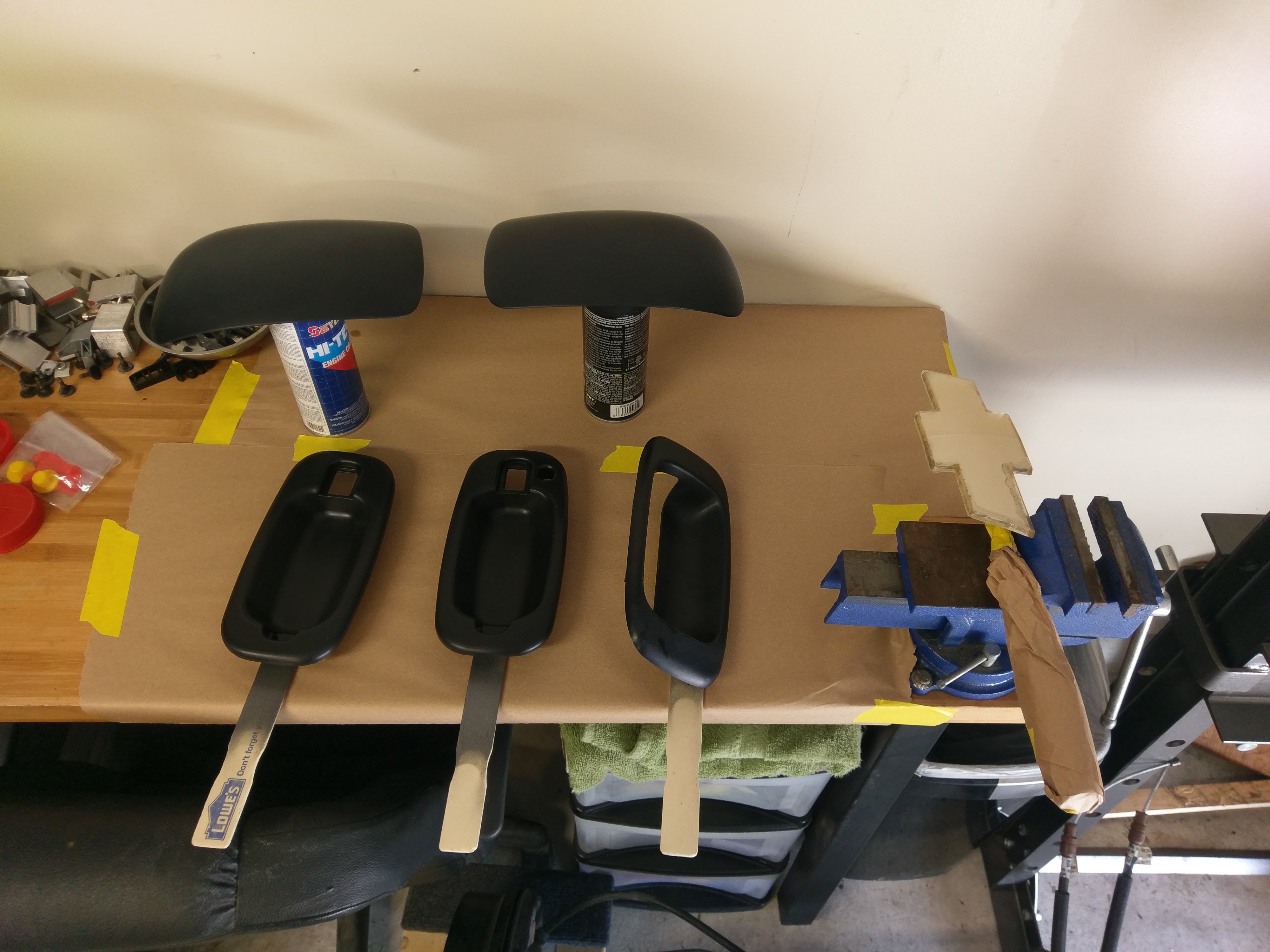

Weather sucks, so I made a paint booth in the laundry room
ILuvJDM's 2007 NBS RCSB Build - Turbo/4L80e/Coilovers/Wilwoods-np7jvqx.jpg

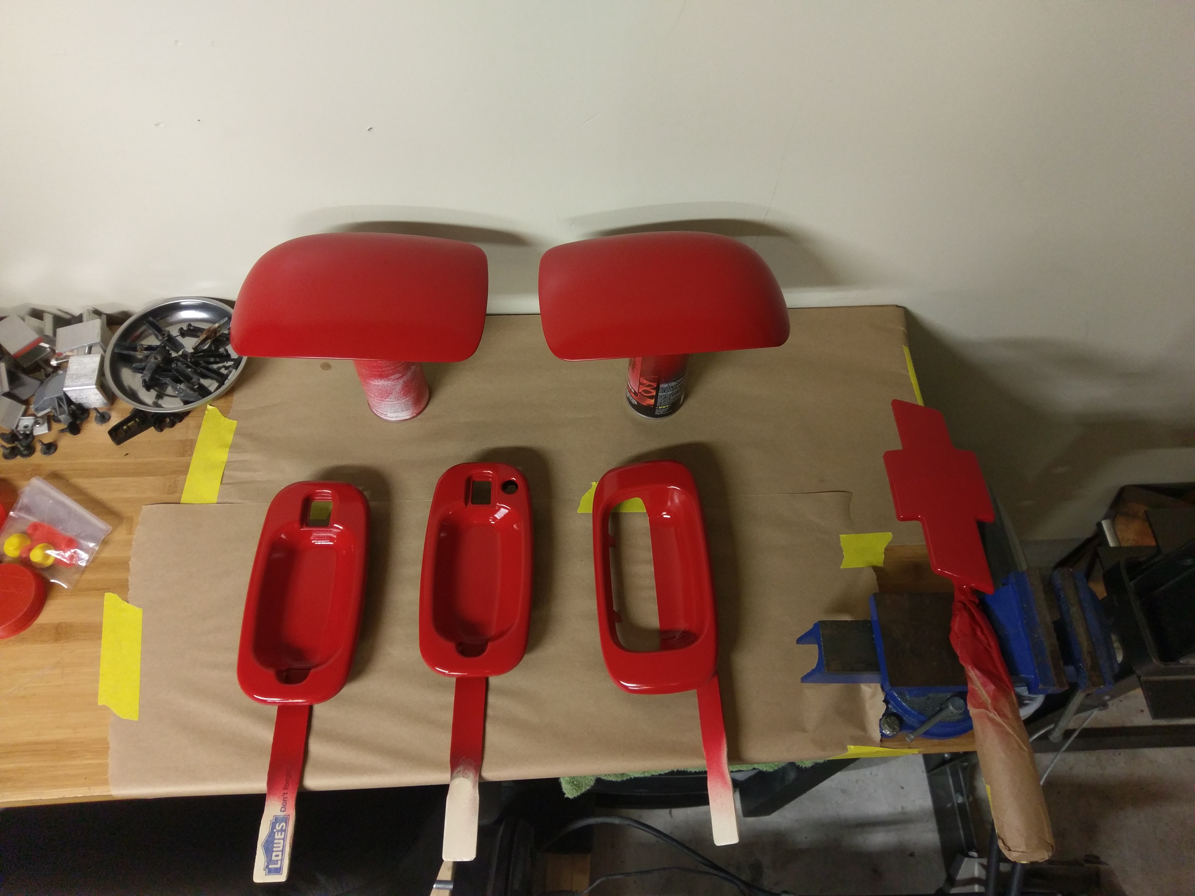

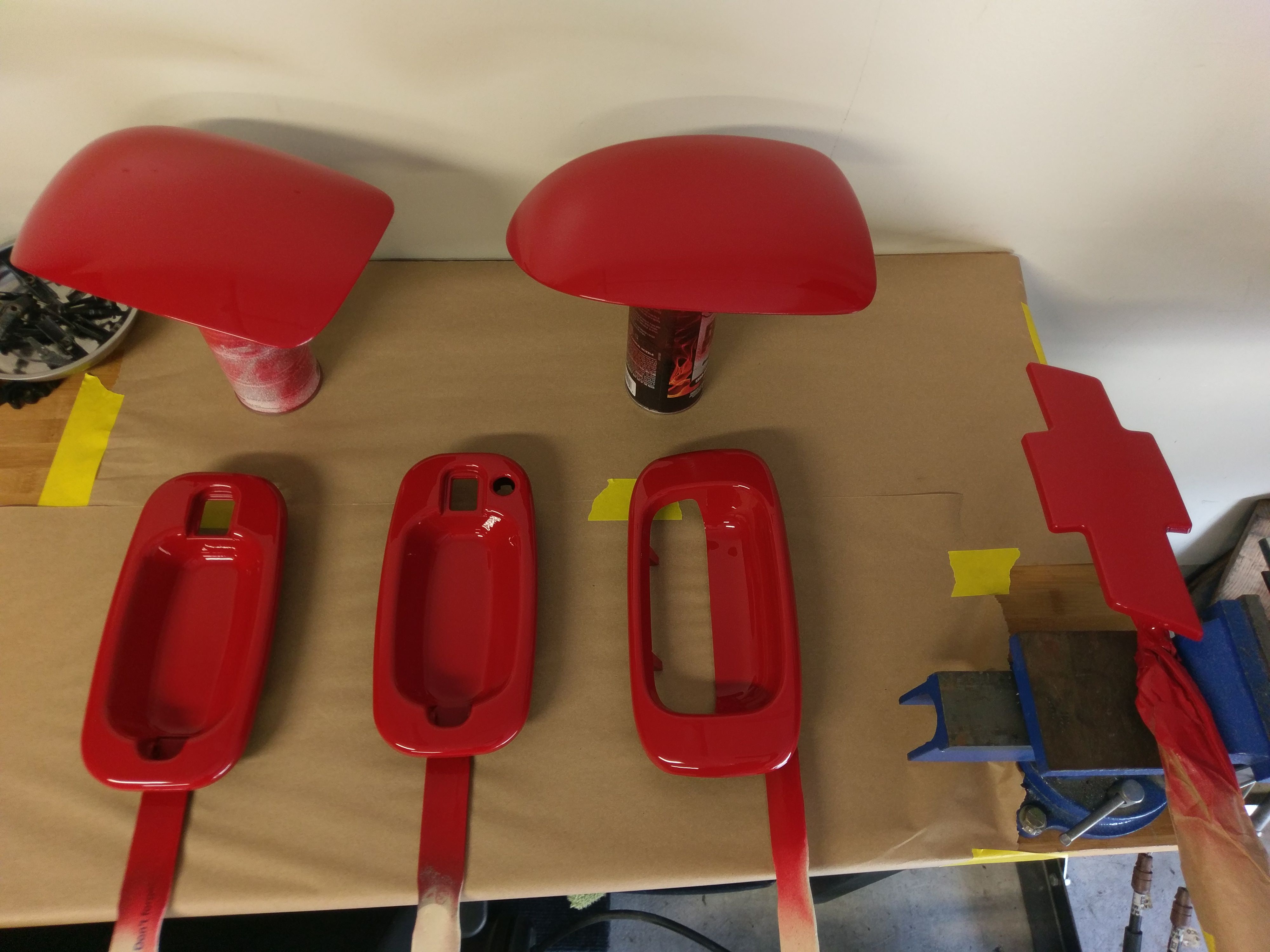

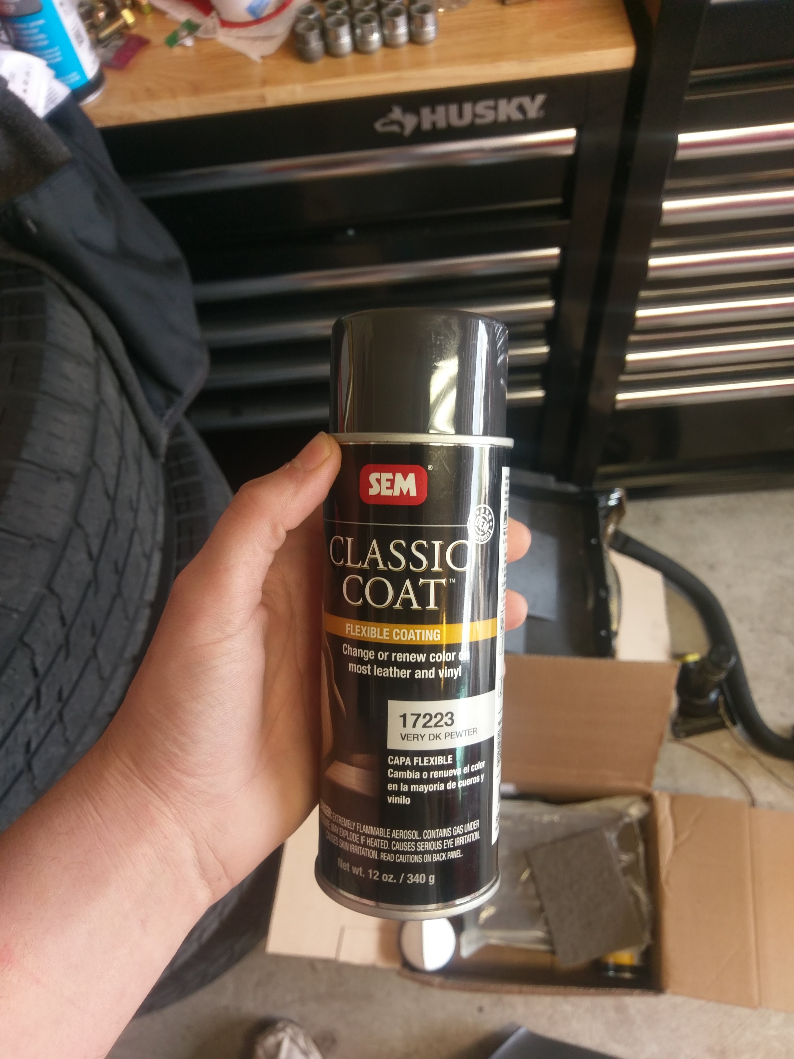

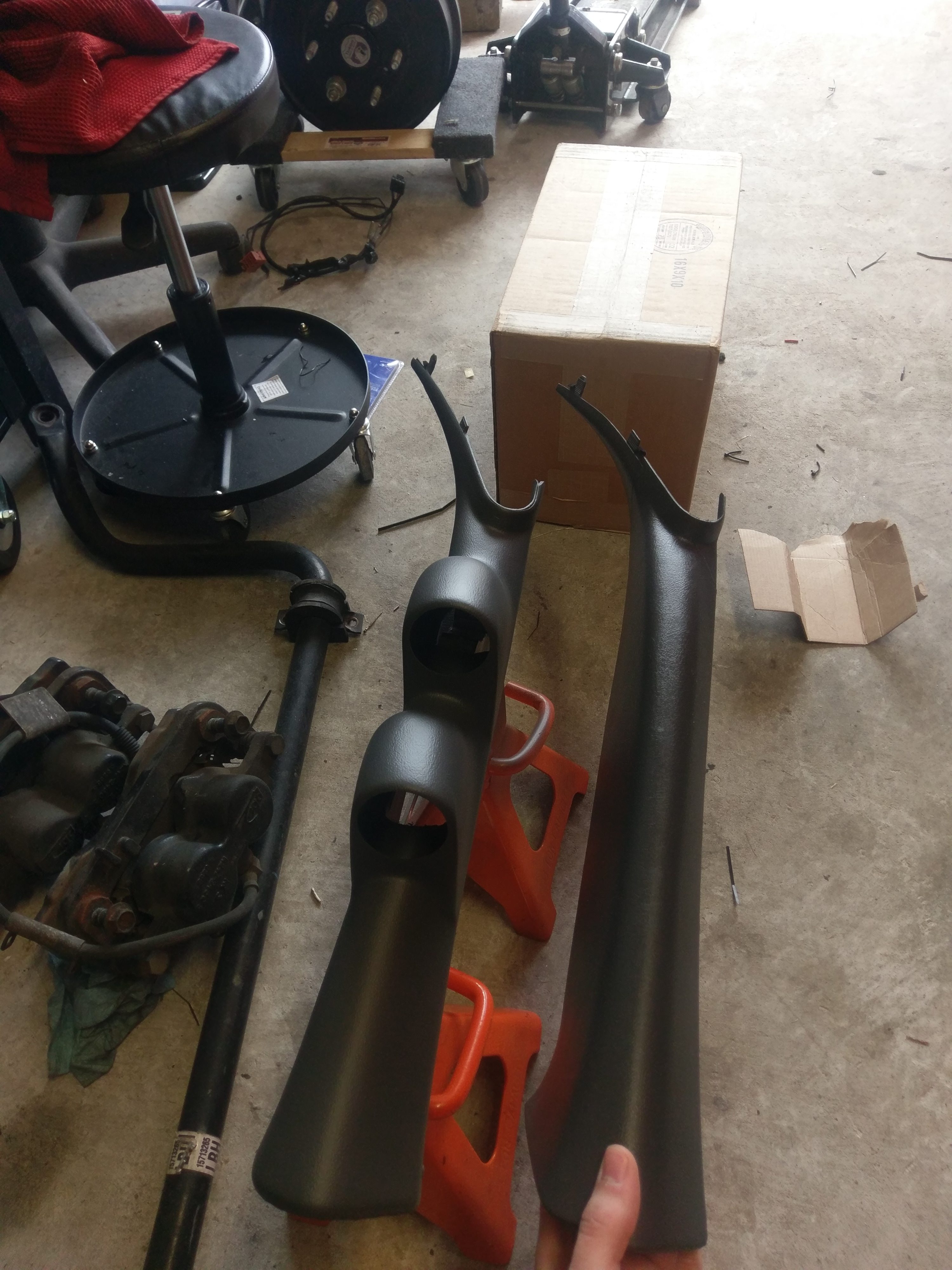

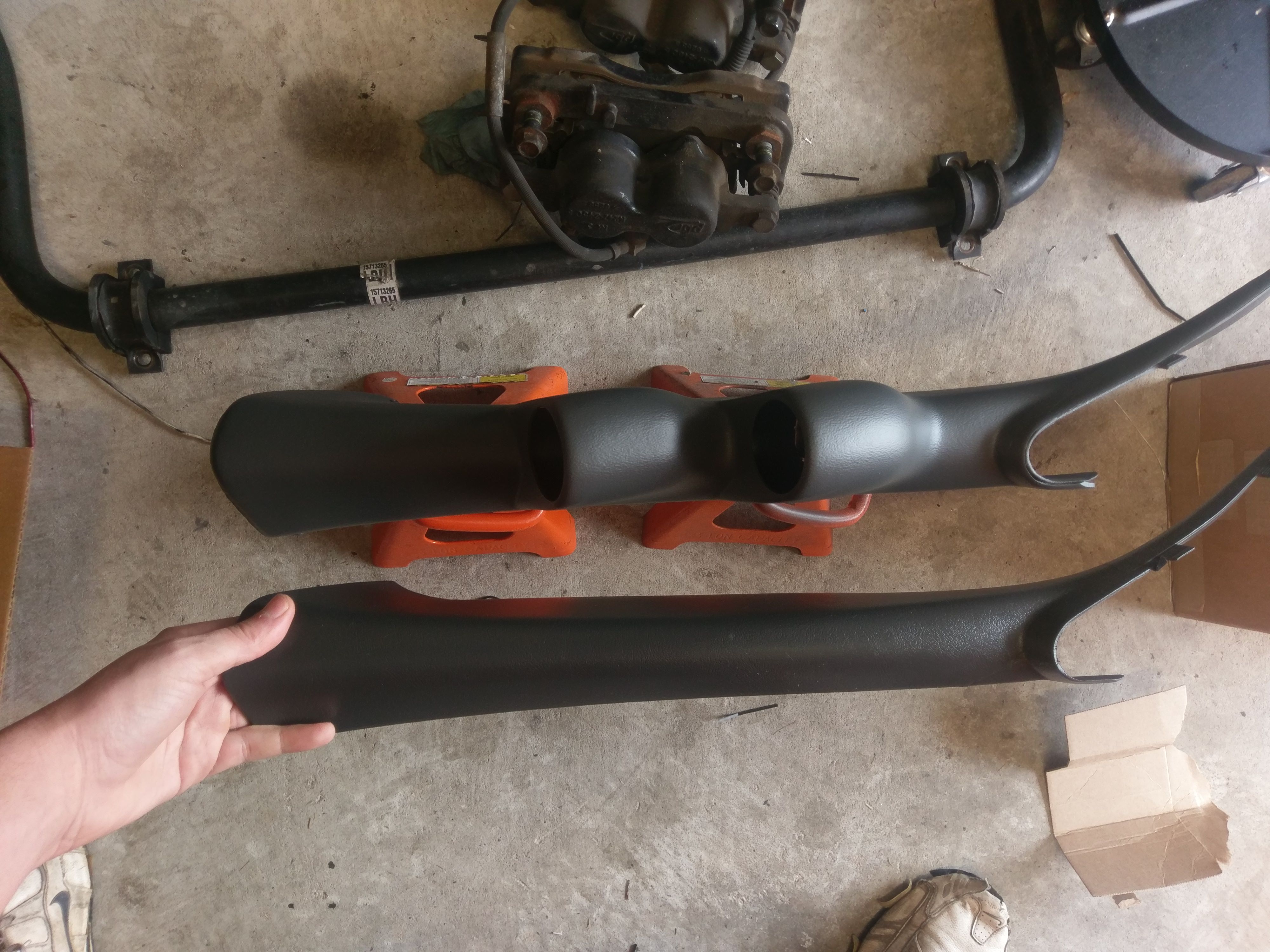

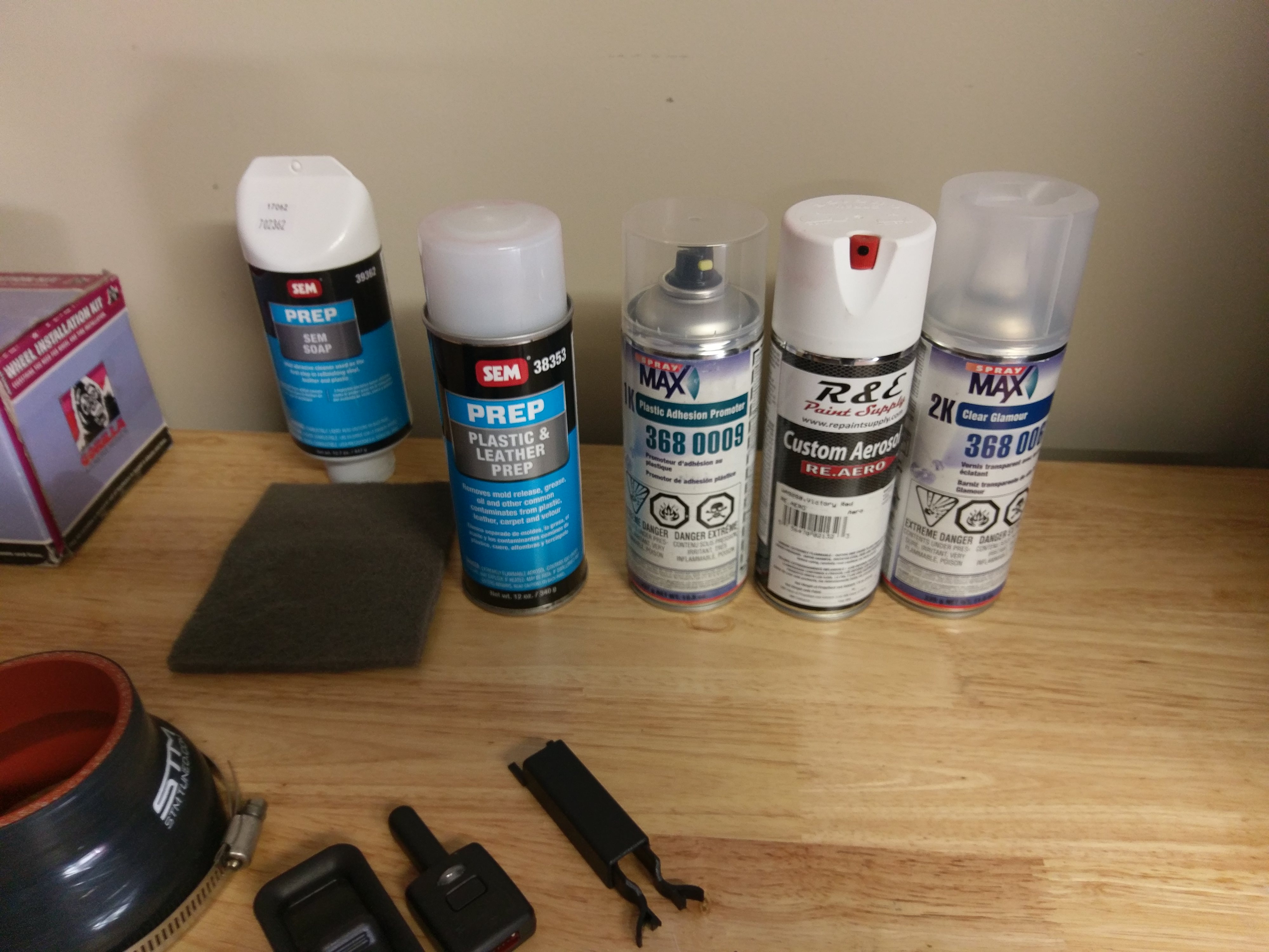

Decided to do the paint work today, I had already scuffed the parts when I painted the gauge pod earlier this week.
The products used
ILuvJDM's 2007 NBS RCSB Build - Turbo/4L80e/Coilovers/Wilwoods-hng4tkx.jpg
Cleaned and ready
ILuvJDM's 2007 NBS RCSB Build - Turbo/4L80e/Coilovers/Wilwoods-jiqu95q.jpg
3 coats of base (still wet)
ILuvJDM's 2007 NBS RCSB Build - Turbo/4L80e/Coilovers/Wilwoods-3ihqf73.jpg
3 coats of 2K clear
ILuvJDM's 2007 NBS RCSB Build - Turbo/4L80e/Coilovers/Wilwoods-hqoyxct.jpg

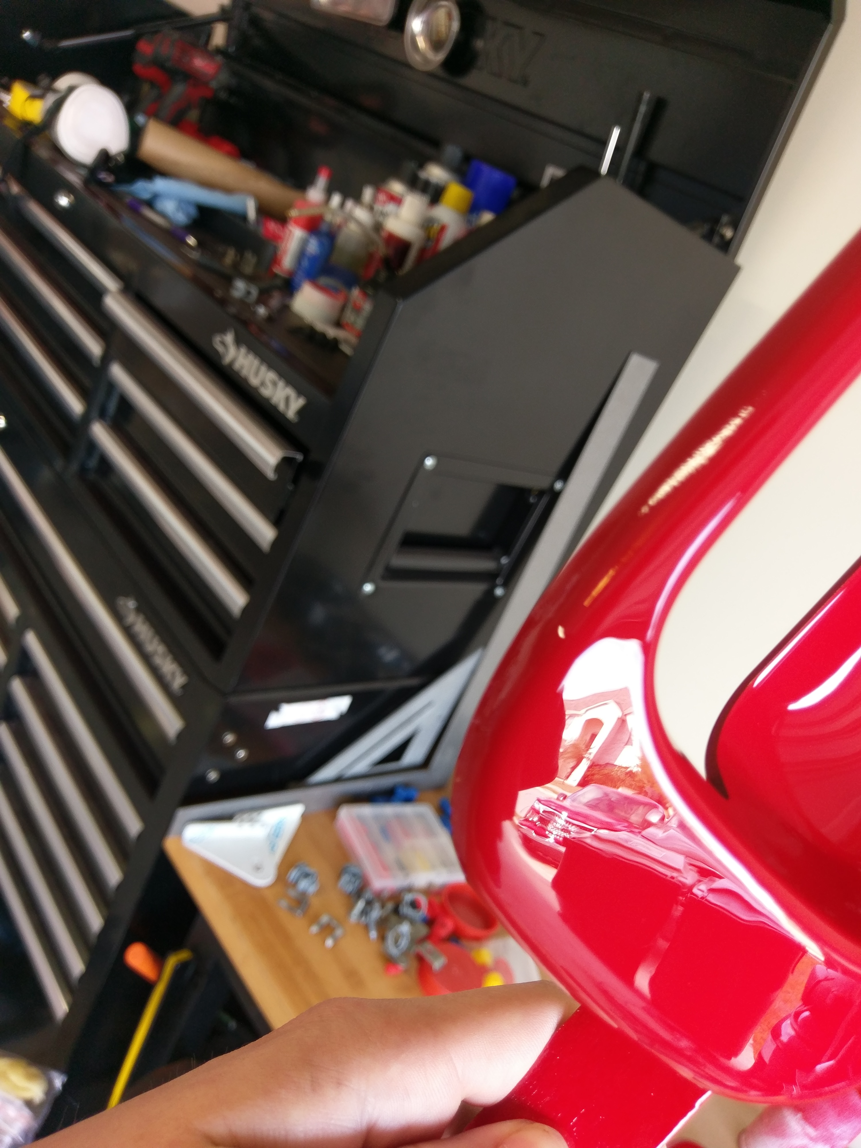

This spraymax 2K clear lays down so nice
ILuvJDM's 2007 NBS RCSB Build - Turbo/4L80e/Coilovers/Wilwoods-b9qyeao.jpg
There are some dust particles and nubs in the clear, so I will attempt to polish those out after a few days. That's to be expected when you paint in a garage with the doors open in spring time

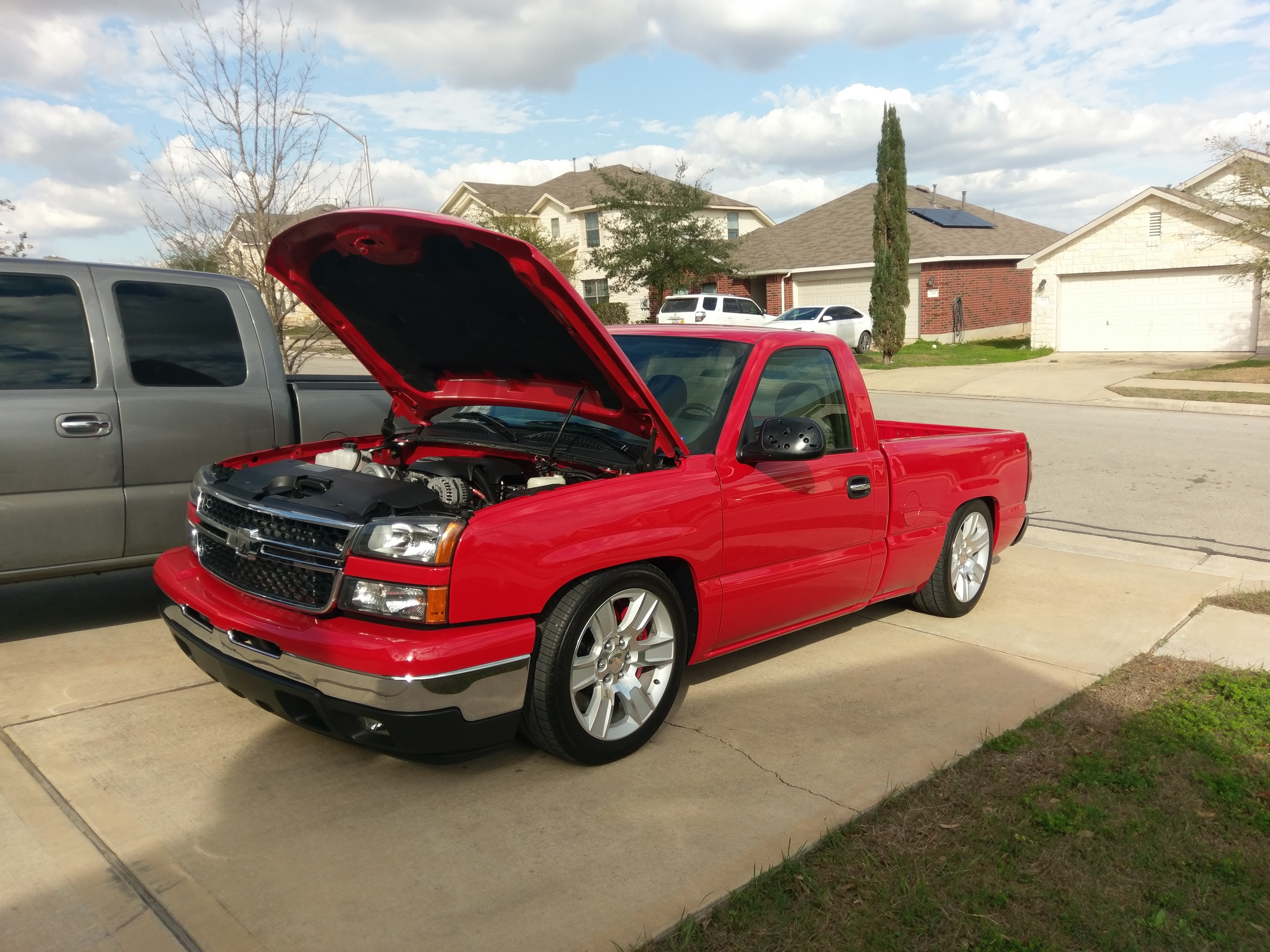

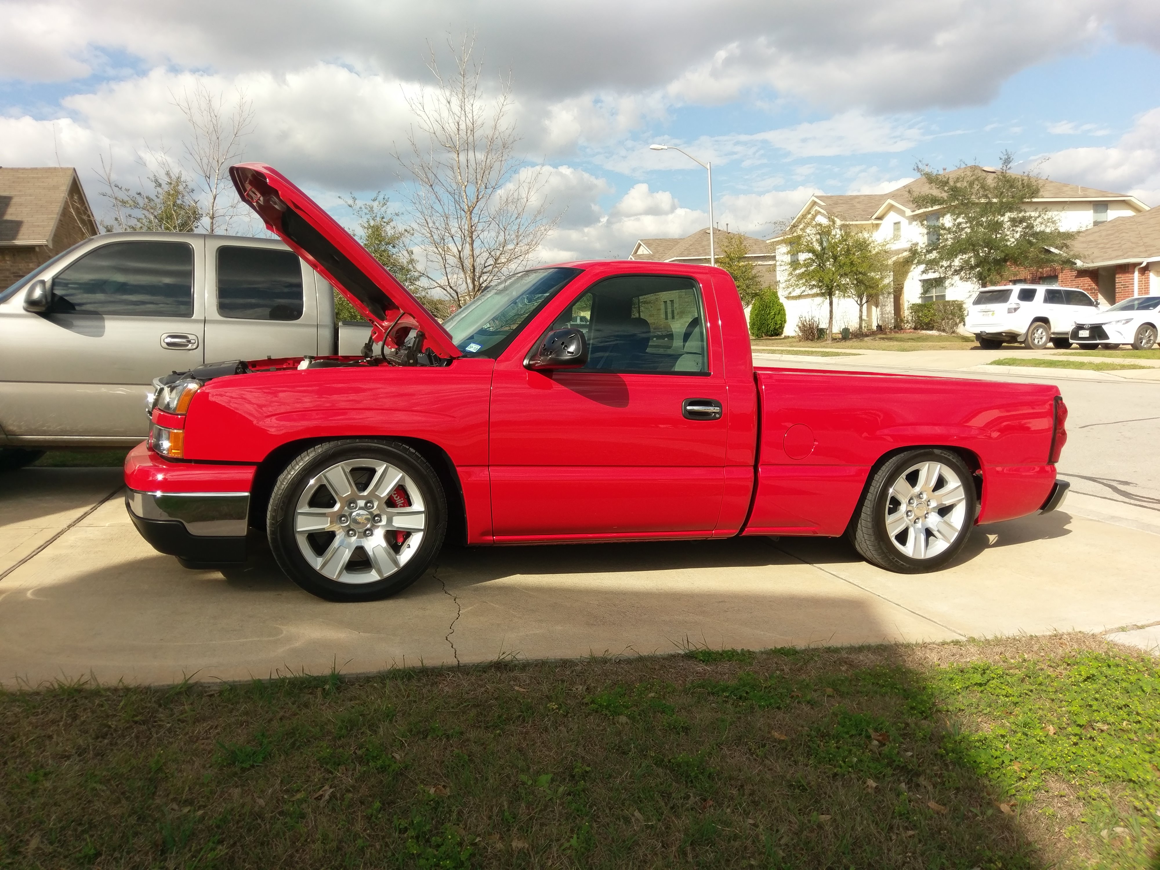

Nice and shiney out in the sun
ILuvJDM's 2007 NBS RCSB Build - Turbo/4L80e/Coilovers/Wilwoods-yc2bt1e.jpg
ILuvJDM's 2007 NBS RCSB Build - Turbo/4L80e/Coilovers/Wilwoods-ojua4cp.jpg
