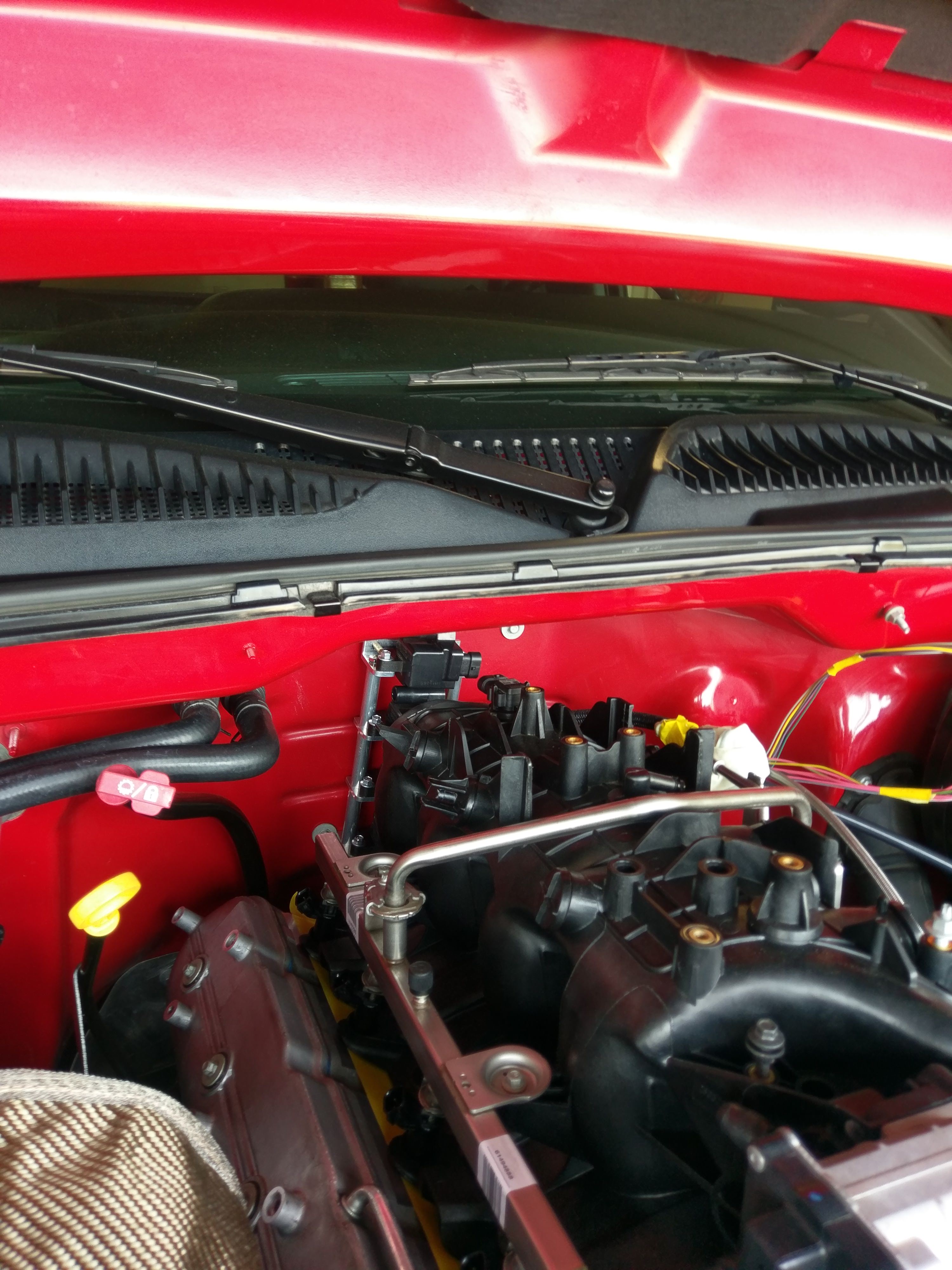

I'm looking for input on where I should mount my coils. I tried putting these thinga all around the truck and here are the three options I found:
On firewall, it is just hung on an existing Bolt, it would obviously be straight and probably lower. I would have to extend my drivers harness for sure
ILuvJDM's 2007 NBS RCSB Build - Turbo/4L80e/Coilovers/Wilwoods-kovu4g7.jpg
With stock intake manifold
ILuvJDM's 2007 NBS RCSB Build - Turbo/4L80e/Coilovers/Wilwoods-ztwloka.jpg

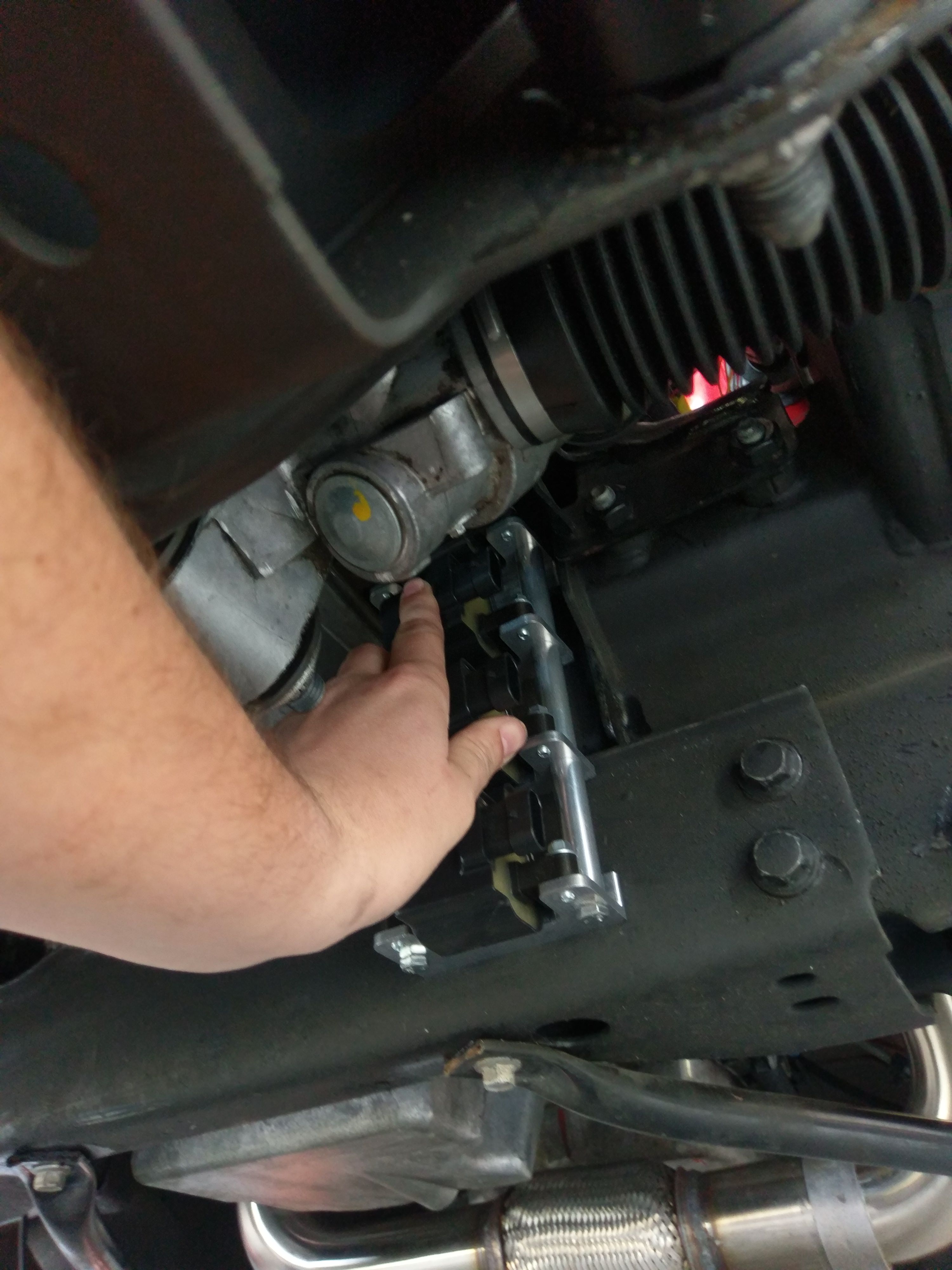

Option 2:
Down under the oil pan. I would probably build a small aluminum shield for rocks and stuff. I can also get this one a bit higher by just using the bottom bolt holes and having it above that lip.
ILuvJDM's 2007 NBS RCSB Build - Turbo/4L80e/Coilovers/Wilwoods-y3ykkqe.jpg

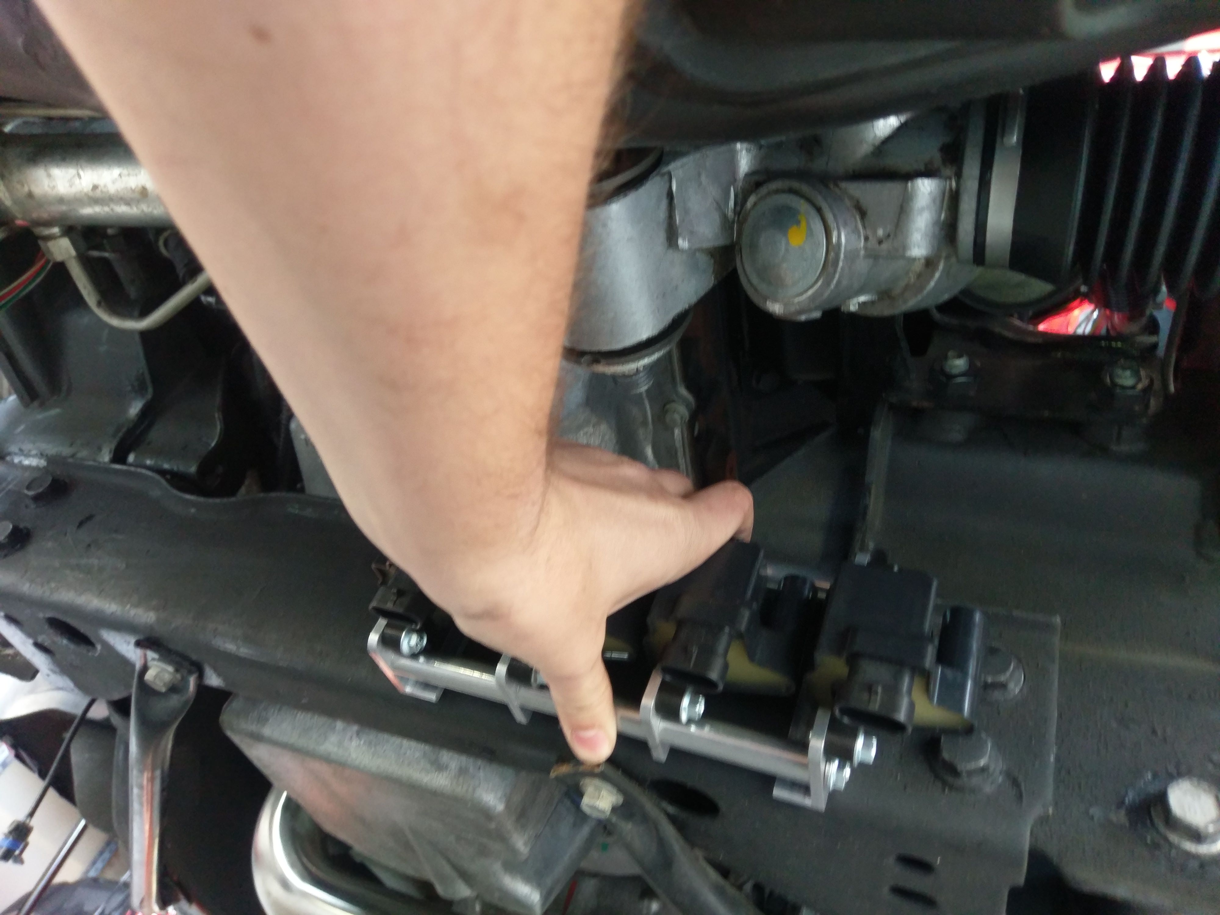

Option 3:
Down low again, but vertical so there is less exposure to road debris. Would still make a plate to protect it.
ILuvJDM's 2007 NBS RCSB Build - Turbo/4L80e/Coilovers/Wilwoods-ebo0xwr.jpg

Think about how long the plug wires will be

Whats wrong with mounting them on the valve covers?

no mounting bosses for coils, plus that's the point of doing a wire tuck.... Plenty of very high horsepower cars and trucks have coils in their cowls or even fenders. Plug wire length is not a concern at any of these locations

I like them down low horizontal. I'm assuming you won't be driving it in the rain much.

My plug wires ended up being about 36".
Most aftermarket 8mm wire is 150ohms/ft at worst. The stock wires are like 900ohms/ft. So a 6ft generic aftermarket wire is about equal to a stock wire.
