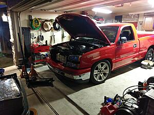

Finally got the truck down on 4 tires for the first time in months. I was worried it wouldn't get low enough with the springs I had, but it's at 14.25" hub to fender and actually tucking tire. I need to raise it up, but this was just a temporary bolt in of them to make sure they would work.
ILuvJDM's 2007 NBS RCSB Build - Turbo/4L80e/Coilovers/Wilwoods-ozi7txc.jpg
I also need to figure out why my heim tie rod ends are so far out of range. Is there a difference between lengths of the inner tie rods between rack and pinion and recirculating ball steerings? I had these made for my torsion bar truck and they worked great, but these barely catch a few threads when adjusting the toe out. You can see how much toe in is in the picture, that's where the tie rod ends feel safe to me with thread engagement. Anything further and I feel like its a death trap...
Steering wheel is straight ahead in this picture:
ILuvJDM's 2007 NBS RCSB Build - Turbo/4L80e/Coilovers/Wilwoods-gkktobm.jpg
