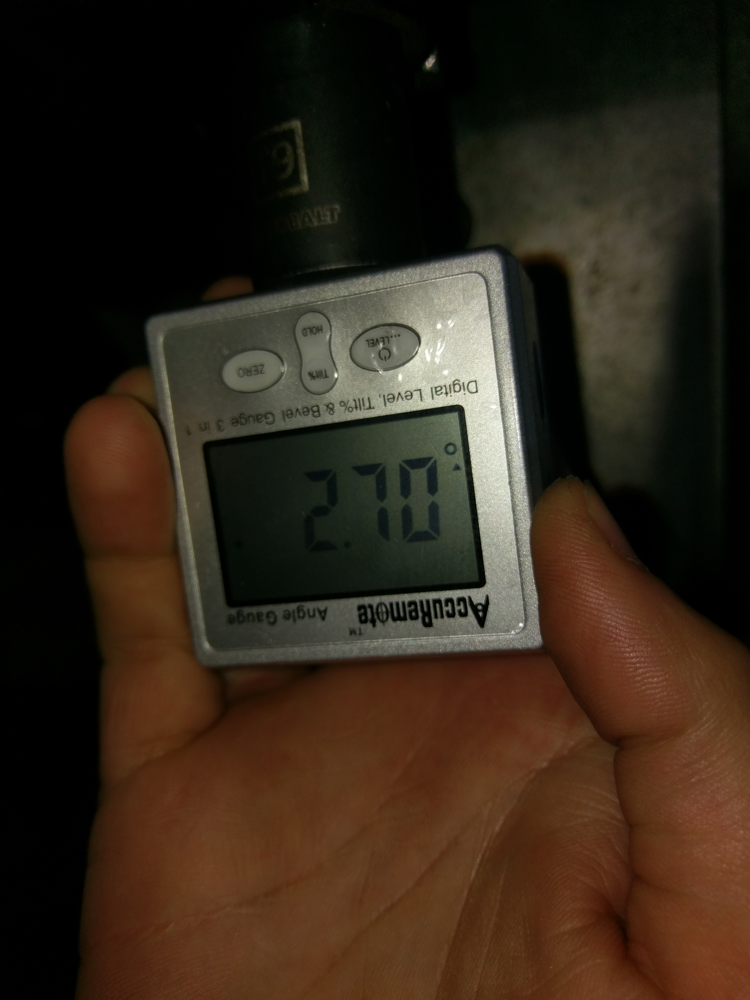

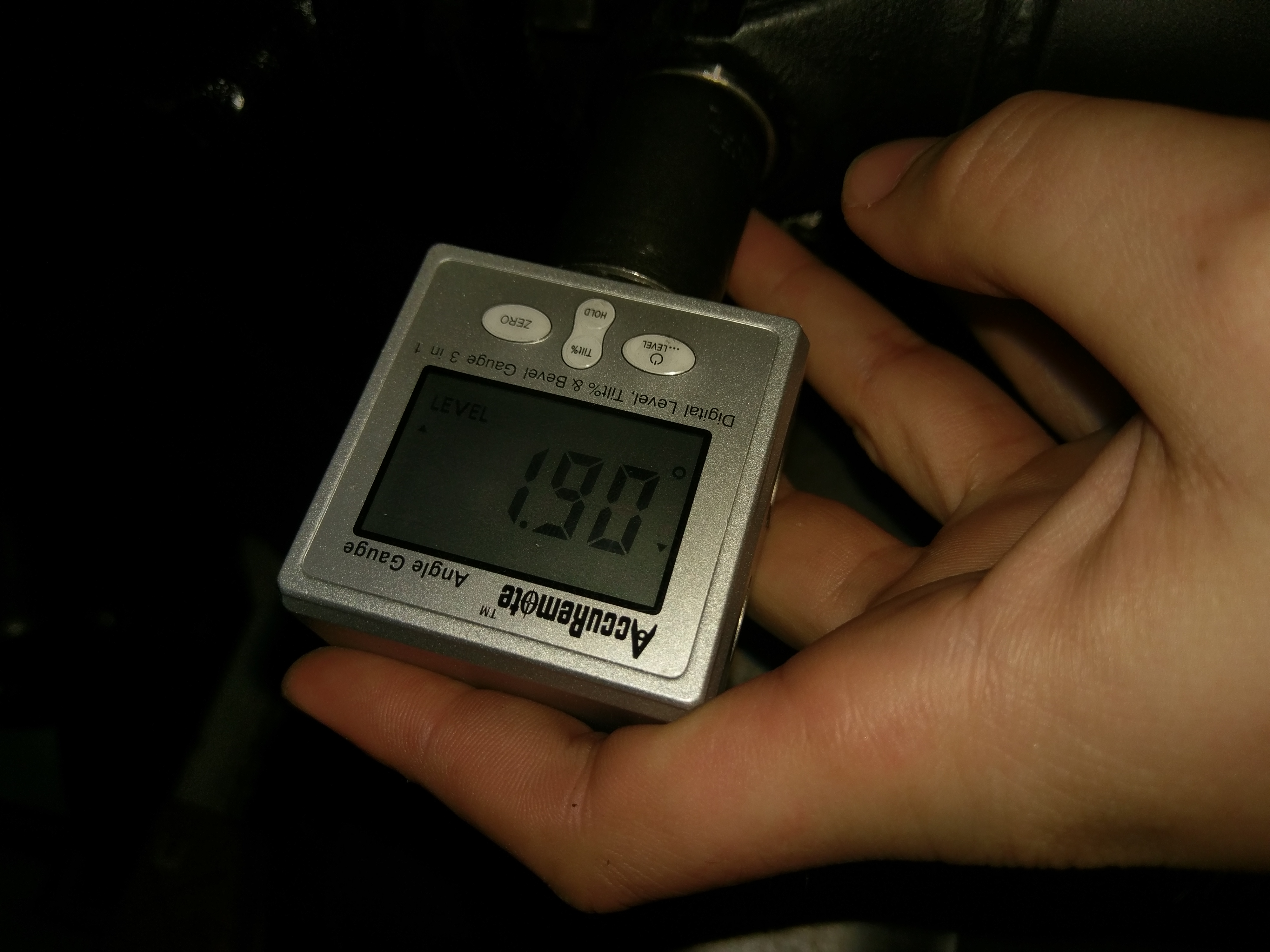

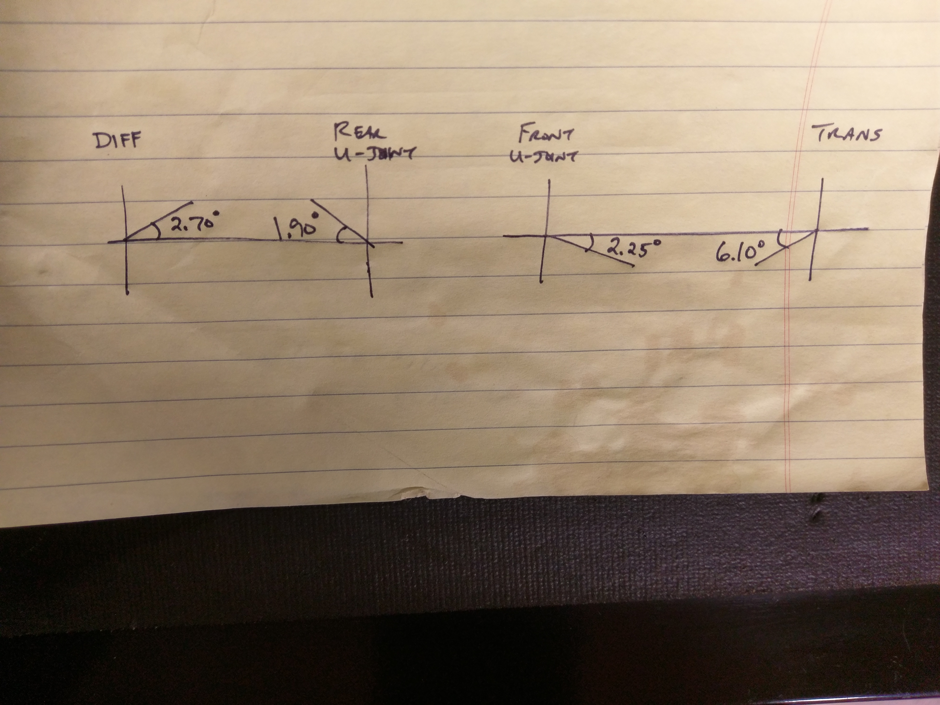

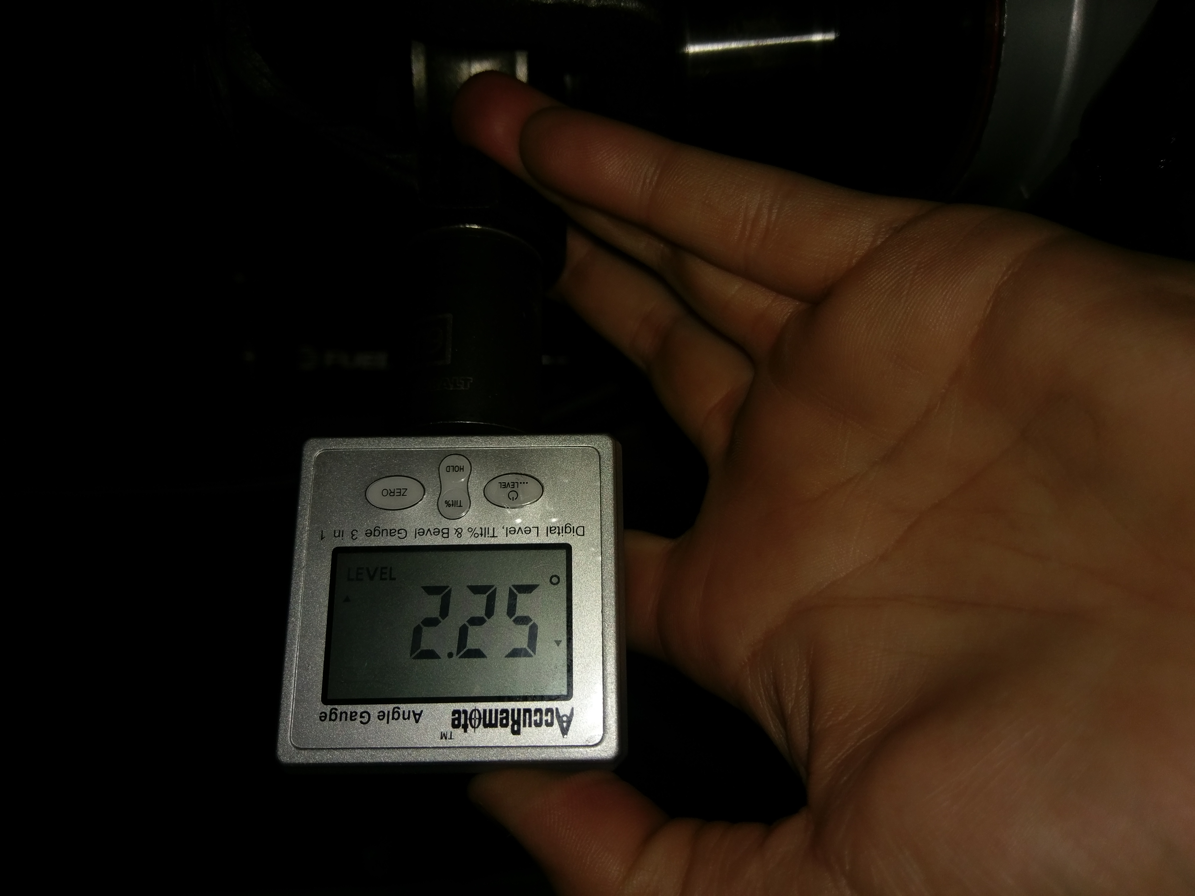

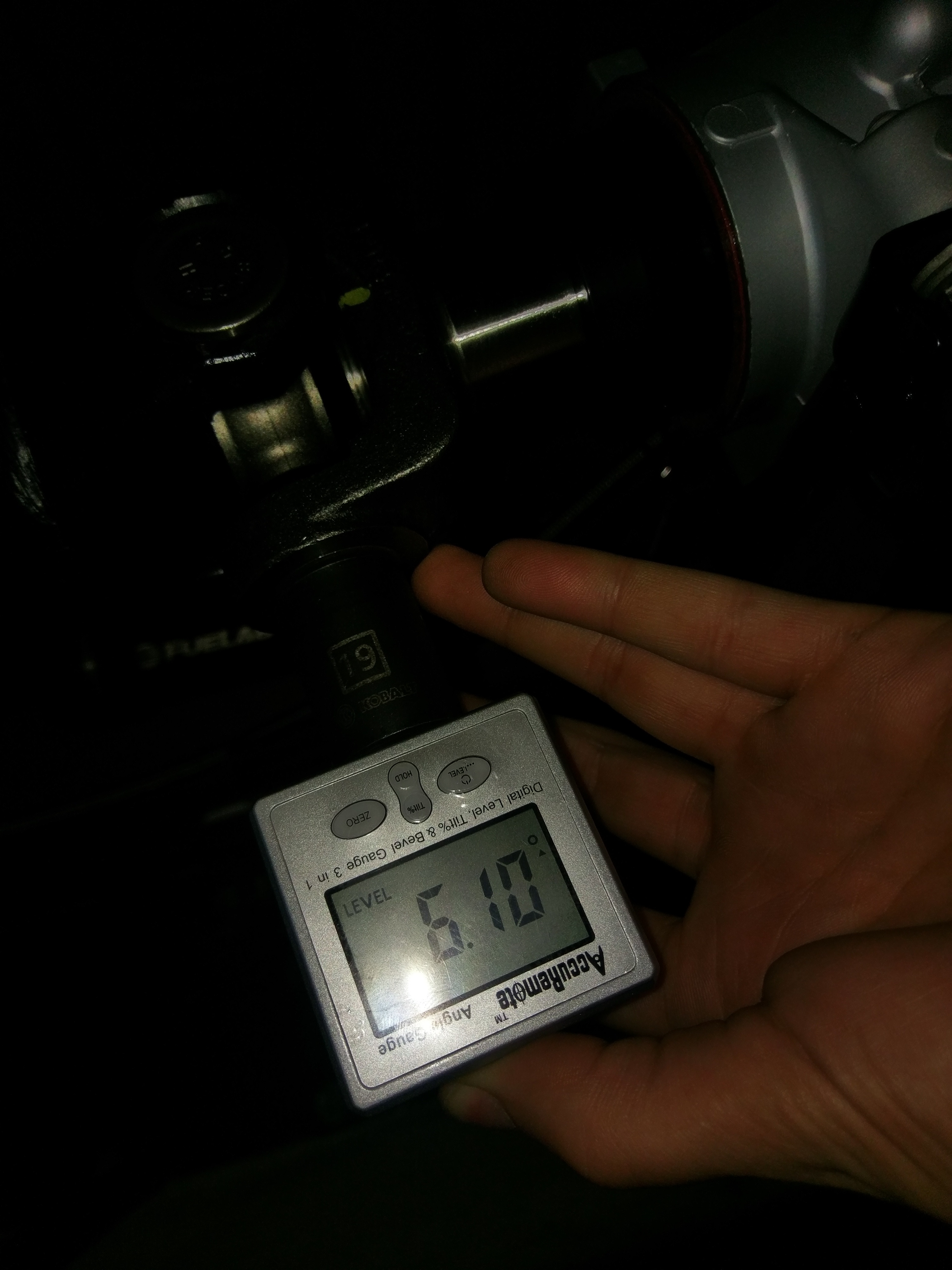

Here are my driveline angles on the truck. I'm trying to determine the operating angles of the u joints. Am I correct that I add both angles together to get the operating angles in the drawing below?
ILuvJDM's 2007 NBS RCSB Build - Turbo/4L80e/Coilovers/Wilwoods-0hpsabx.jpg
So I would have 4.60° rear operating angle and 8.35° front?
Rear Diff:
ILuvJDM's 2007 NBS RCSB Build - Turbo/4L80e/Coilovers/Wilwoods-8vd3prv.jpg
Rear U-Joint
ILuvJDM's 2007 NBS RCSB Build - Turbo/4L80e/Coilovers/Wilwoods-praie1i.jpg
Front U-Joint
ILuvJDM's 2007 NBS RCSB Build - Turbo/4L80e/Coilovers/Wilwoods-qfwpsgs.jpg
Tranny
ILuvJDM's 2007 NBS RCSB Build - Turbo/4L80e/Coilovers/Wilwoods-et6xmyu.jpg

Based on the direction the gauge says it is reading for each angle, you are correct.
An easy way to take the human error out of it is to put it on the diff, press the zero button (it will now read 0°), now put it on the driveshaft and it will find the difference (operating angle) between the two.
Old Dec 27, 2019 | 08:19 PM
  #529
ILuvJDM's Avatar
Joined: Feb 2007
Posts: 954
Likes: 59
From: Austin, TX
Man, that's brilliant, I can't believe I didn't think of that. I just zeroed it out on a level to make sure it was reading accurately and that never crossed my mind...
For now I'm going to shim the trans mount and then remeasure until I get them equal or within 1°

i think up to 3* difference is acceptable, last truck i had a drive line vibration had to shim the diff and trans to get rid of it and i want to say i got it to 2* difference and got rid of it
