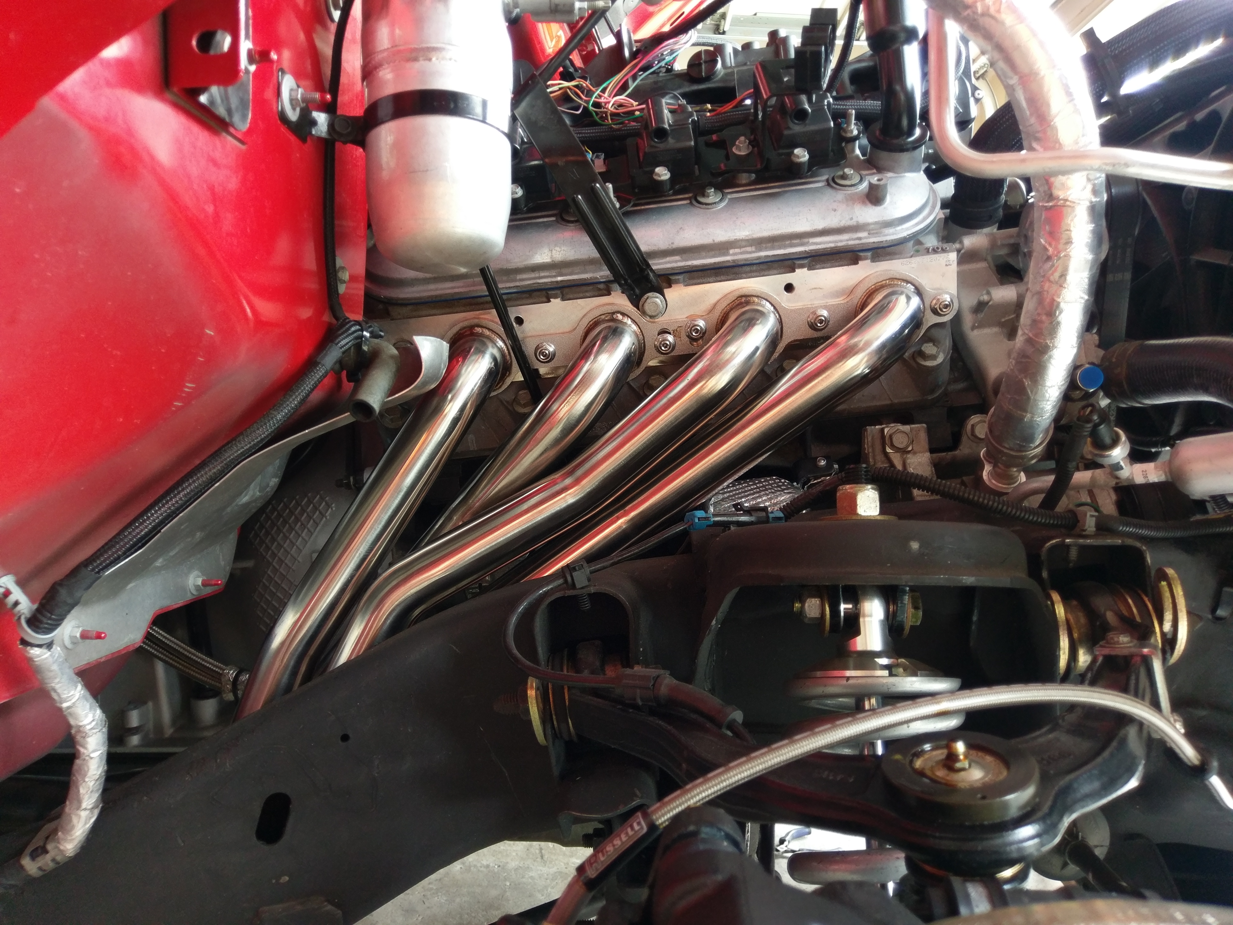

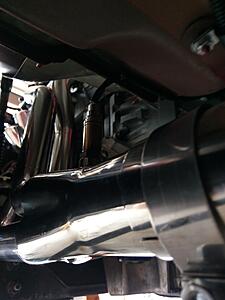

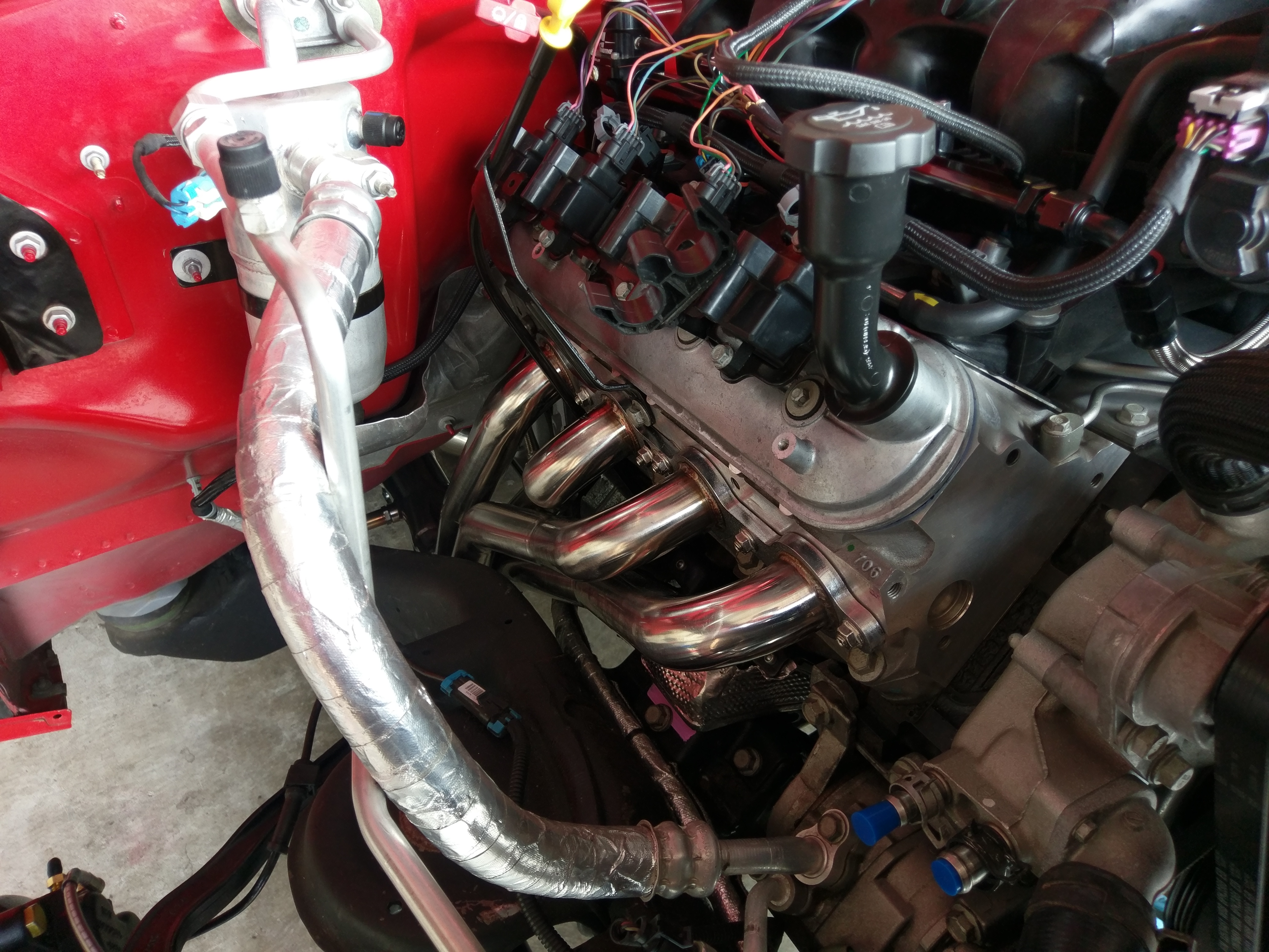

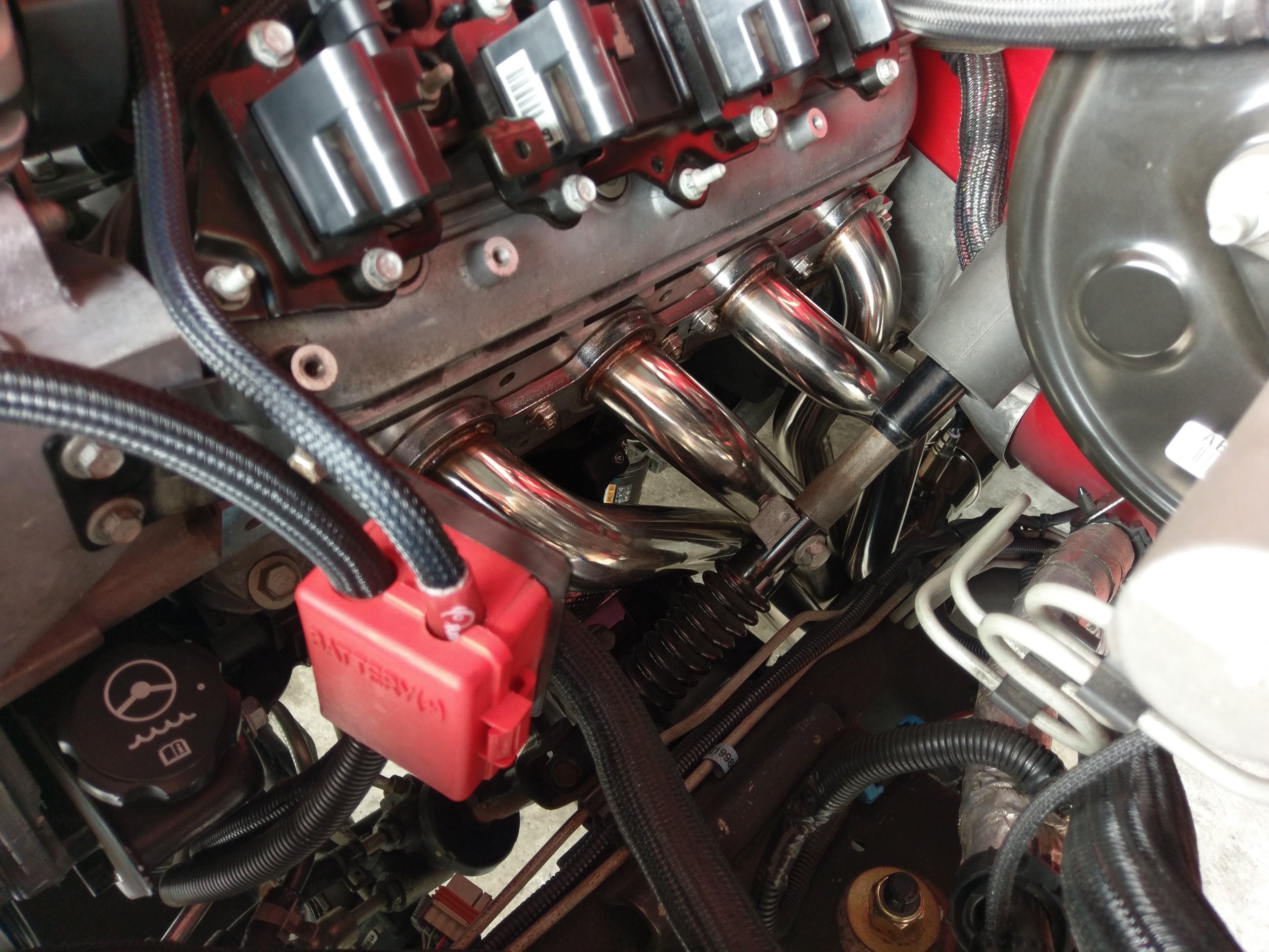

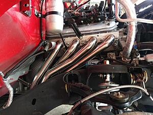

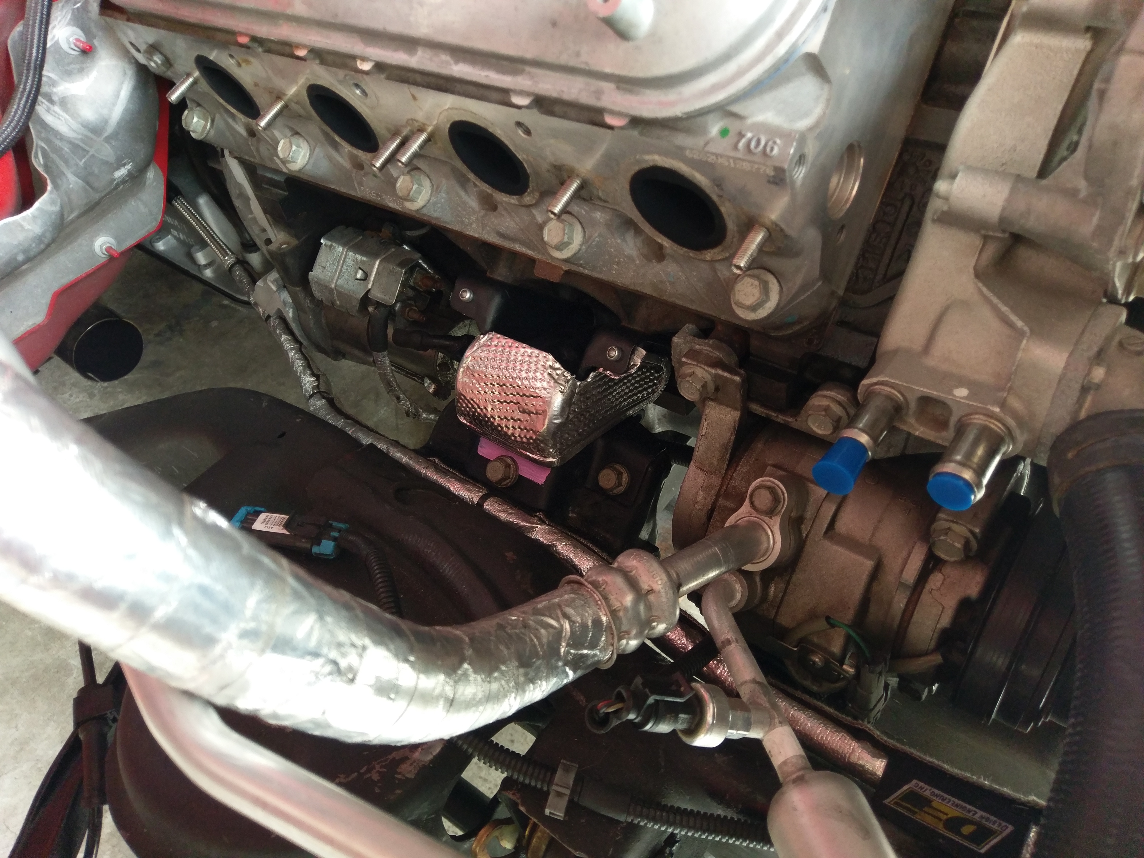

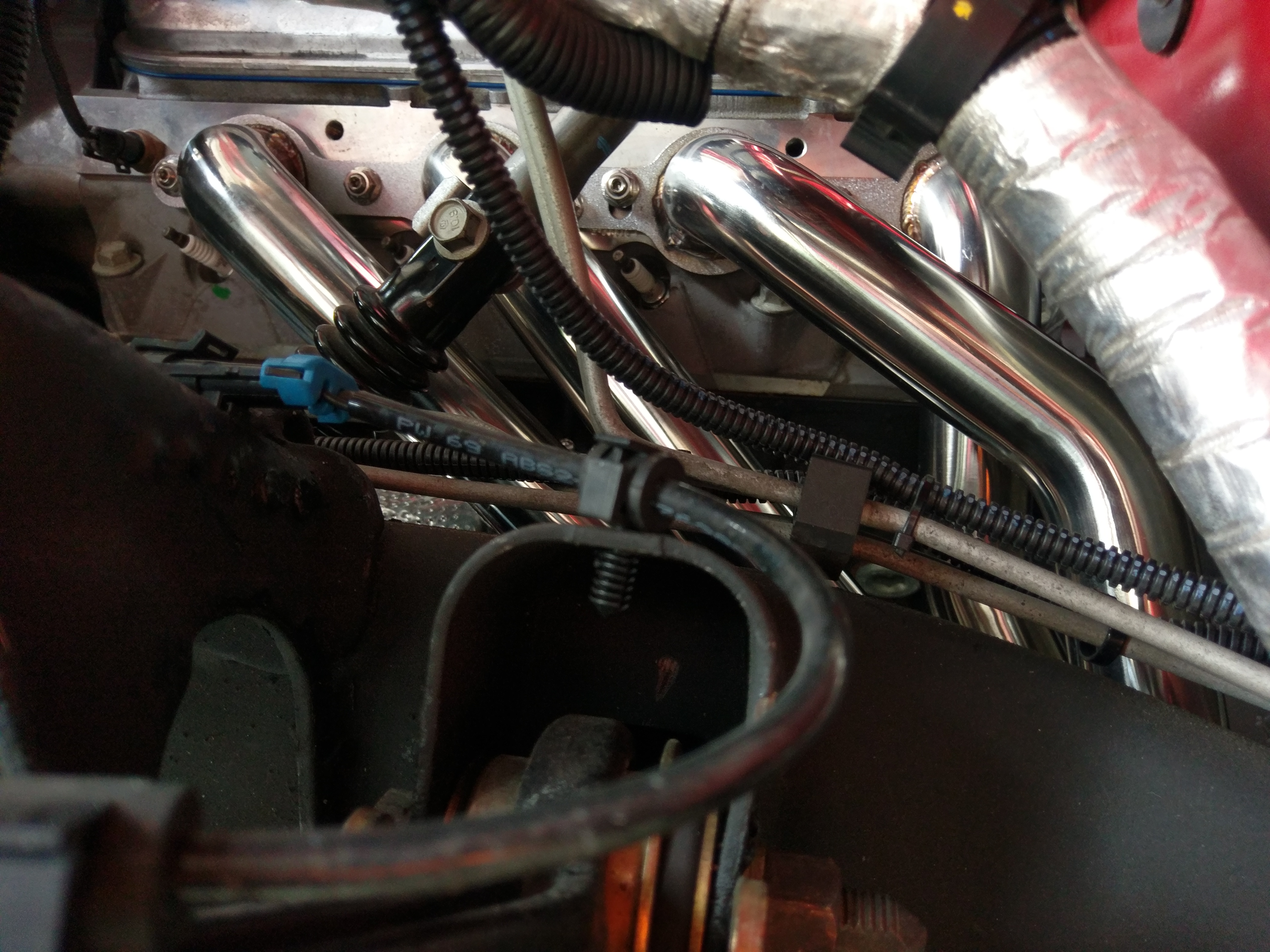

Got the new motor mounts, headers and y pipe installed after work yesterday
ILuvJDM's 2007 NBS RCSB Build - Turbo/4L80e/Coilovers/Wilwoods-twmpton.jpg
ILuvJDM's 2007 NBS RCSB Build - Turbo/4L80e/Coilovers/Wilwoods-qwzr7no.jpg
ILuvJDM's 2007 NBS RCSB Build - Turbo/4L80e/Coilovers/Wilwoods-fbkynn2.jpg

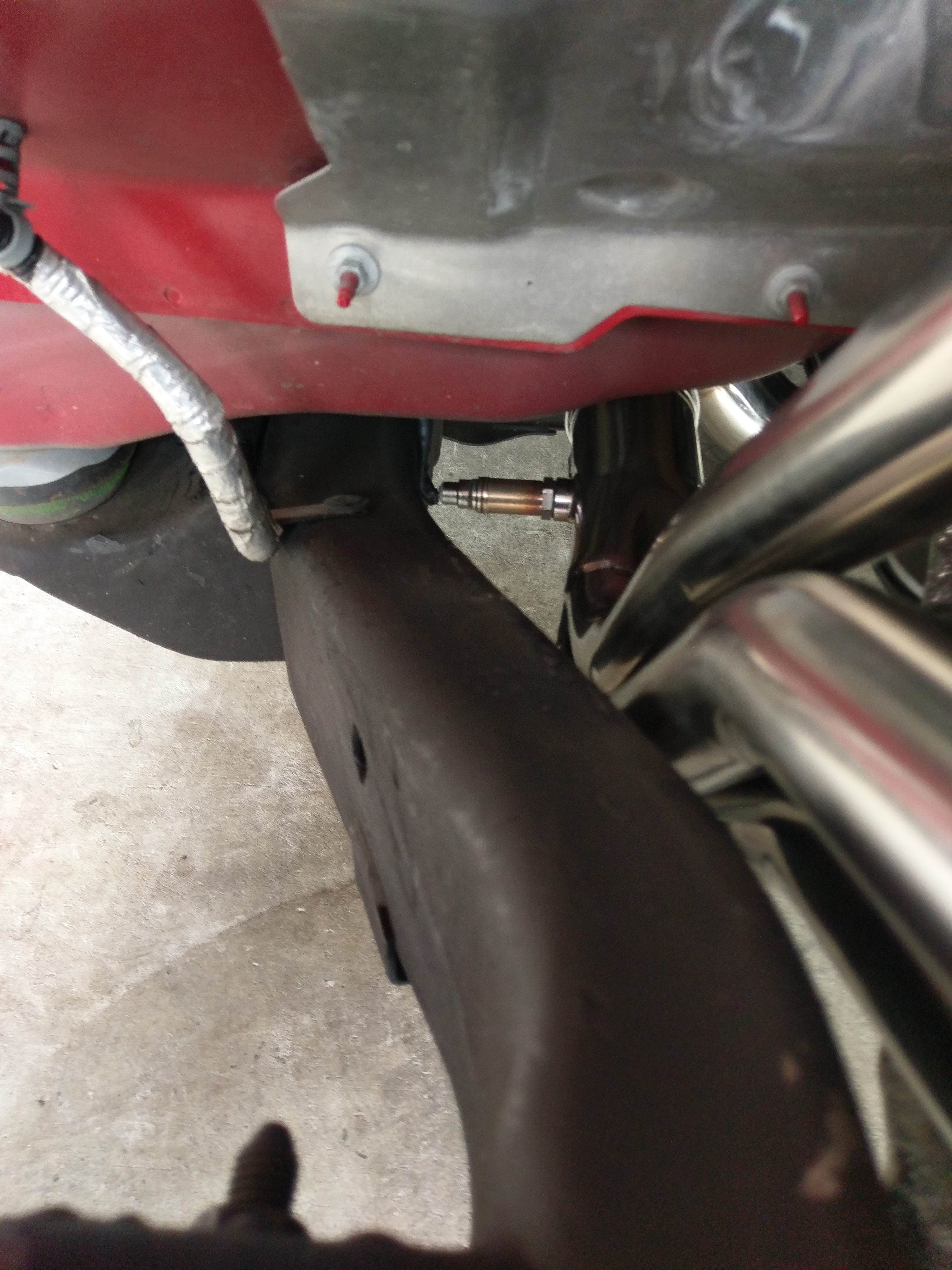

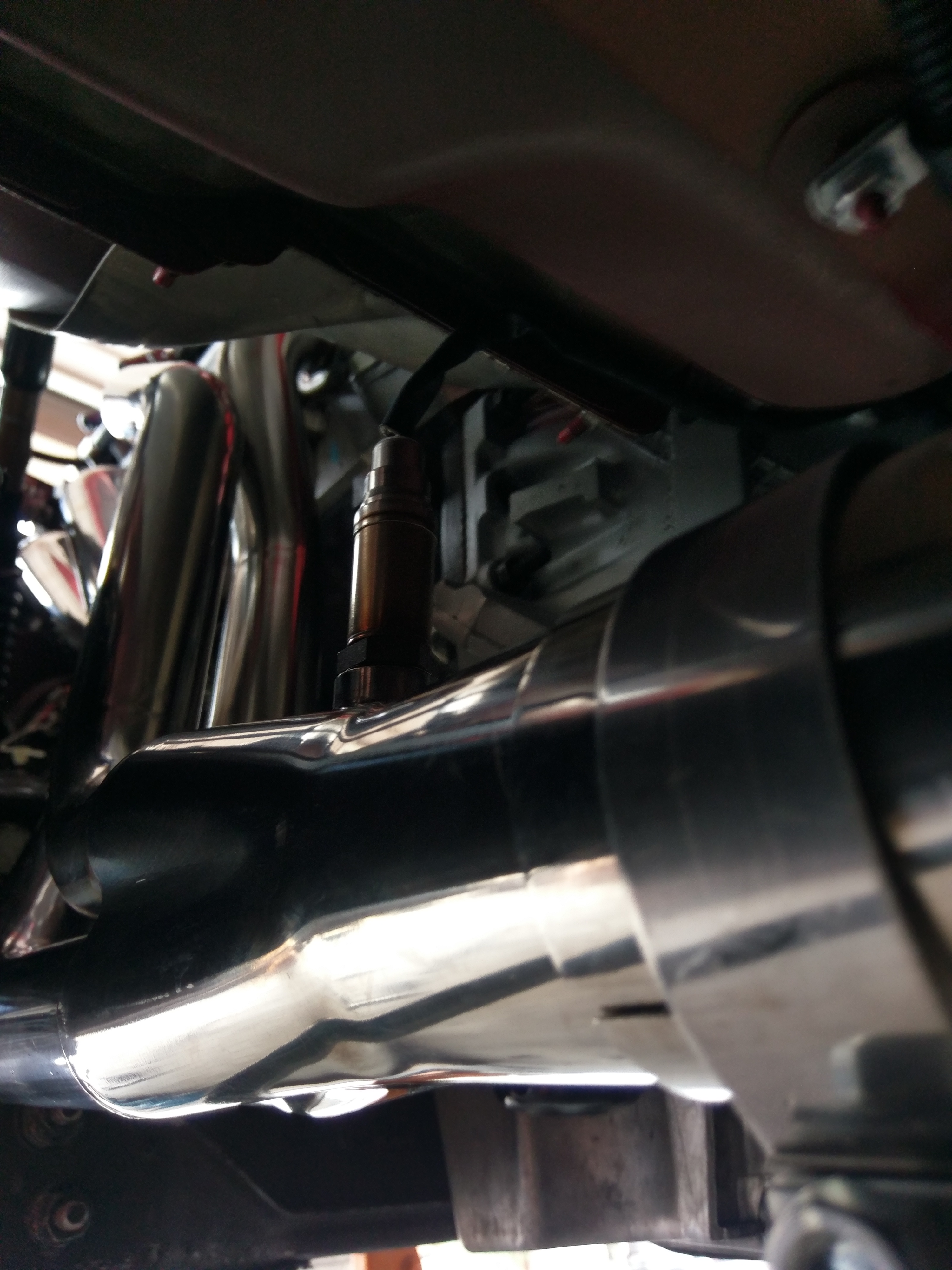

Drivers side o2 has plenty of clearance
ILuvJDM's 2007 NBS RCSB Build - Turbo/4L80e/Coilovers/Wilwoods-h2gy99v.jpg

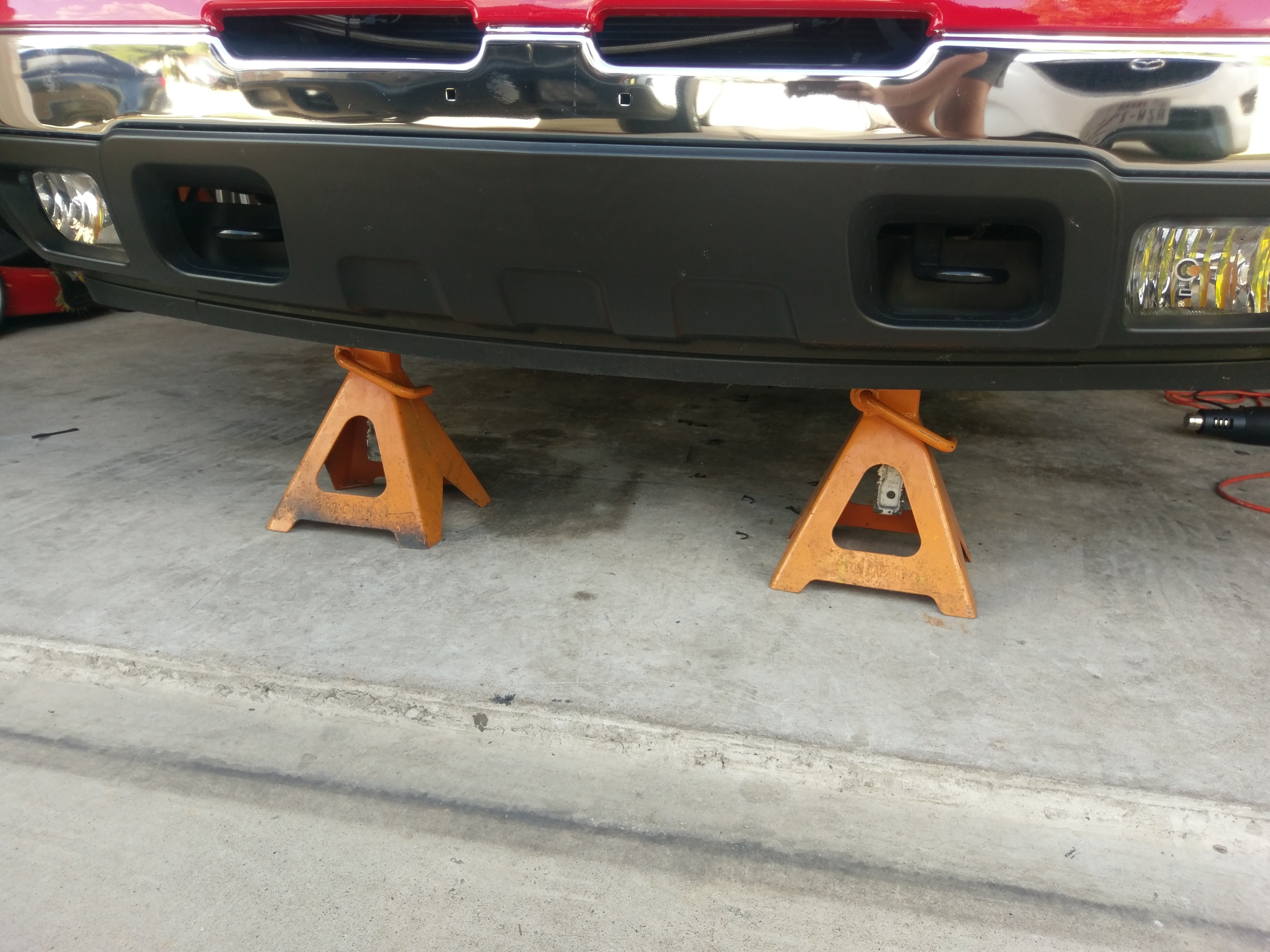

Passenger side wiring barely touched the frame, but nothing to worry about

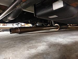

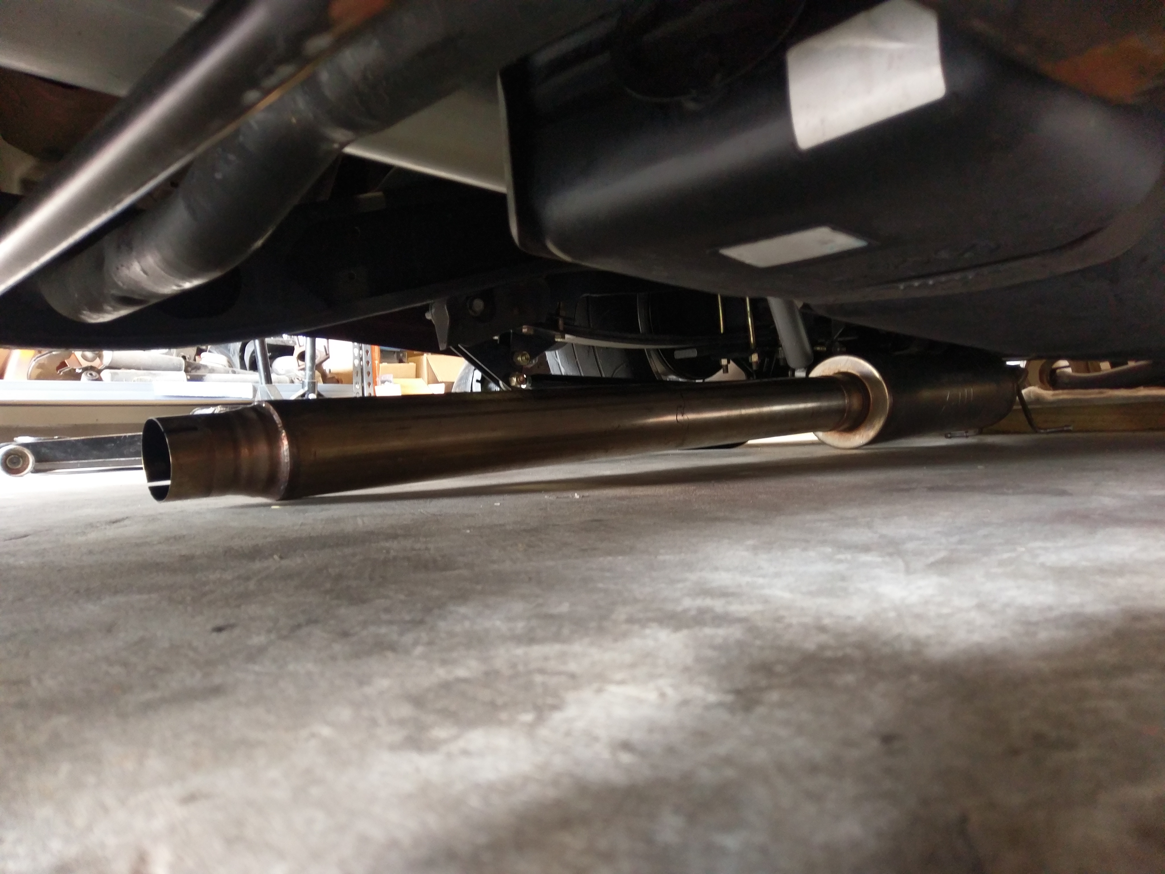

Also got the turbo exhaust removed from the truck

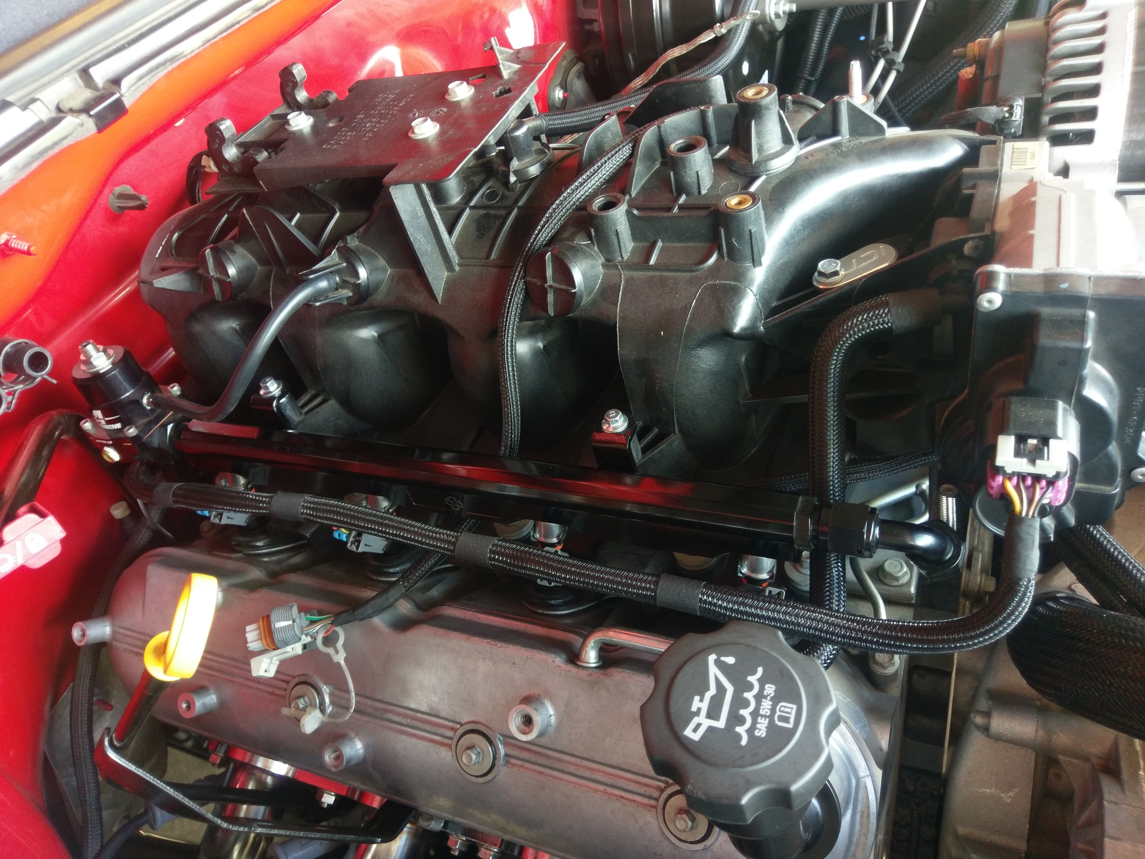

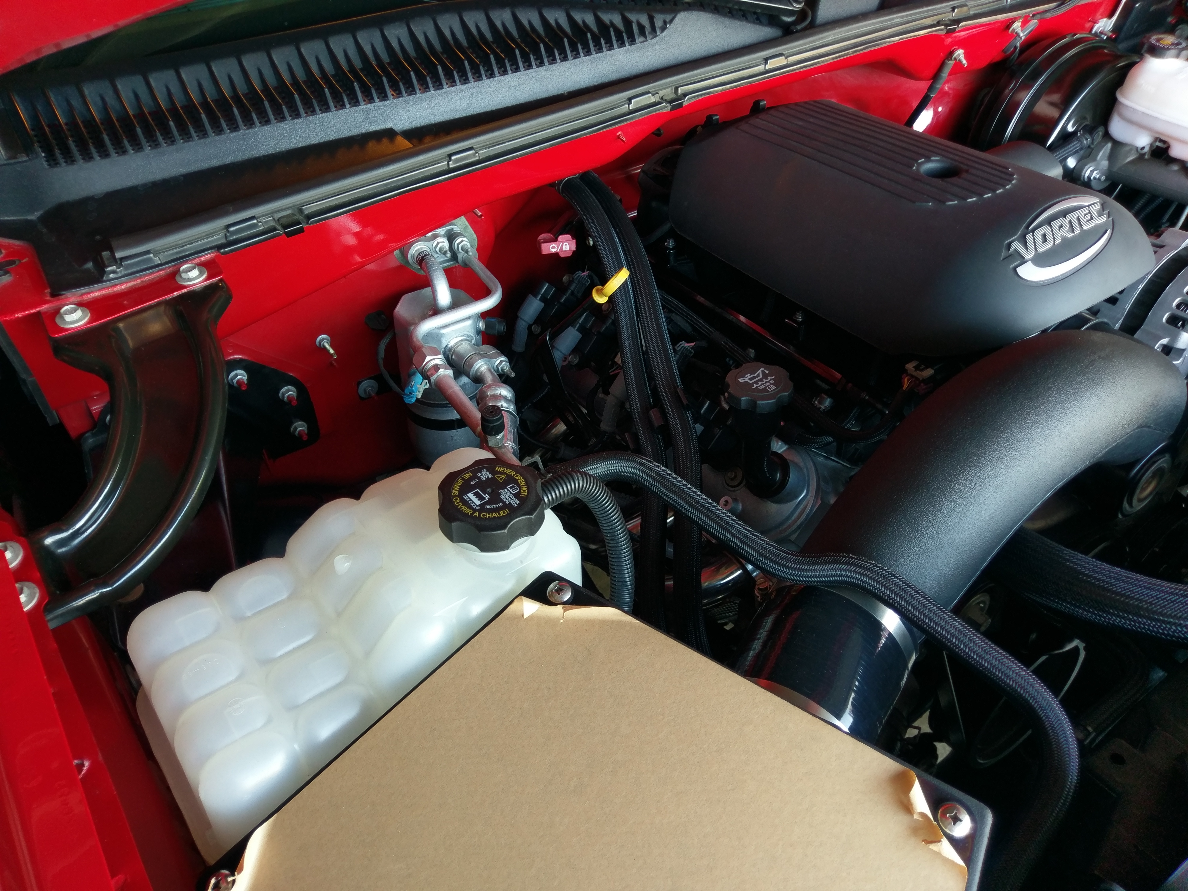

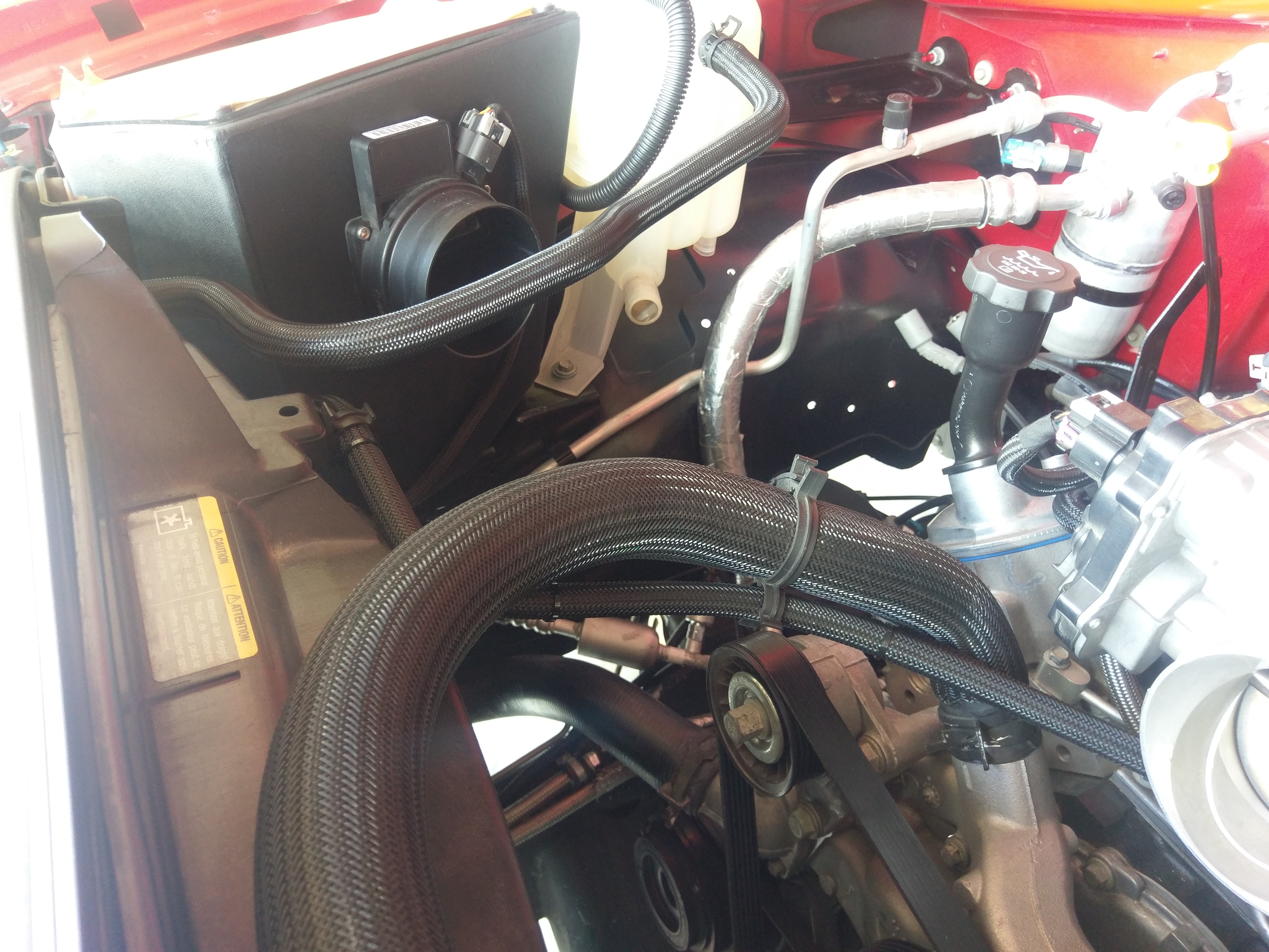

More progress today. Got the coilovers harness routed to both sides, PCV hose wrapped in techflex
ILuvJDM's 2007 NBS RCSB Build - Turbo/4L80e/Coilovers/Wilwoods-ntglc4u.jpg
MAF wiring routed to airbox. It's ziptied to the steam vent line

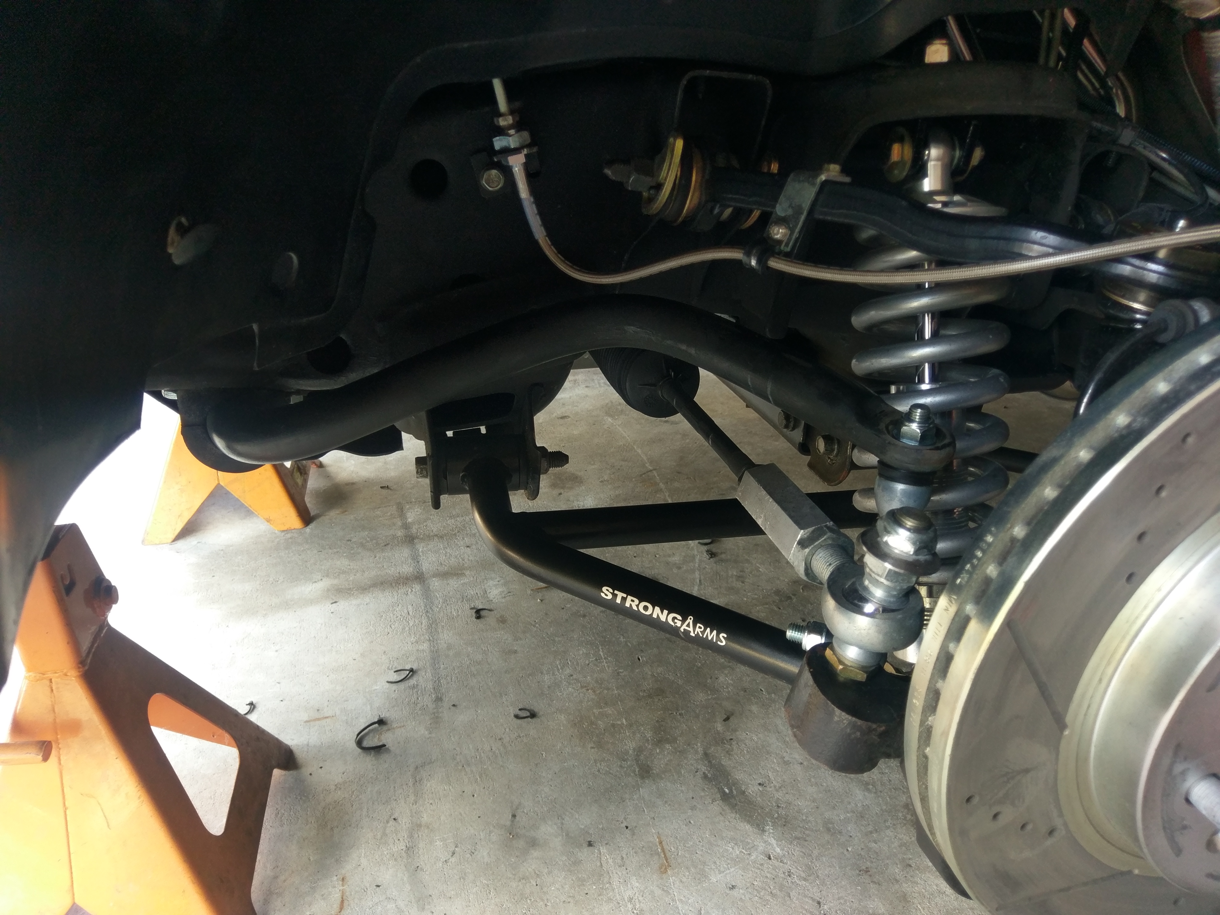

Swaybar installed. Going to have to reroute the brake line so it doesn't get pinched

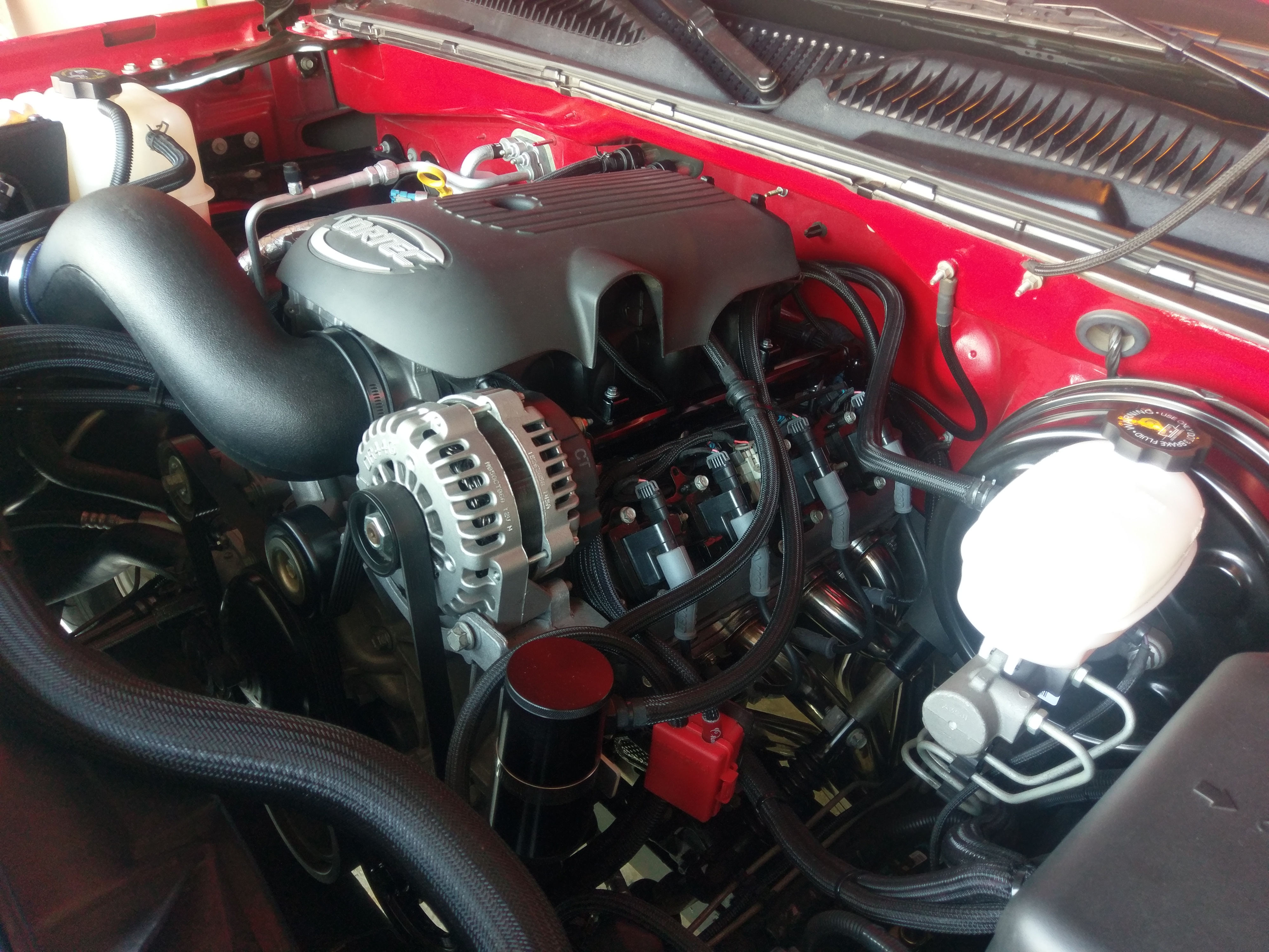

Intake and catch can permanently installed
ILuvJDM's 2007 NBS RCSB Build - Turbo/4L80e/Coilovers/Wilwoods-jdtfrr8.jpg

I ran my brake lines under the sway bar, my first brake line burst from being pinched and I never noticed it.

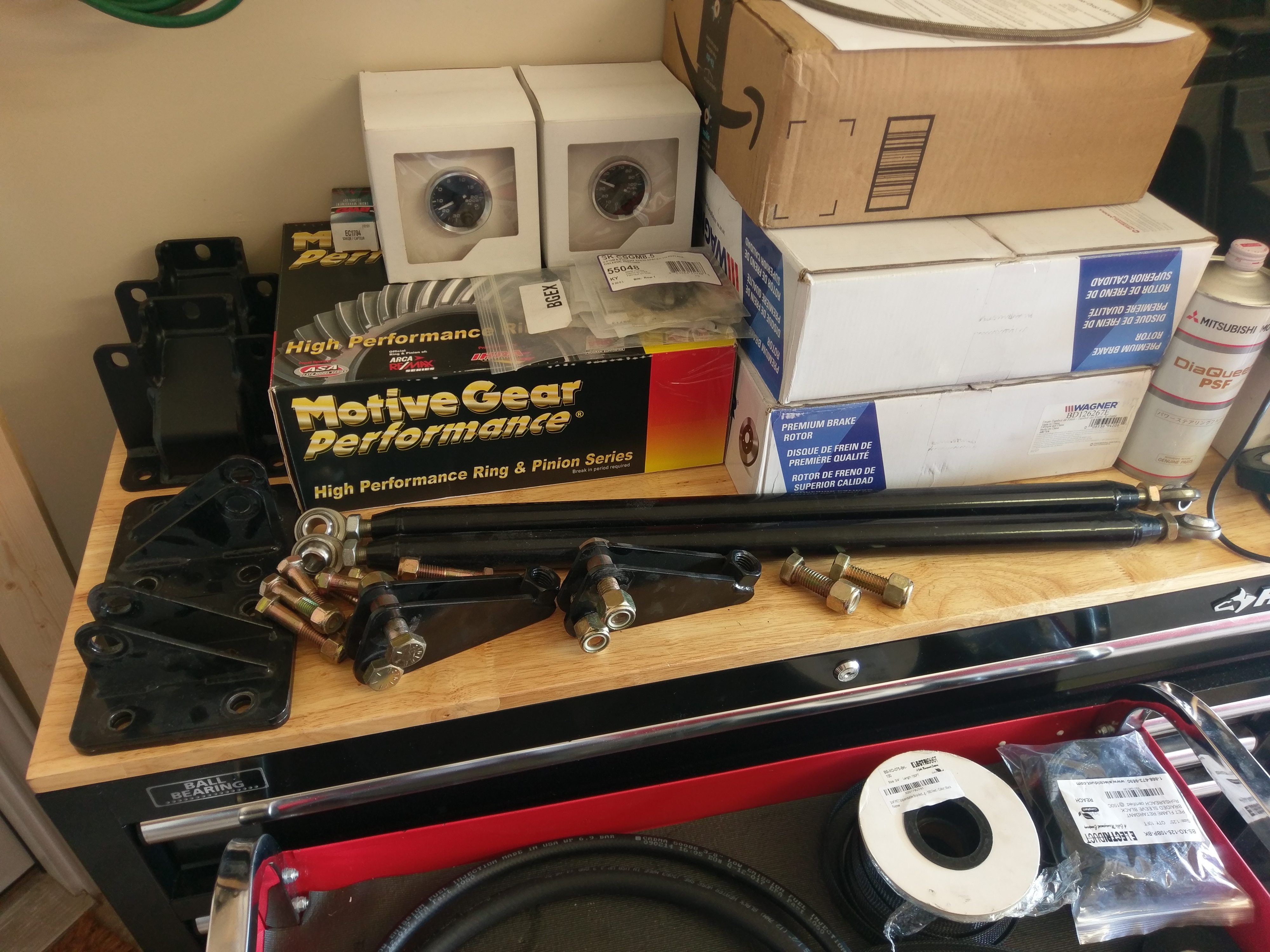

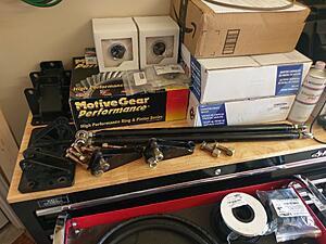

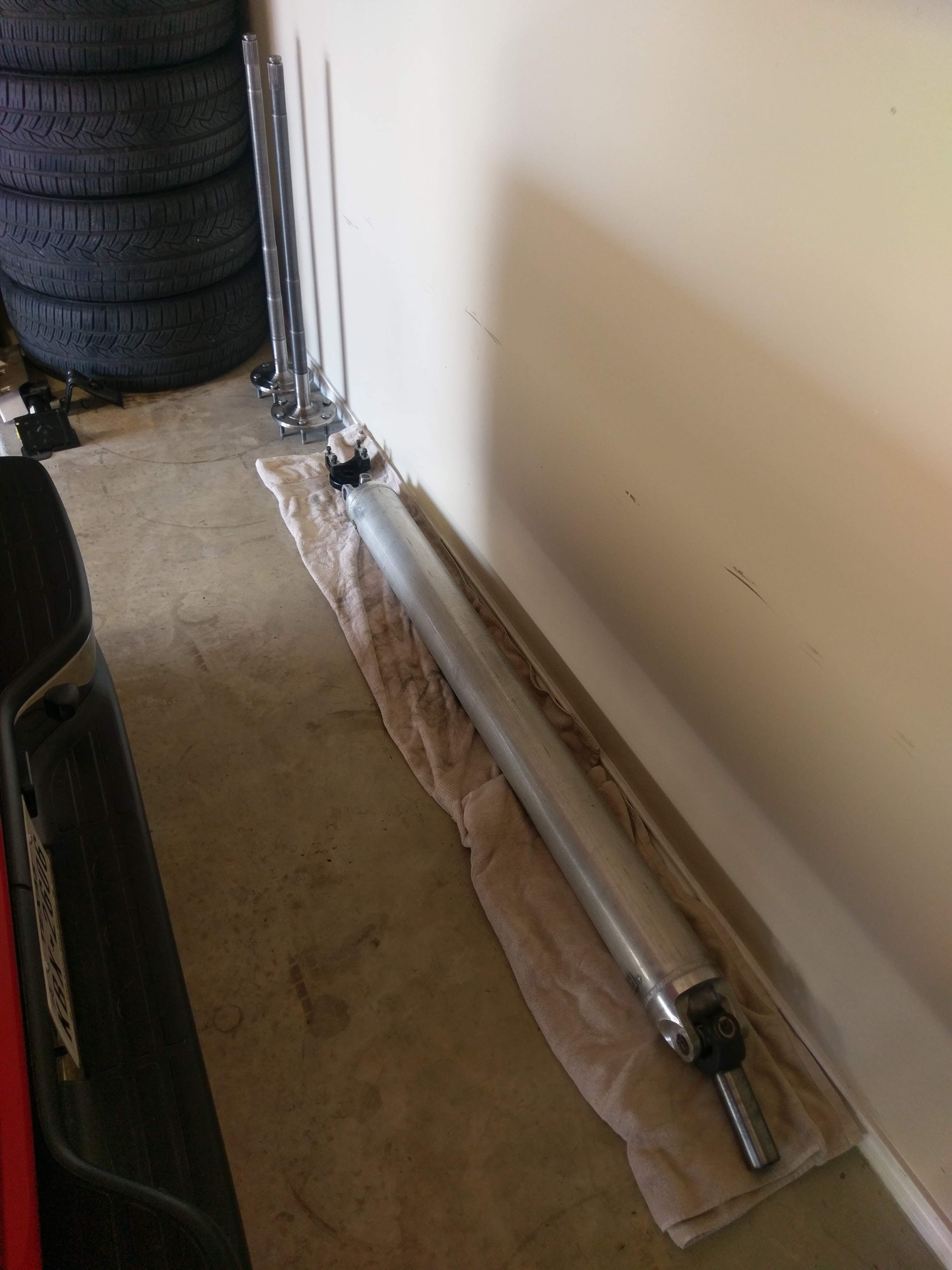

Axles, 5" driveshaft, and 1350 pinion yoke are removed and OEM parts put back. Just need to figure out what to do for the driveshaft.
ILuvJDM's 2007 NBS RCSB Build - Turbo/4L80e/Coilovers/Wilwoods-bfqk8os.jpg
Traction bars removed.
ILuvJDM's 2007 NBS RCSB Build - Turbo/4L80e/Coilovers/Wilwoods-aggwtgc.jpg

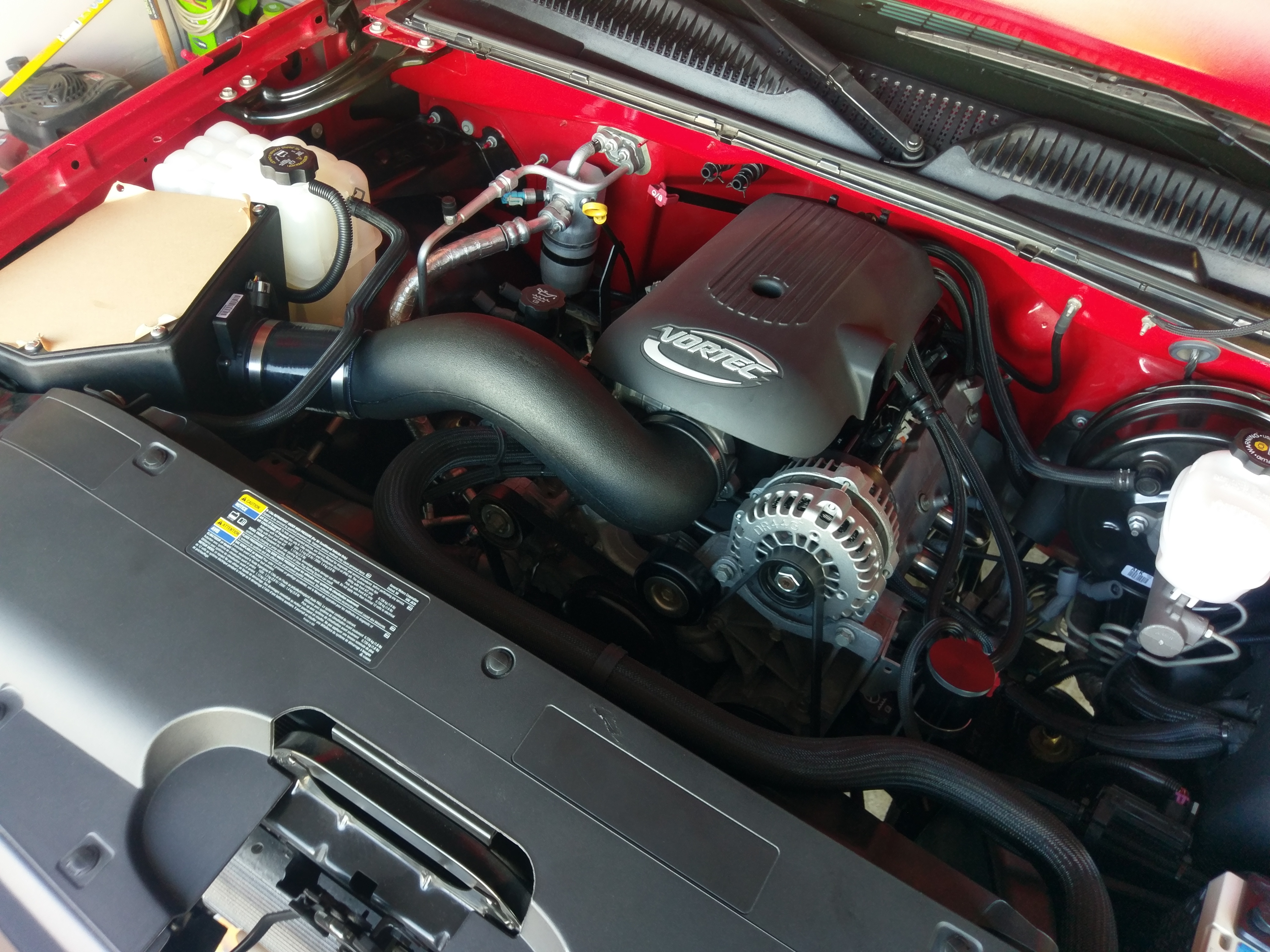

Engine bay is 100% now, just need to reinstall the OEM injectors
ILuvJDM's 2007 NBS RCSB Build - Turbo/4L80e/Coilovers/Wilwoods-juy6bwj.jpg
ILuvJDM's 2007 NBS RCSB Build - Turbo/4L80e/Coilovers/Wilwoods-ddvimgp.jpg
