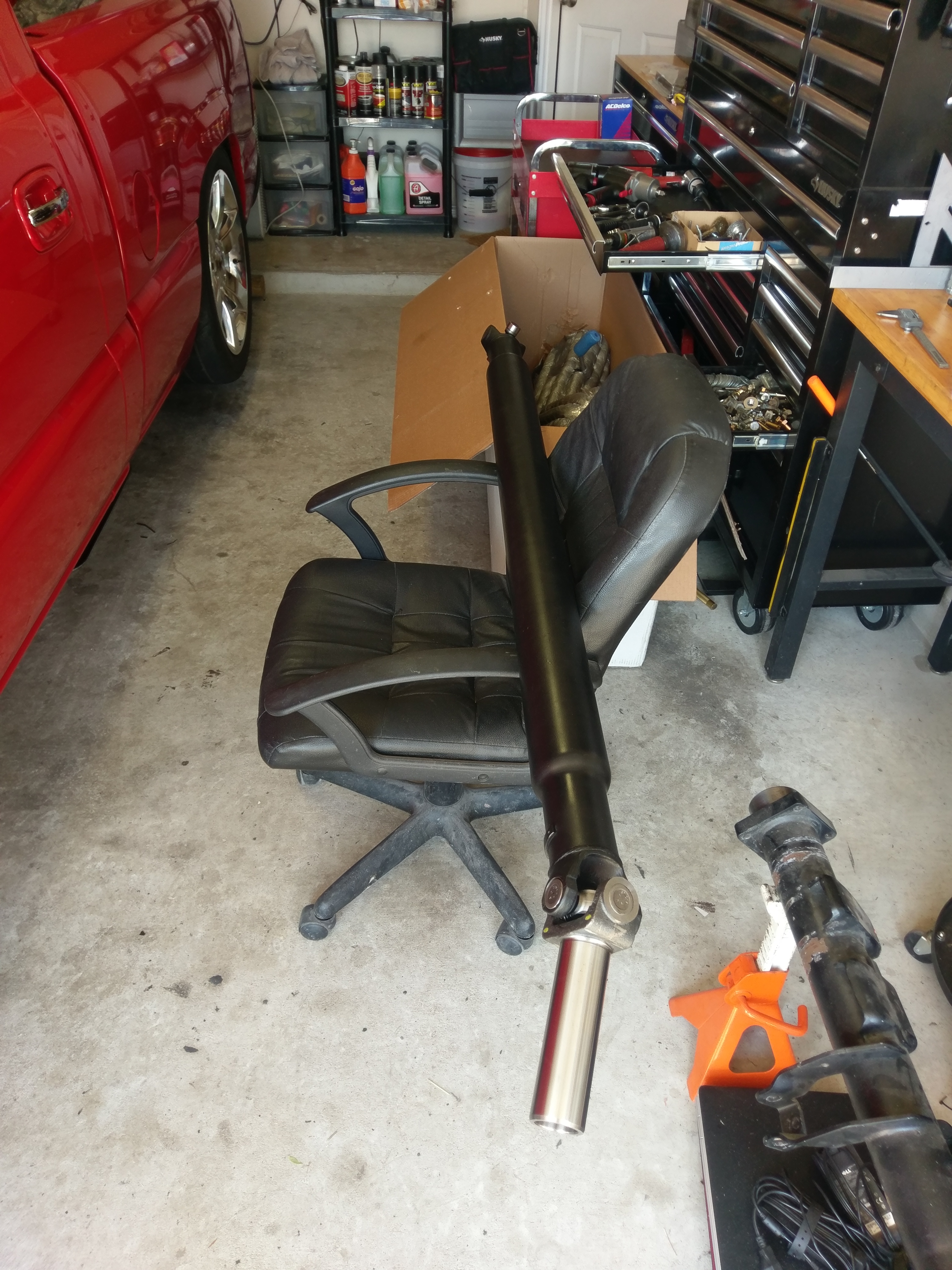

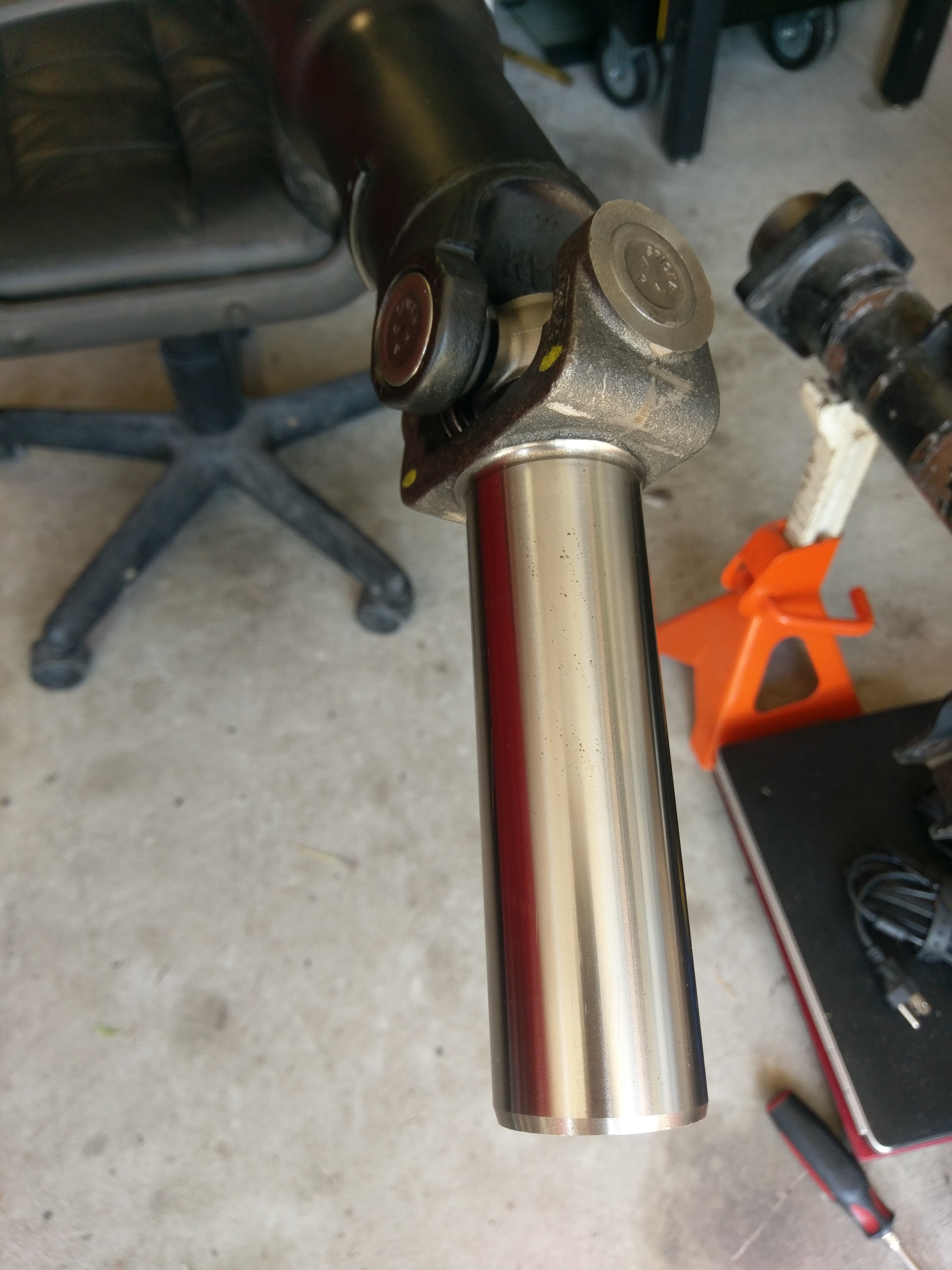

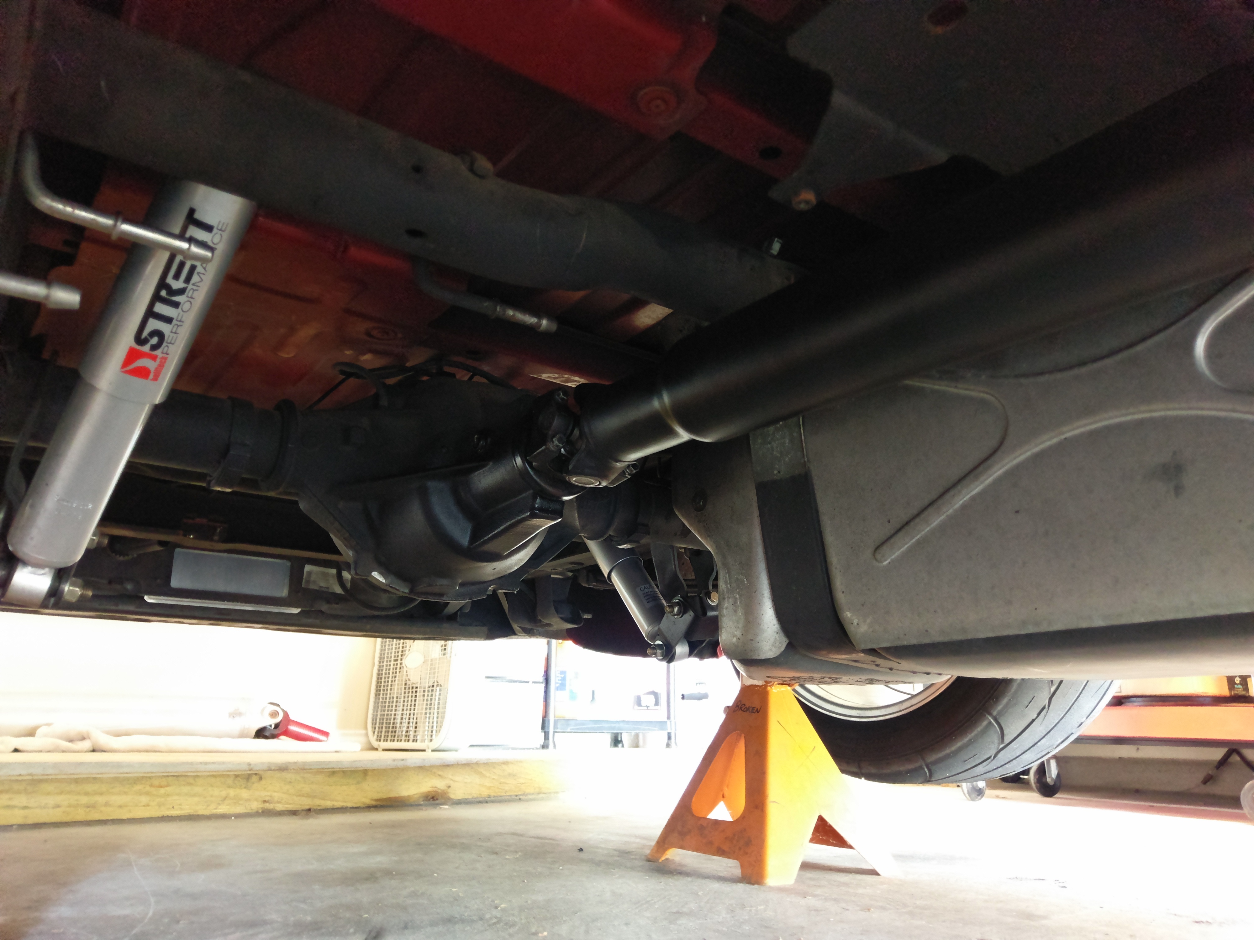

So I found a 4L80e 32 spline yoke with 3R joint size on it so I could run OEM size all throughout the driveshaft. Not sure why people don't recommend this yoke for 2wd 80e swap guys. It's a direct fit on the stock length driveshaft. Unless I'm missing something, it should work perfect. It has 7/8" of pullout at ride height from being fully bottomed out in the tailhousing.
NEAPCO N3R-3-9131X Transmission Slip Yoke 3R Series 32 spline TH400 Long Barrel - $70 shipped
Got a stock driveshaft from a local member and sanded the rust off and painted it satin black.

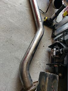

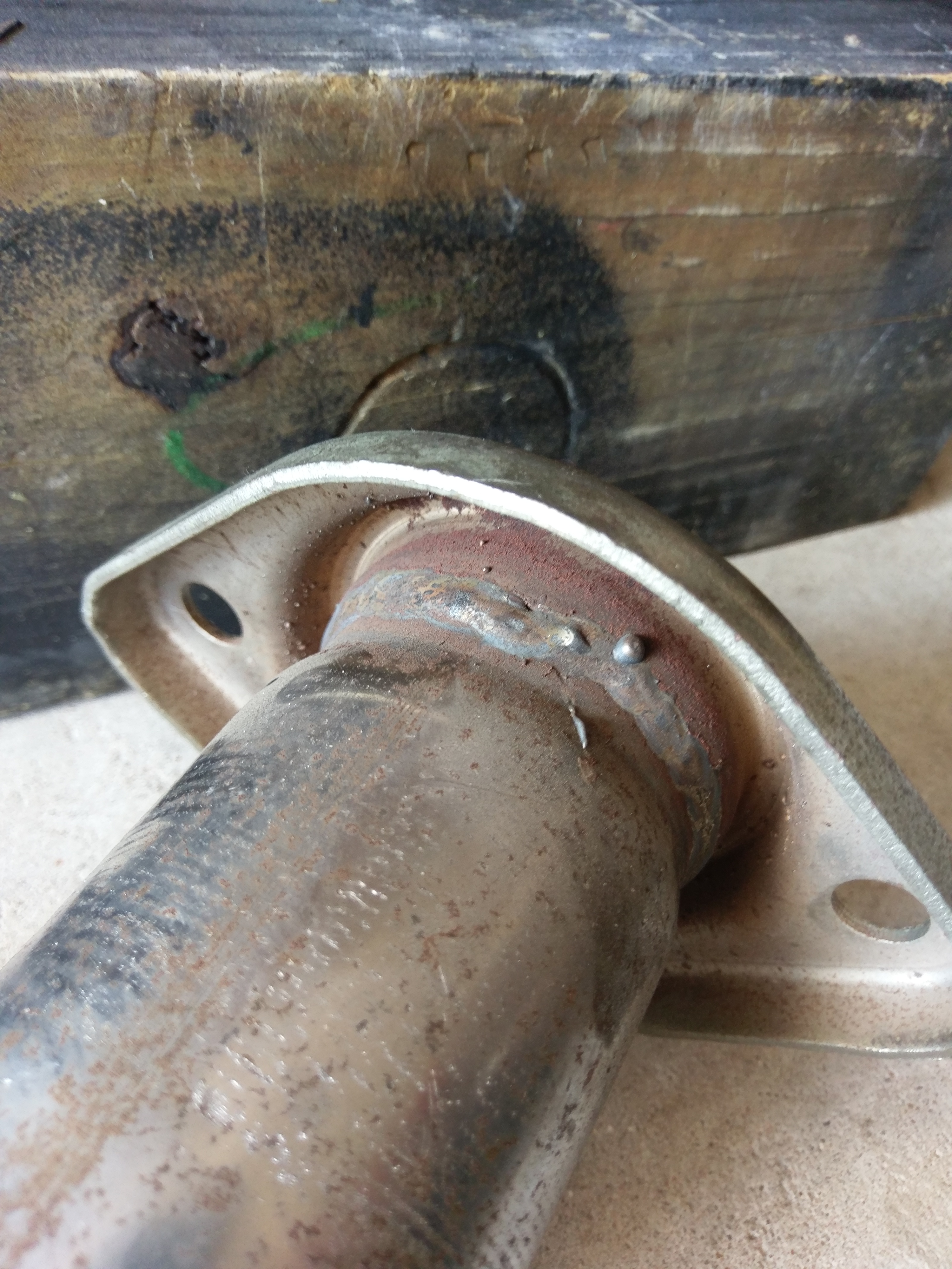

I really thought Magnaflow would have better quality than Speed Engineering, but check out the Magnaflow piping:

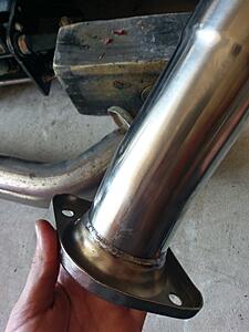

Speed Engineering:

Magnaflow's quality has gone way down hill the last several years.

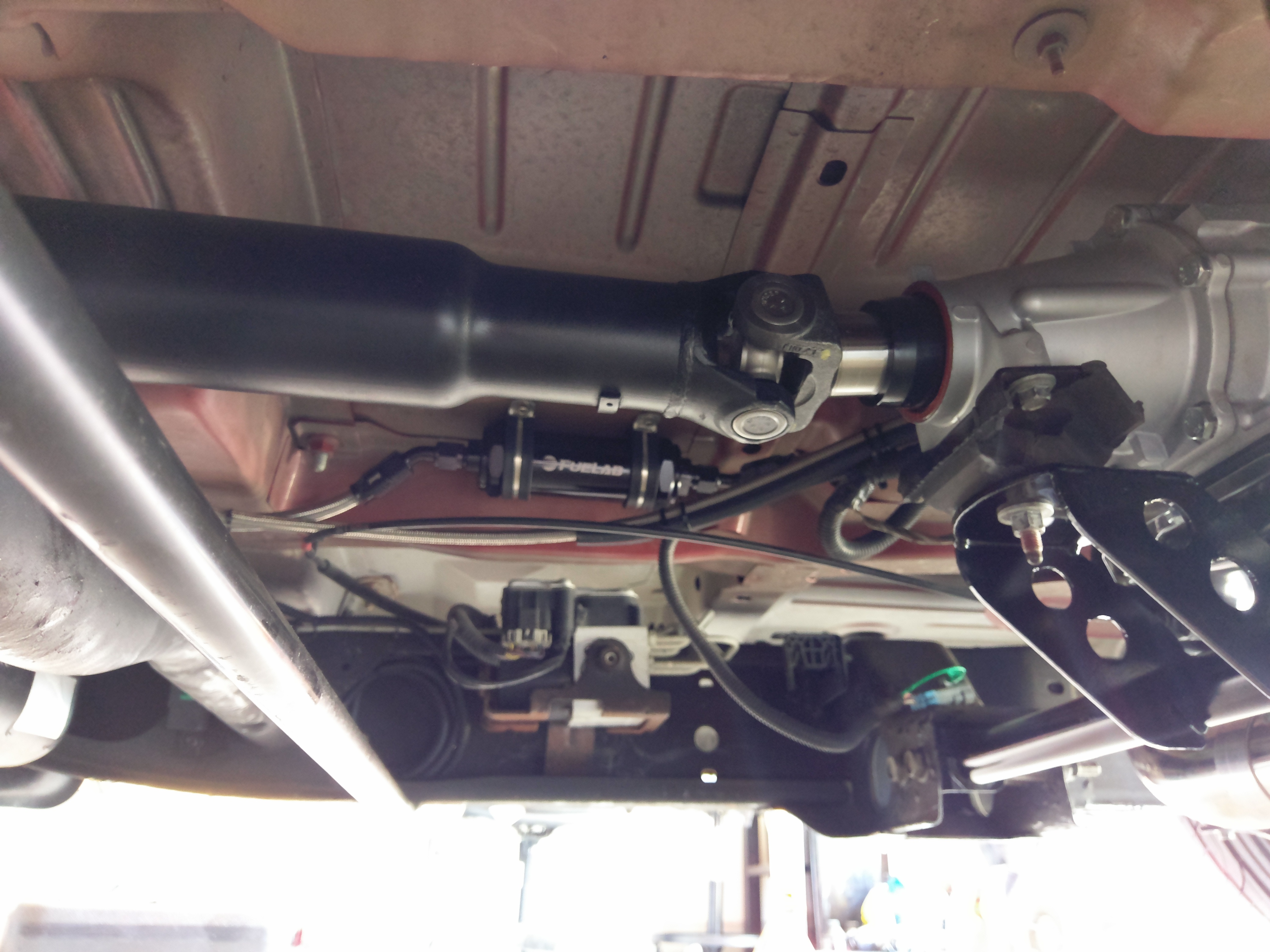

Damn you need spacers under the transmission that u joint angle is pretty rough
The angle at the rear isn't too bad but at the trans it's pretty bad
I noticed that when I was measuring for pinion angle. It's really far off and I'm not sure why. I tried to locate a new ACDelco tranny mount but could only find 4wd ones.

There's a few ways to fix the angle, not my favorite but it's pretty common to shim the trans mount between the mount and pad or mount and trans housing or both. If you need say about 3/4" you could get some 3/4" square tubing and drill holes in it and bolt it to your trans crossmember and a hole in the top of the tubing for the trans mount to mount to. Or just take the whole crossmember off and have a riser pad welded on.
