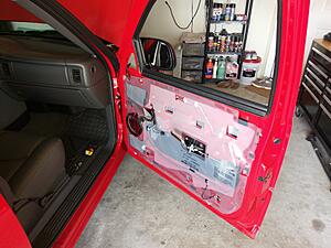

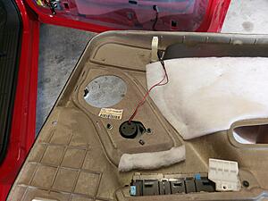

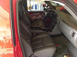

Wasn't happy with the coaxial sundown door speakers, so I am reinstalling the sundown components
ILuvJDM's 2007 NBS RCSB Build - Turbo/4L80e/Coilovers/Wilwoods-8lvhjul.jpg
ILuvJDM's 2007 NBS RCSB Build - Turbo/4L80e/Coilovers/Wilwoods-cdozpoe.jpg

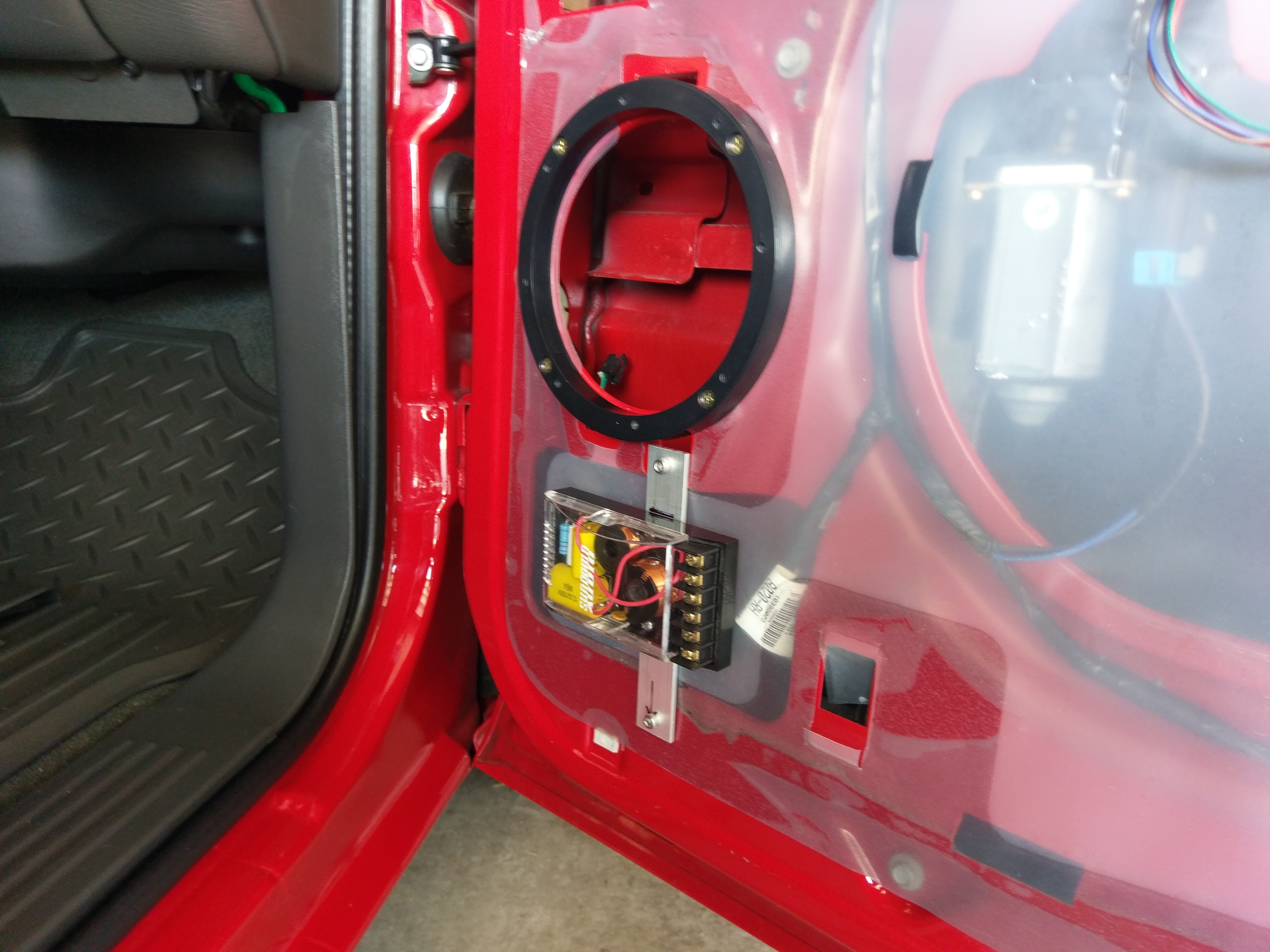

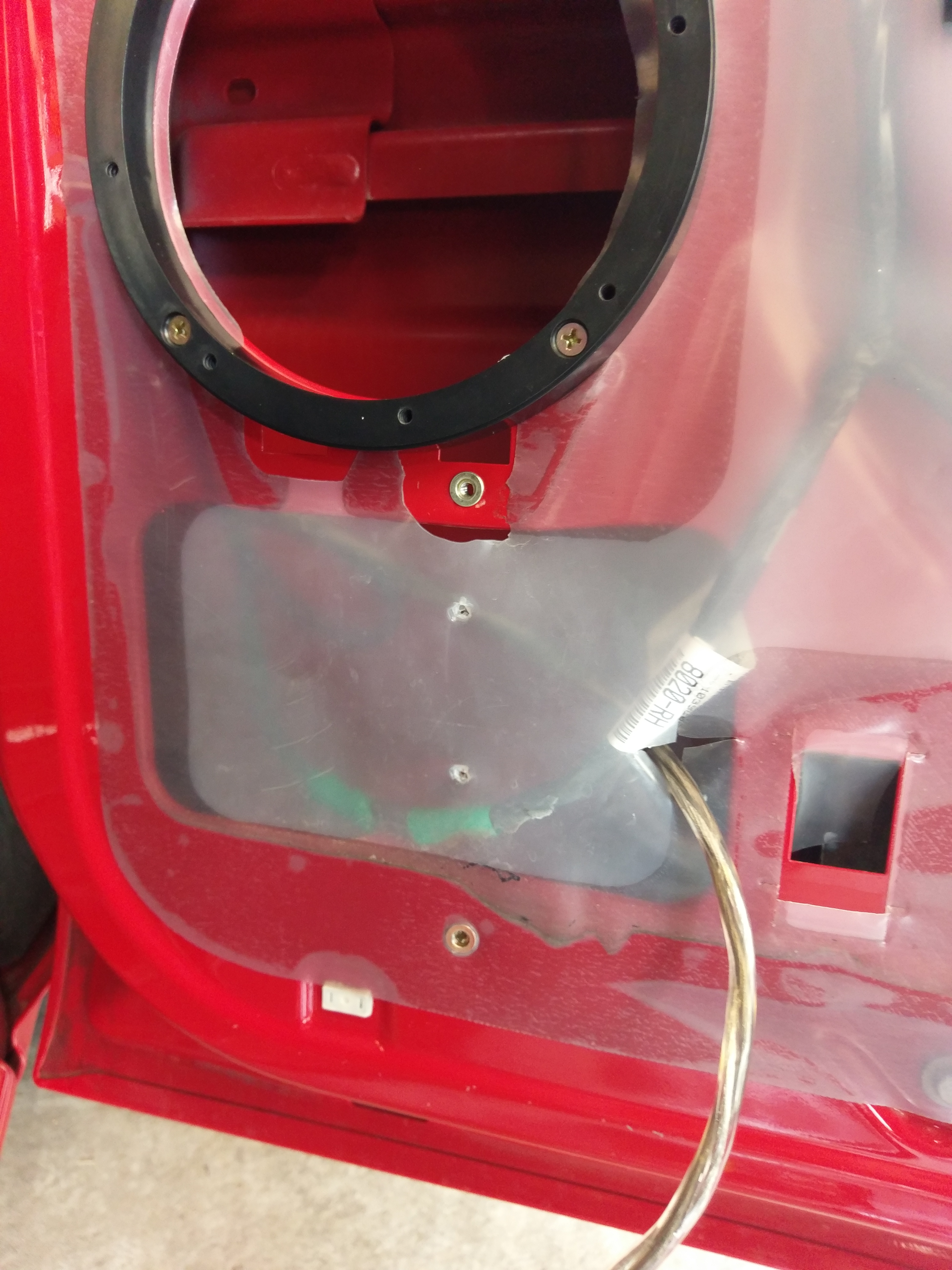

Added some nutserts

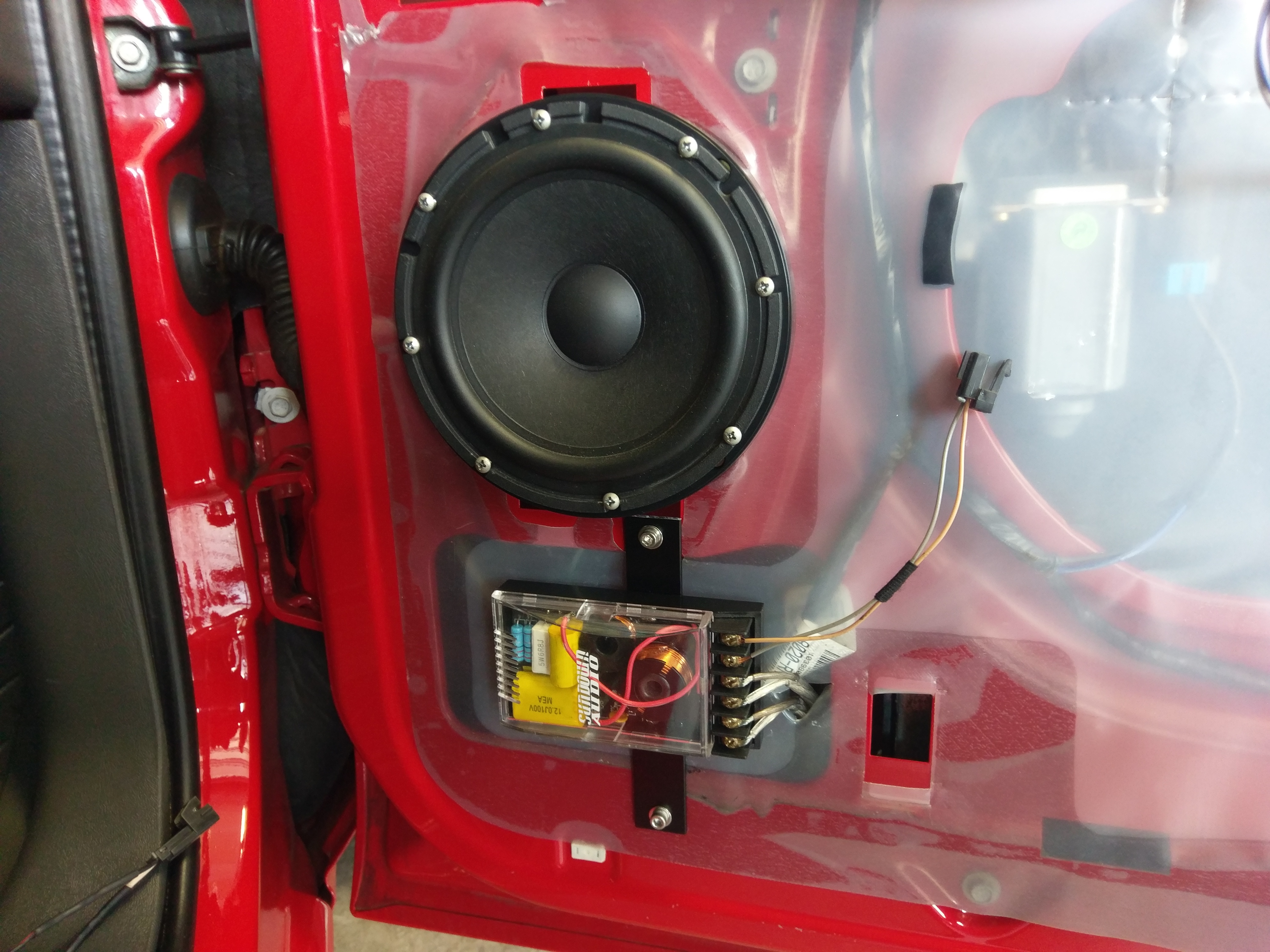

ILuvJDM's 2007 NBS RCSB Build - Turbo/4L80e/Coilovers/Wilwoods-pyzzjkz.jpg
Test fit
ILuvJDM's 2007 NBS RCSB Build - Turbo/4L80e/Coilovers/Wilwoods-me15s5o.jpg

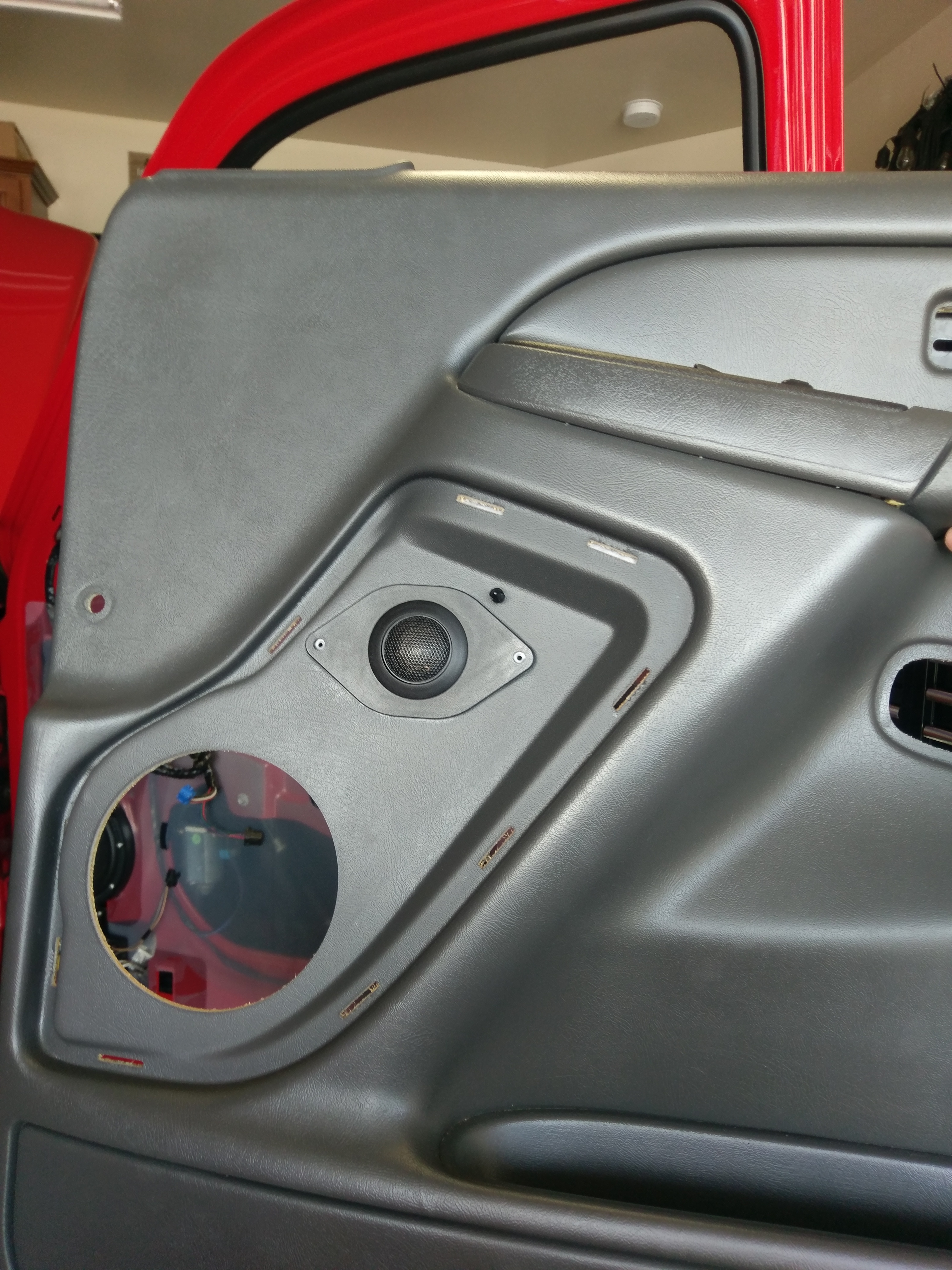

Finished product. Tweeters are on plugs like stock to I can remove the door panel easier
ILuvJDM's 2007 NBS RCSB Build - Turbo/4L80e/Coilovers/Wilwoods-io0hpyz.jpg
Put the sundown tweeters in the stock bracket
ILuvJDM's 2007 NBS RCSB Build - Turbo/4L80e/Coilovers/Wilwoods-tb5sqxx.jpg

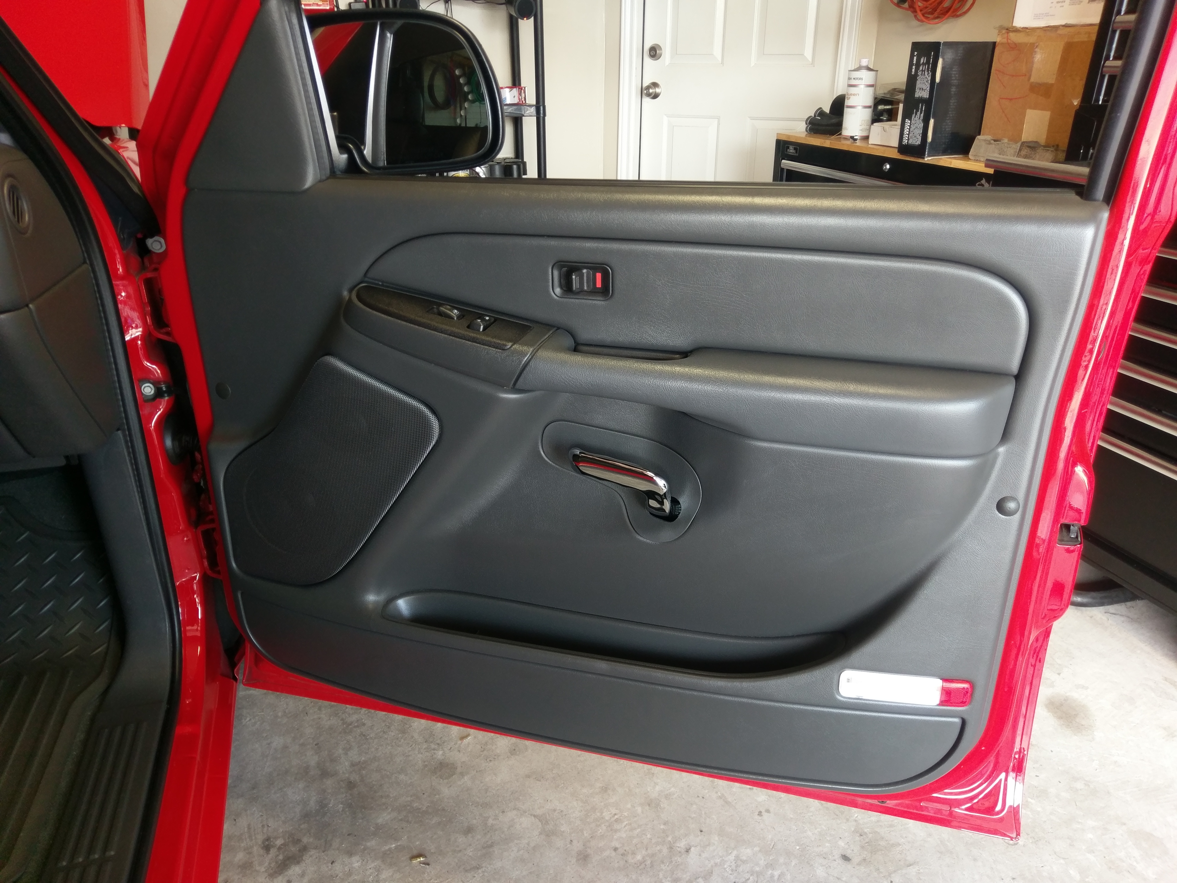

Installs just like the factory ones
ILuvJDM's 2007 NBS RCSB Build - Turbo/4L80e/Coilovers/Wilwoods-efxnuln.jpg

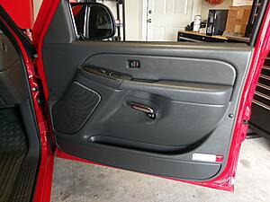

Looks factory

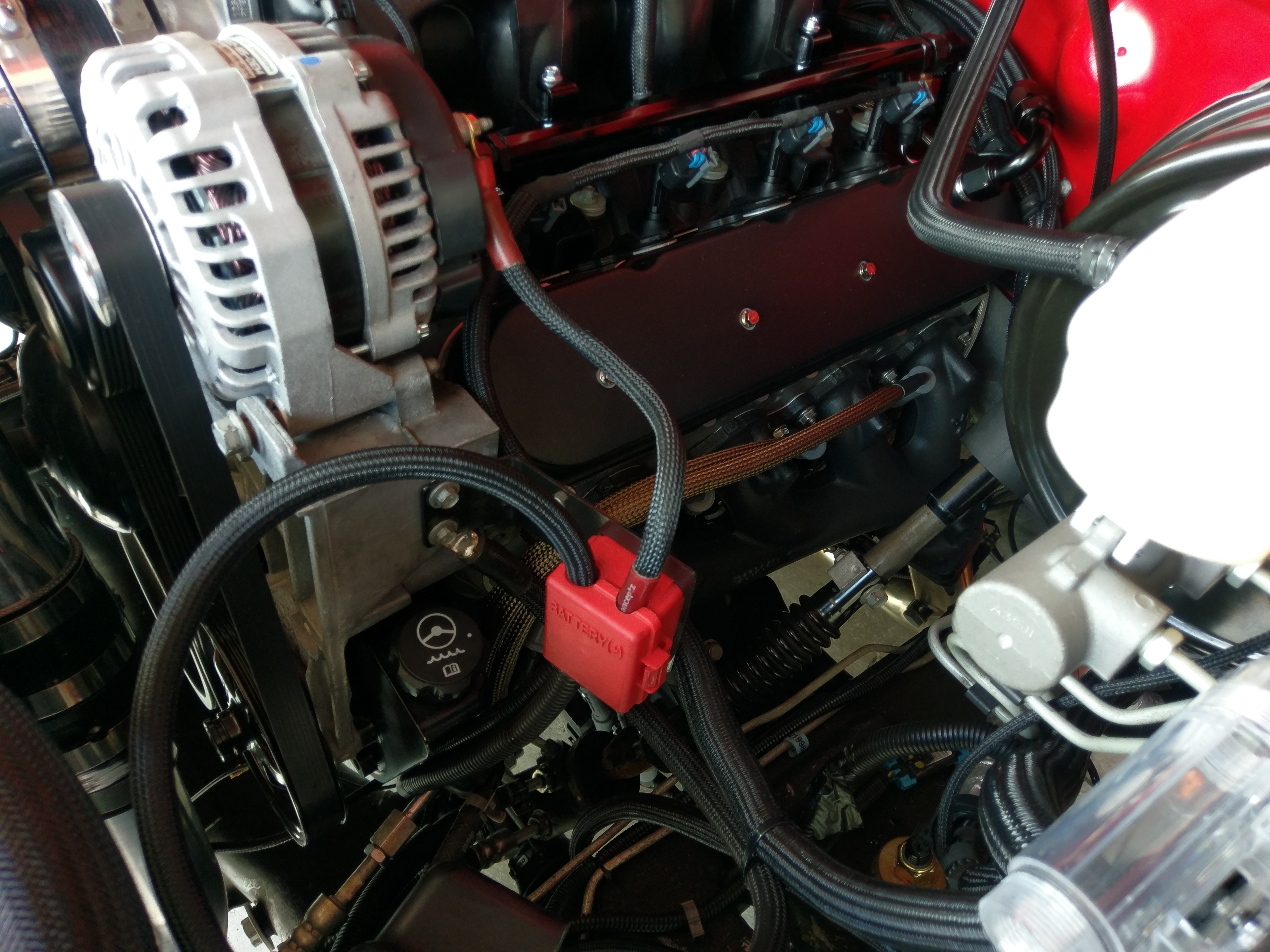

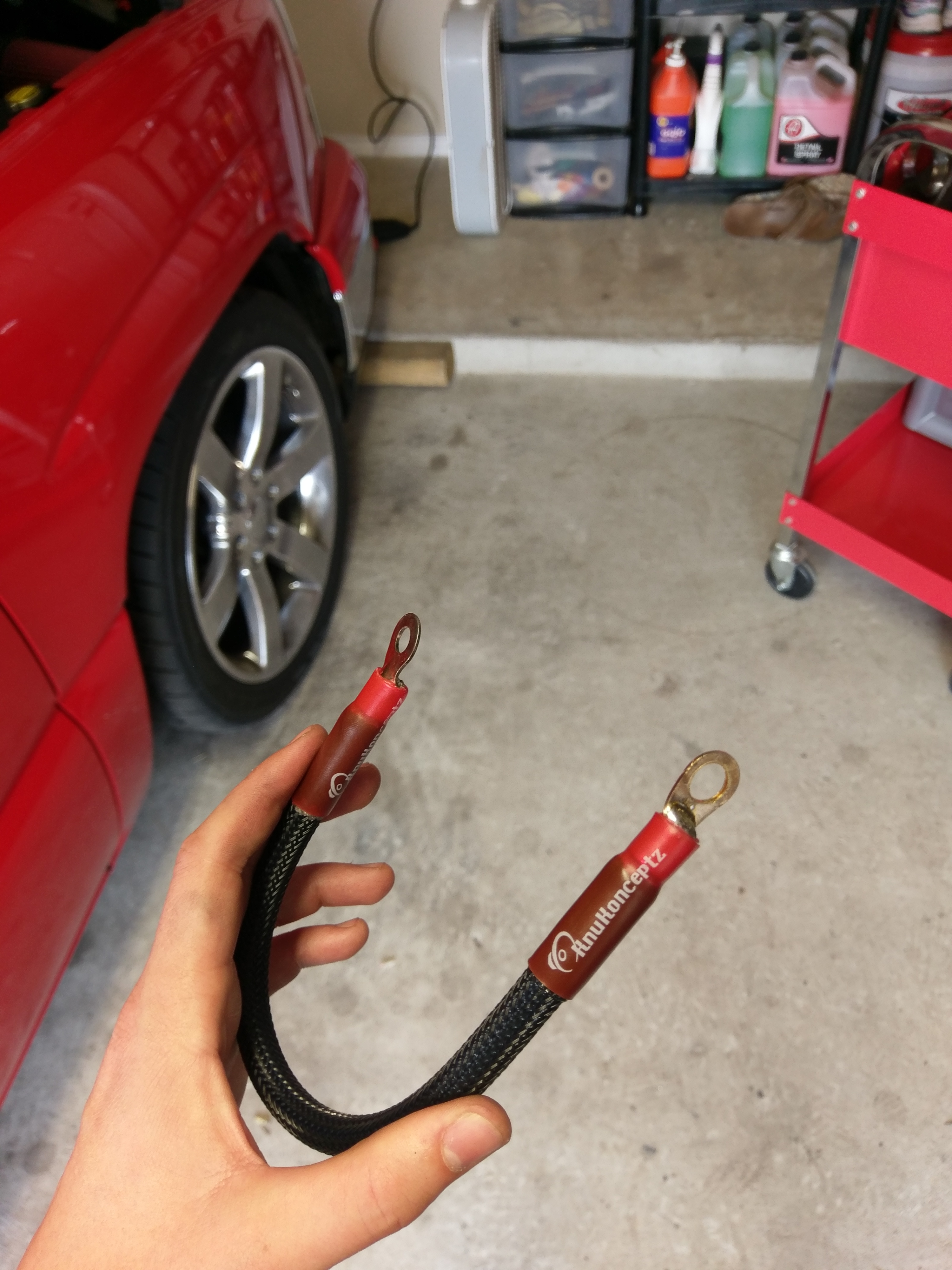

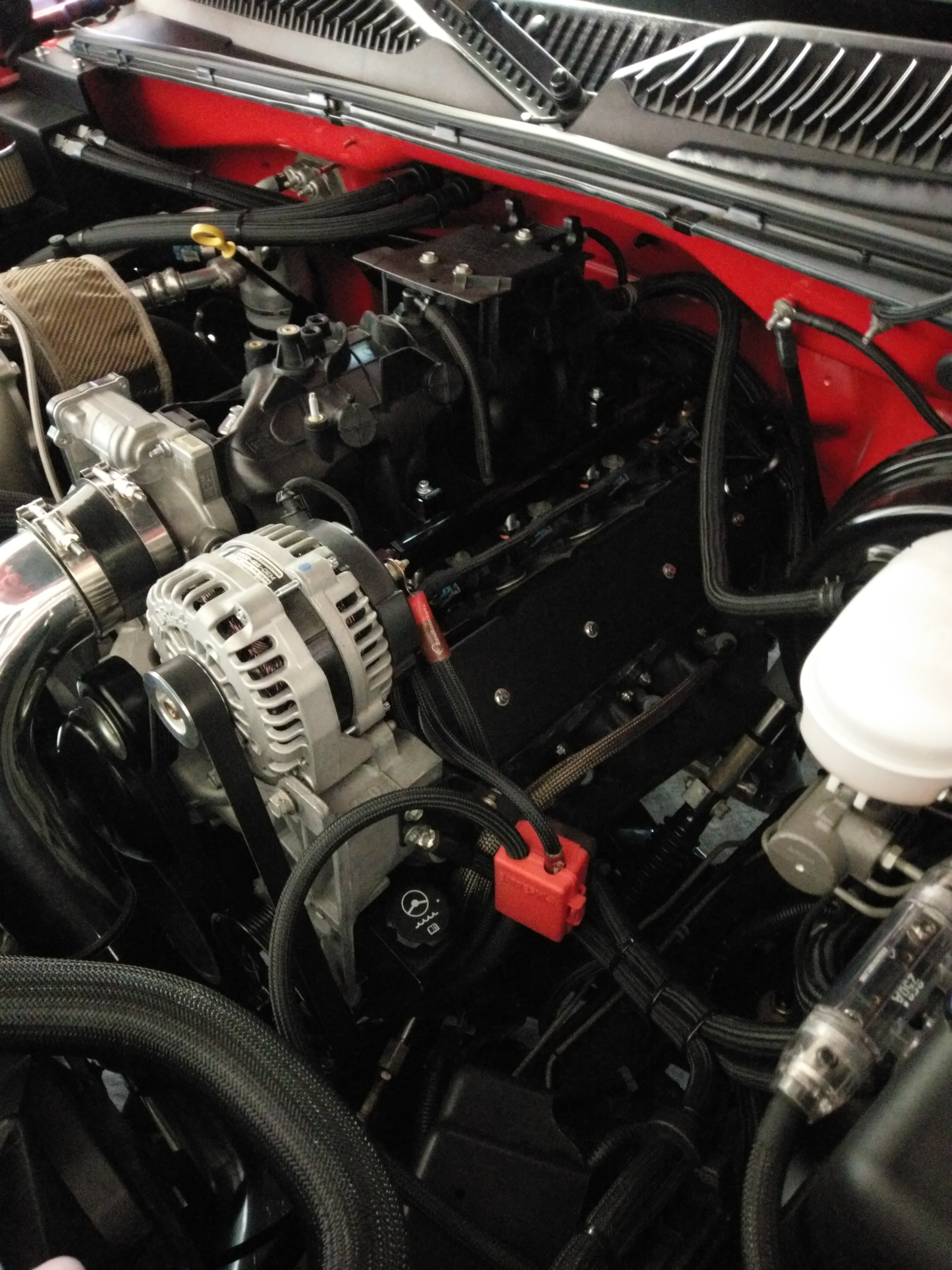

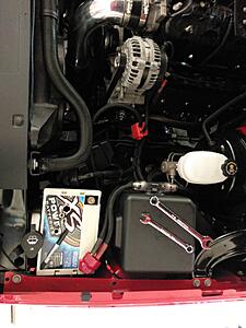

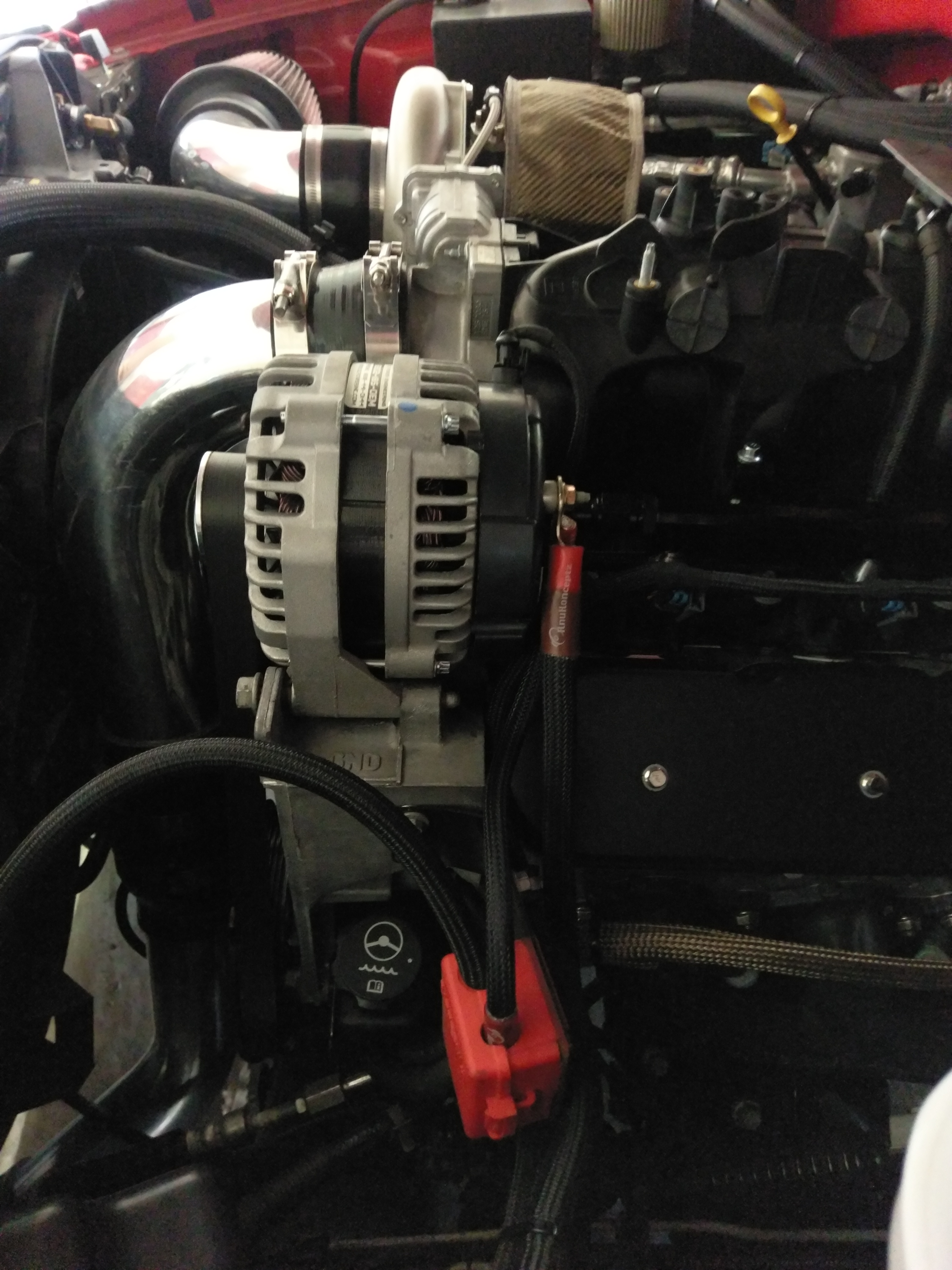

While I'm waiting for my battery charger, I tackled the alternator wires I've been wanting to do for a while. Here's how it looked before with just a 4ga to the junction box
ILuvJDM's 2007 NBS RCSB Build - Turbo/4L80e/Coilovers/Wilwoods-pnpreiz.jpg
Made a new 4ga wire that is routed better
ILuvJDM's 2007 NBS RCSB Build - Turbo/4L80e/Coilovers/Wilwoods-wbjswvg.jpg
It's more tucked in now, and I also ran a 1/0 straight to the battery
ILuvJDM's 2007 NBS RCSB Build - Turbo/4L80e/Coilovers/Wilwoods-y3wyh3r.jpg
ILuvJDM's 2007 NBS RCSB Build - Turbo/4L80e/Coilovers/Wilwoods-ahatbwm.jpg
I need to order more red heatshrink for the battery side, but I can do that later
ILuvJDM's 2007 NBS RCSB Build - Turbo/4L80e/Coilovers/Wilwoods-zpq2vw3.jpg
