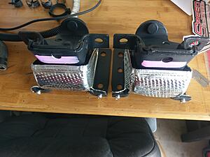

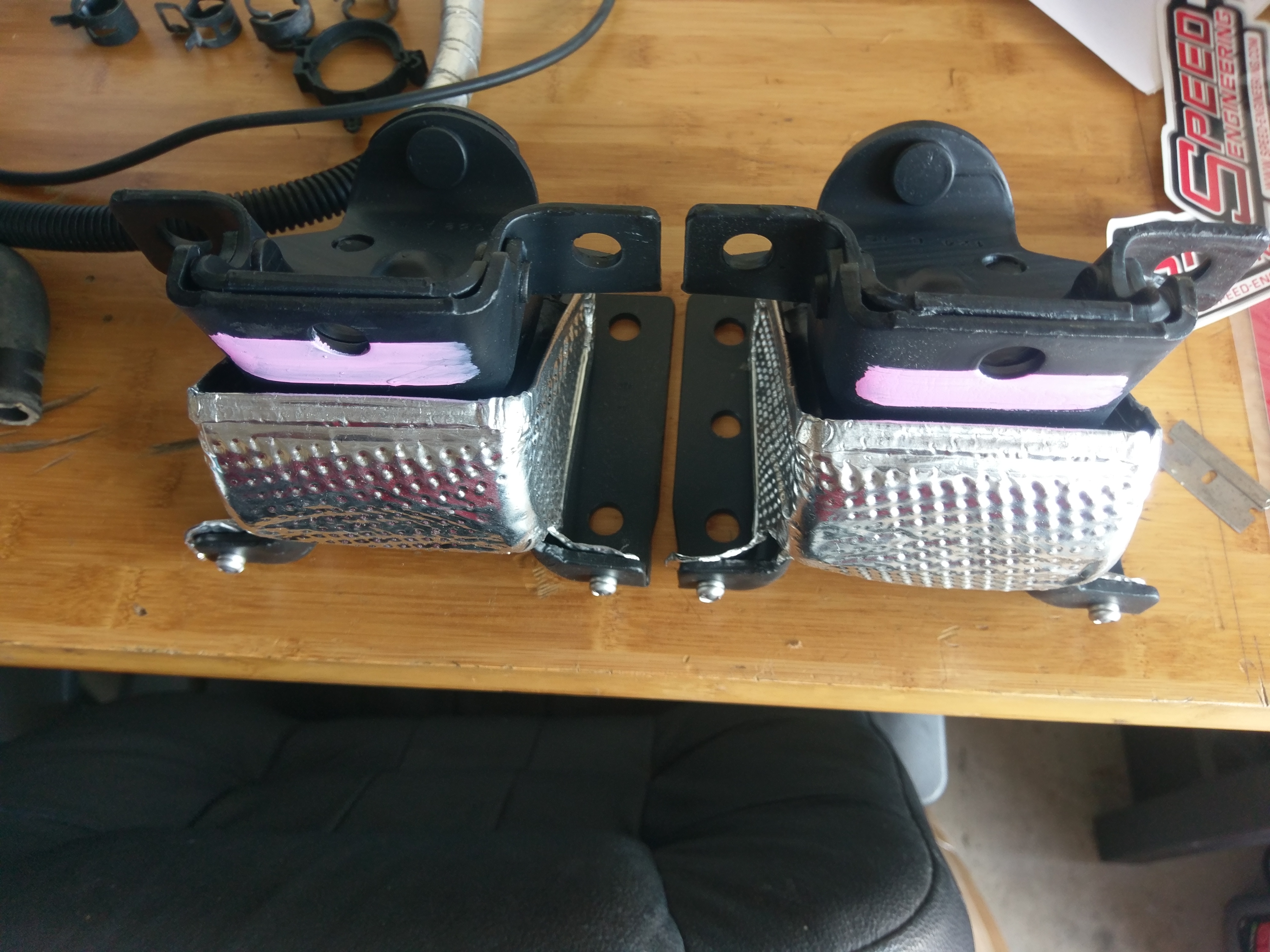

Engine mounts and LTs showed up today. Didn't feel like working on it but I'll try to get to it this week.

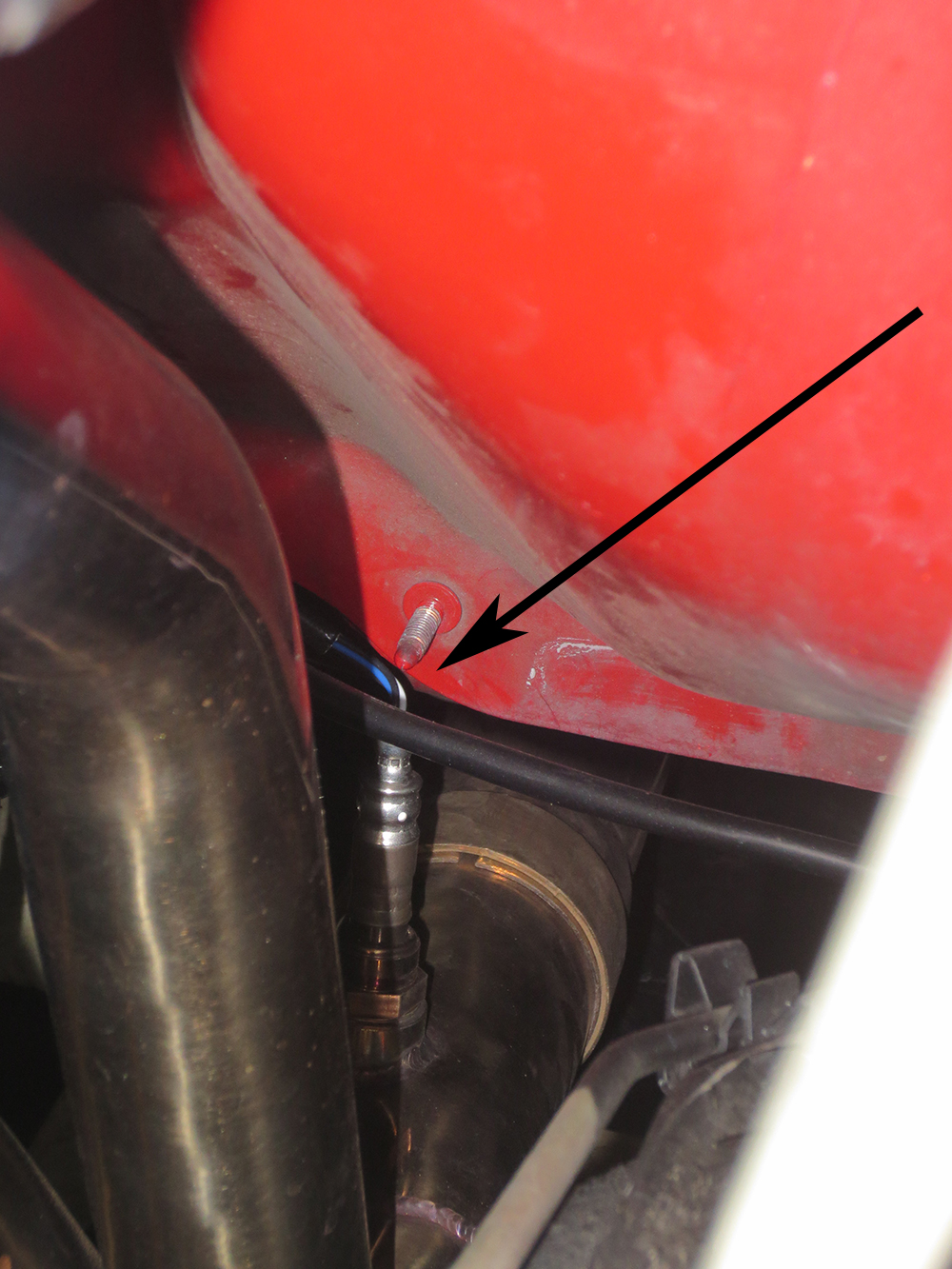

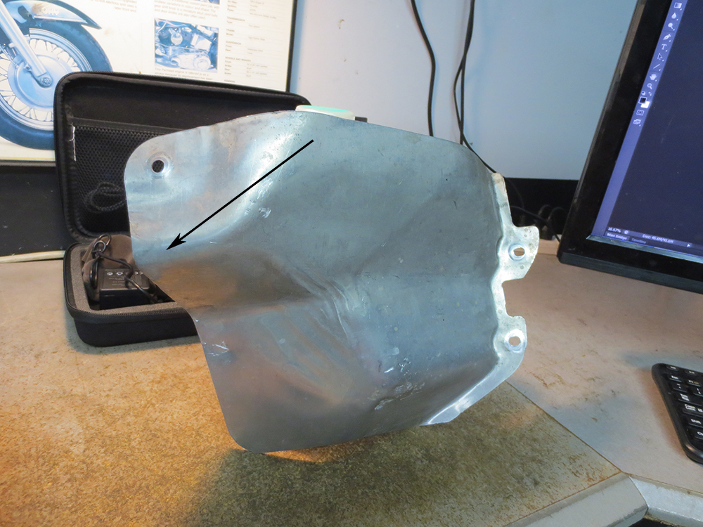

Just a heads up on the headers...
I had to remove both aluminum heat shields on the bottom of each side of the firewall for the SE headers to fit on my 2000. Didn't want to but had to anyway lol. I had the plastic wheelhouse's out at the time and the install was really easy.

I'd probably put some LED's in the air box then lightly tint the plexi cover... flashy when on and subtle when off
You might get lucky with the shields but wasn't the case for me. On the drivers side you also have a clearance issue with the narrow band o2 sensor wires. The heatshields are formed to extend away from the firewall leaving an air gap between the two. If you have a pair of sharp snips or a band saw you could mask off the aluminum and easily clearance for that o2.
That black cable is my AEM wideband coming from the crossover pipe.
