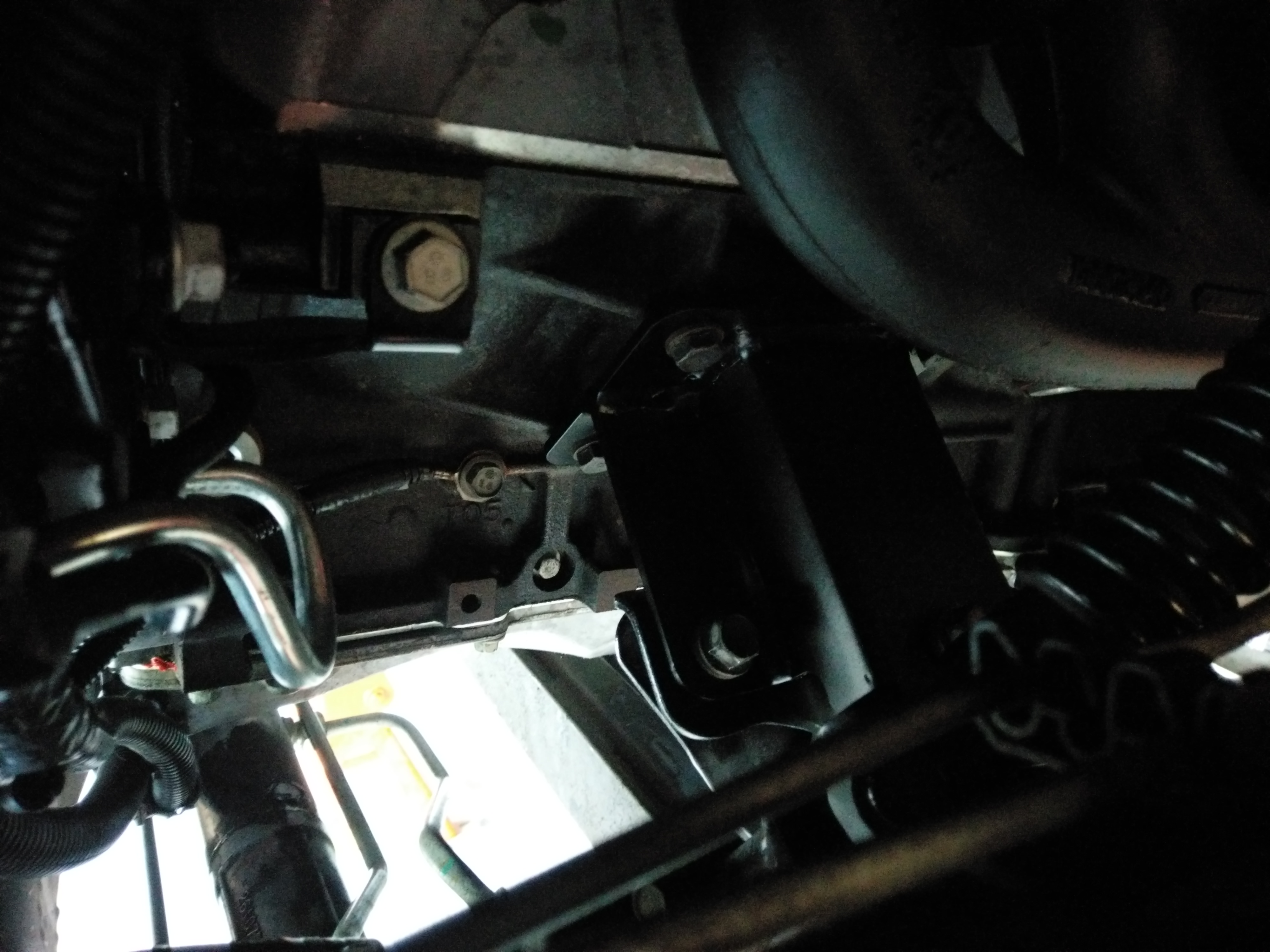

I don't think I ever posted these, but I put in my solid motor mounts from a member on here. Had them powdercoated when I did my turbo hot parts and flip kit
ILuvJDM's 2007 NBS RCSB Build - Turbo/4L80e/Coilovers/Wilwoods-ivvi5e3.jpg

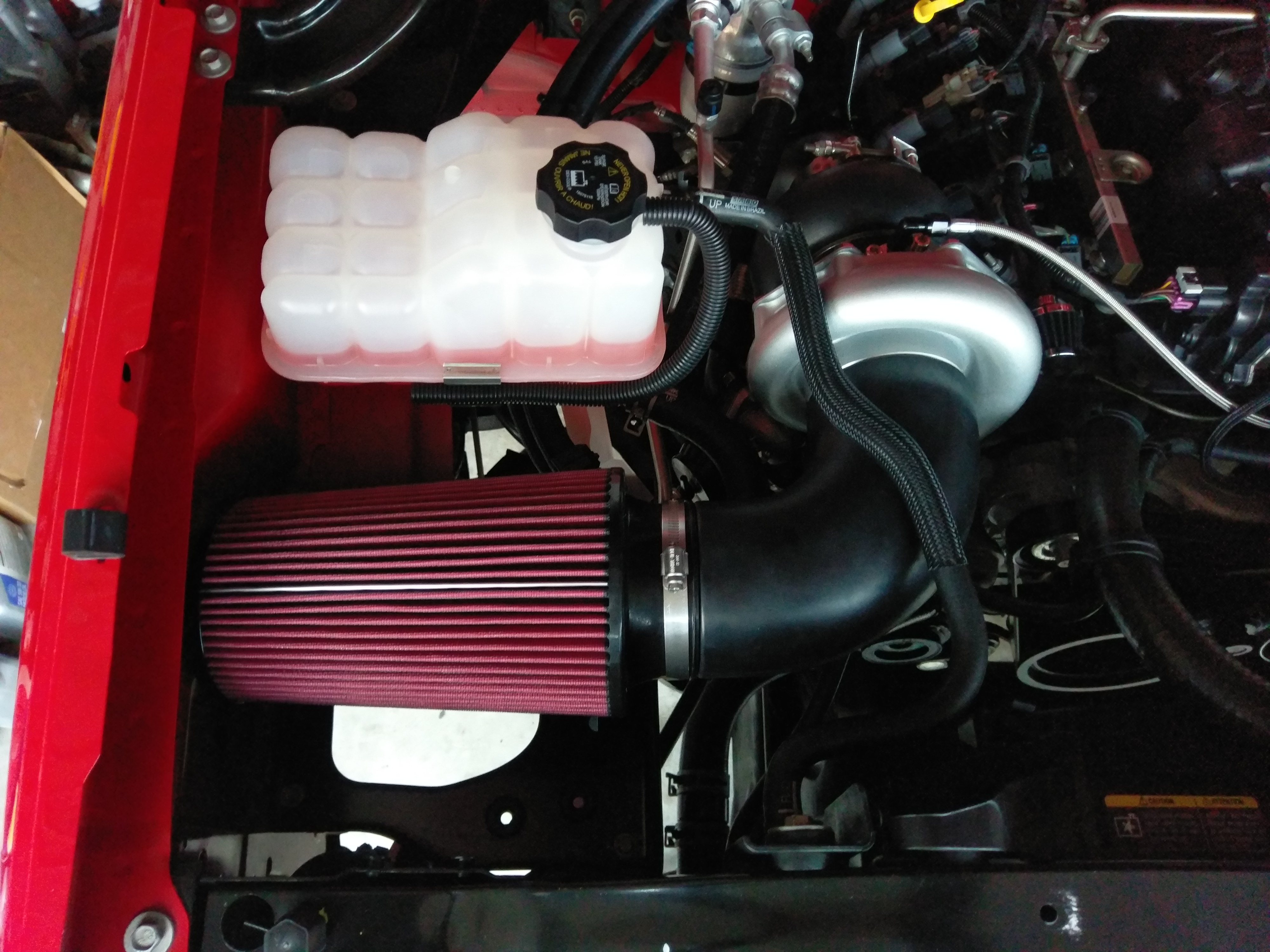

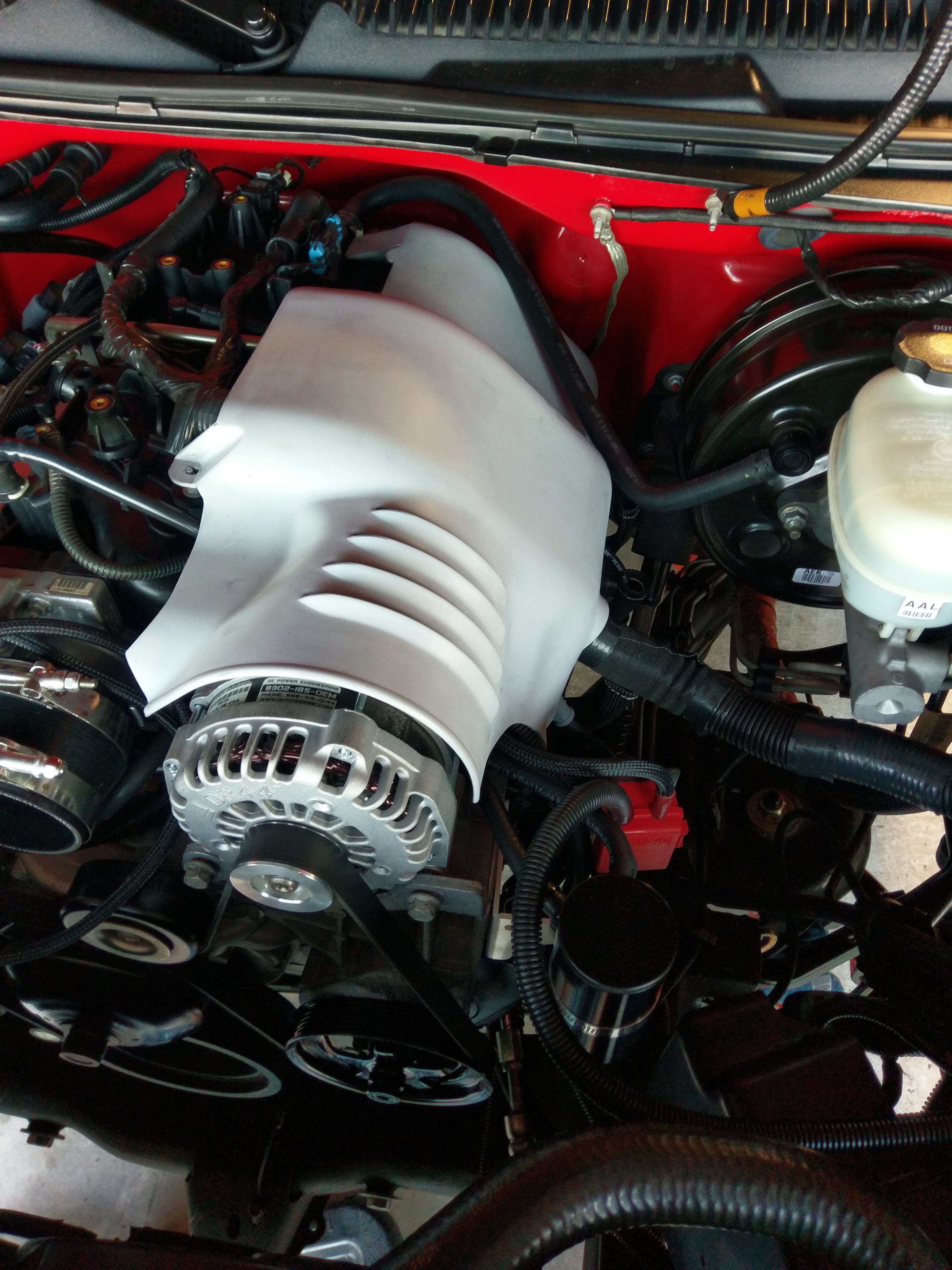

Got my catch can installed and routed in a way I can still run the 3 piece covers
ILuvJDM's 2007 NBS RCSB Build - Turbo/4L80e/Coilovers/Wilwoods-m62ga0d.jpg

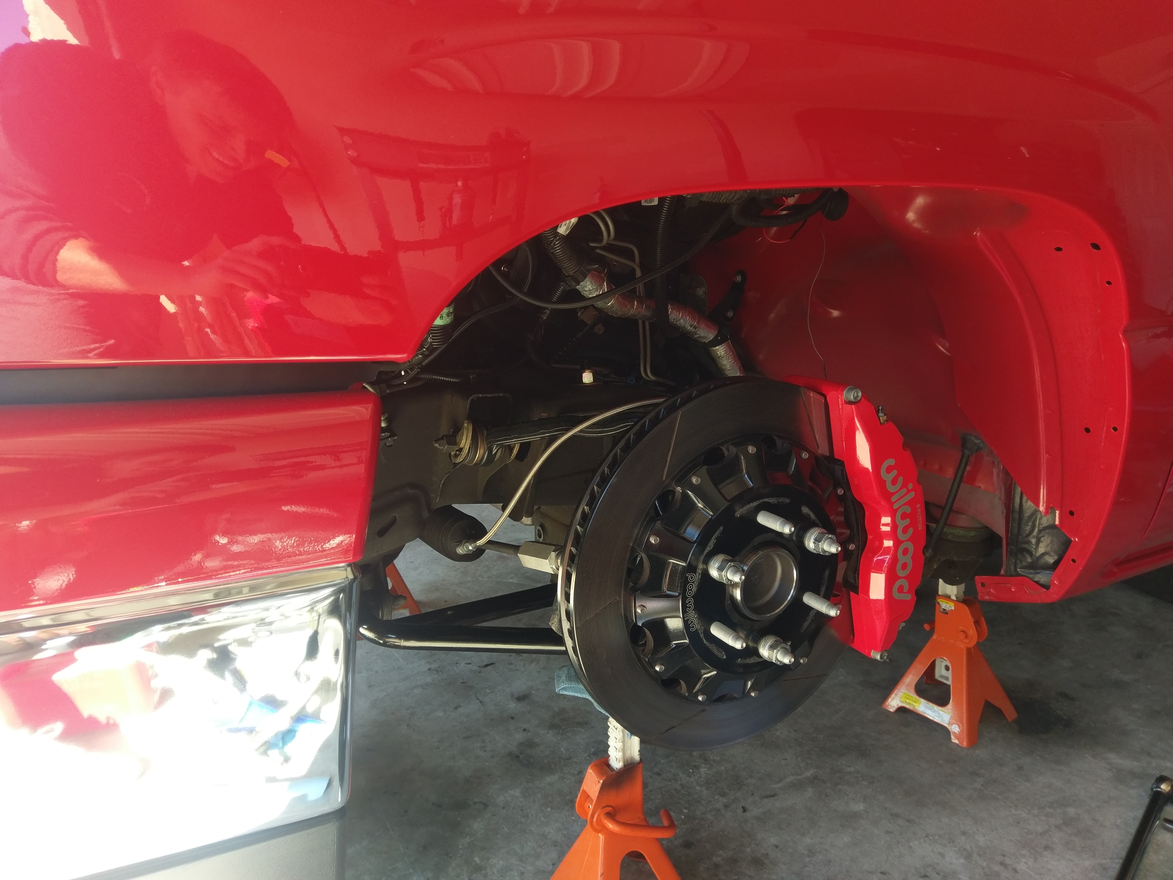

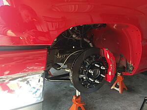

Also installed all the front suspension and Wilwoods today. Only think I'm missing at this point is the actual coilovers. I do need to order the 2wd brake hoses since the ones I had for my torsion bar truck don't fit now
ILuvJDM's 2007 NBS RCSB Build - Turbo/4L80e/Coilovers/Wilwoods-ok5cpob.jpg

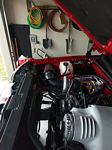

Not too much to post, but I ordered some odds and ends:
-Wilwood brake lines for 2wd
-3ft relocation hose for my fuel pressure sensor so I can remote mount it on the firewall
-New AC line since this one is leaking

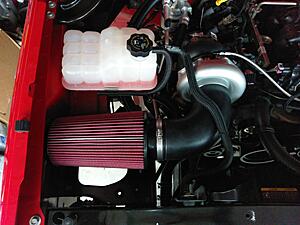

-Installed the filter and elbow that comes with the kit, but it's not my style. I ordered a polished aluminum elbow with similar dimensions and a straight silicone coupler. This should match the polished charge pipe tubing that enters the throttle body. Should look nice
ILuvJDM's 2007 NBS RCSB Build - Turbo/4L80e/Coilovers/Wilwoods-lrw72tr.jpg
ILuvJDM's 2007 NBS RCSB Build - Turbo/4L80e/Coilovers/Wilwoods-5jmxdb6.jpg
ILuvJDM's 2007 NBS RCSB Build - Turbo/4L80e/Coilovers/Wilwoods-hs1bzp0.jpg
