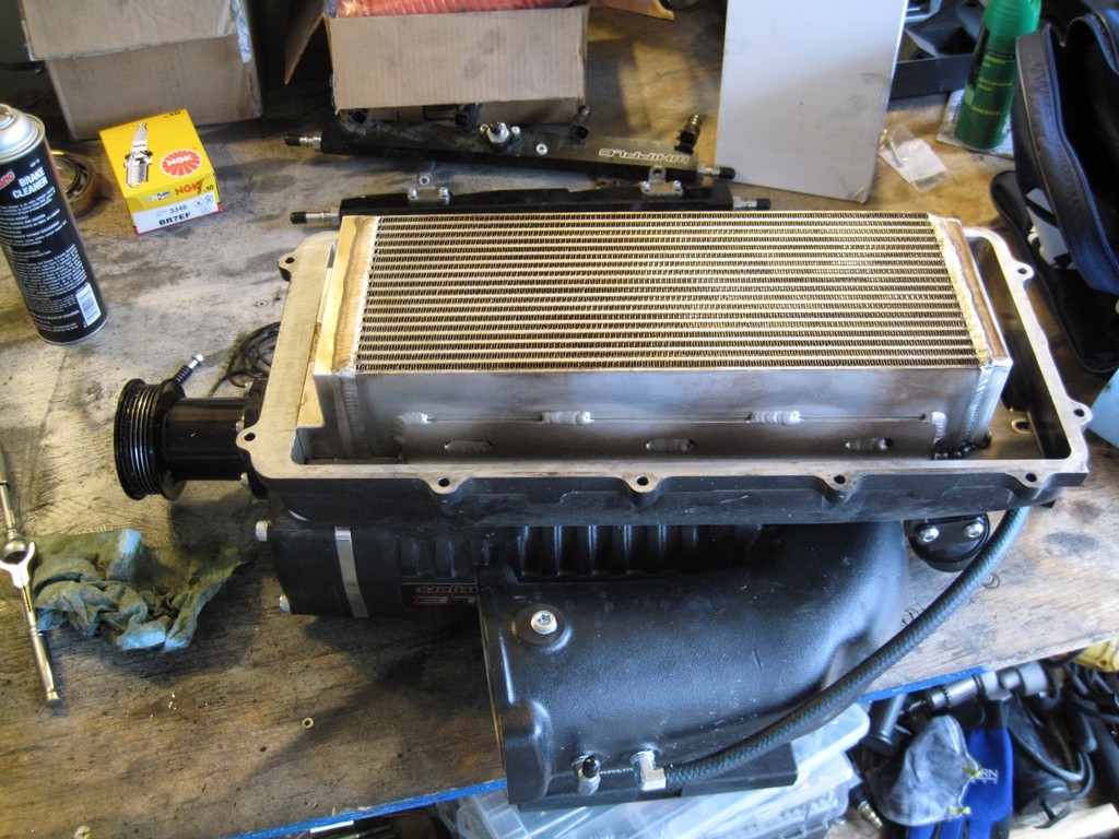

For those that vote race truck, feel free to donate money for a TT BBC, trailer, and tow truck!
Heres some pics of the blower and the intercooler, kind of cool. Also got my 8 rib pulley in the mail yesterday, looks sweet! Big thanks to mike at New Era for the help!

it's amazing how small the outlet from the screws is, after all the work with bigger throttle bodies and huge intakes, just to have a 2 inch triangular hole in the end.
Old Mar 19, 2015 | 03:09 PM
  #746
Atomic's Avatar
I have a gauge for that
Posts: 16,282
Likes: 438
Yea it is pretty suprising. The outlet size determines the internal compression ratio of the blower. The larger the hole, the lower the compression ratio since the air has less length of the rotor path to compress. A lower compression ratio is better for lower boost, generally 0-15psi, and a higher CR is better for high boost, 15-30psi. Most bigger blowers have 2 or 3 different configurations for a given blower.

I finished porting the lower manifold and painted it black. Not sure how much the porting will help but I feel better about it. I bought a new cam, one of the ones TSP was selling super cheap, its a 218/239 115 I think. Should work better when that time comes, but im still curious to see what my current cam feels like with the blower.
I got a 102mm tb off ebay ($100) that I am very happy about, it looks really nice. The body is a billet piece and it mates up almost perfectly to the ported inlet on the blower. I also bought some stuff to make a 6" inlet to the blower using the filter I had on my turbo for a while, that will look funny haha.
