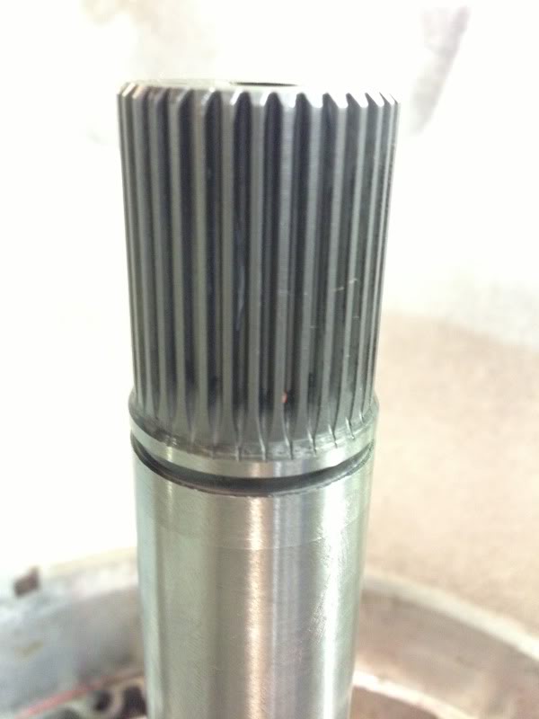

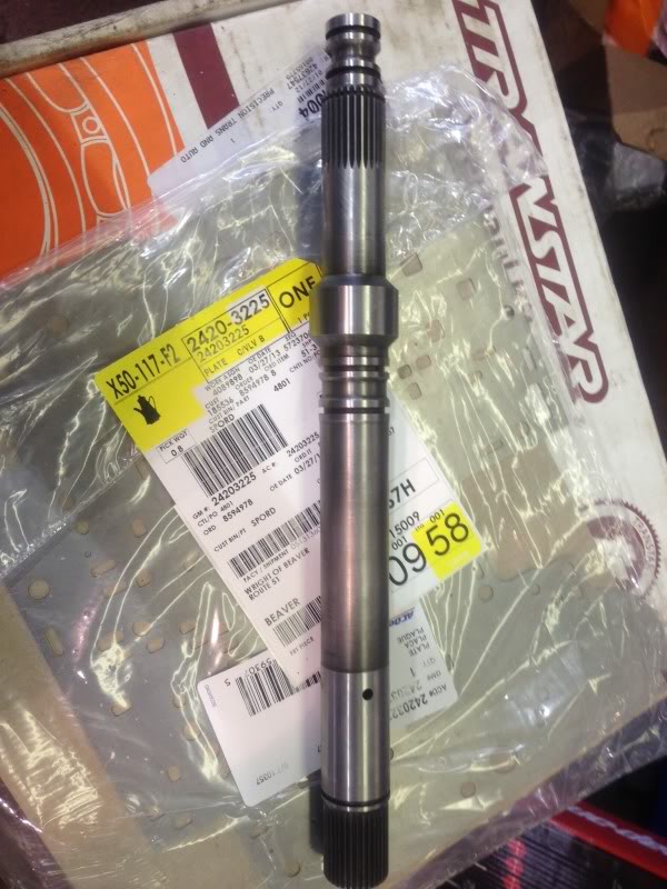

It's not hard to see on the stock one where the weak point is. Majority of Billet shafts still have this machining design. This week point is also where they all break. The CK one eliminates this.

Thats a fine looking shaft you have there, Pat

On CK's webpage, they have their regular competition shaft rated to 1000hp/1000tq and then a super comp shaft rated to 1500/1500. Pat, is that their regular competition shaft?

Mines the 1500 one. 300m
I have some of their other goodies as well.
