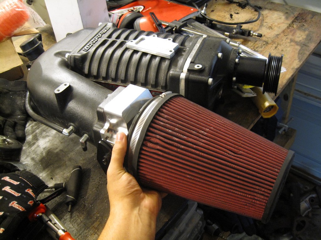

Heres one of the filter and 102mm TB, looks pretty cool but I may need to move it out some. Pretty sure a 6" filter and pipe will never be a limitation haha

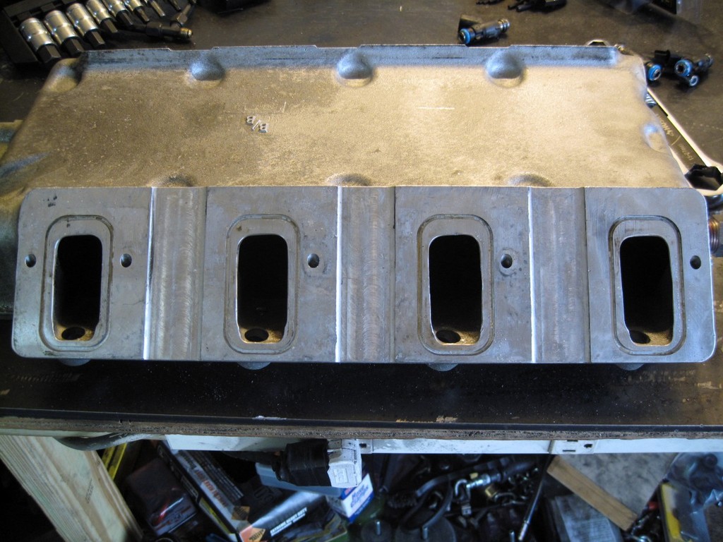

Heres some of the porting, this is the stock lower:

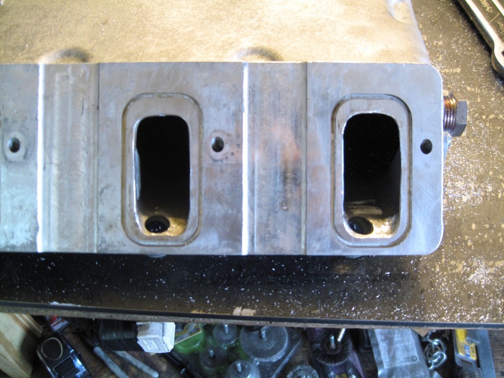

Notice the little casting things on the bottom left corner. I opened it up some and smoothed out that region. There was also a lip on the left side I smoothed out.
Notice the right side port.
