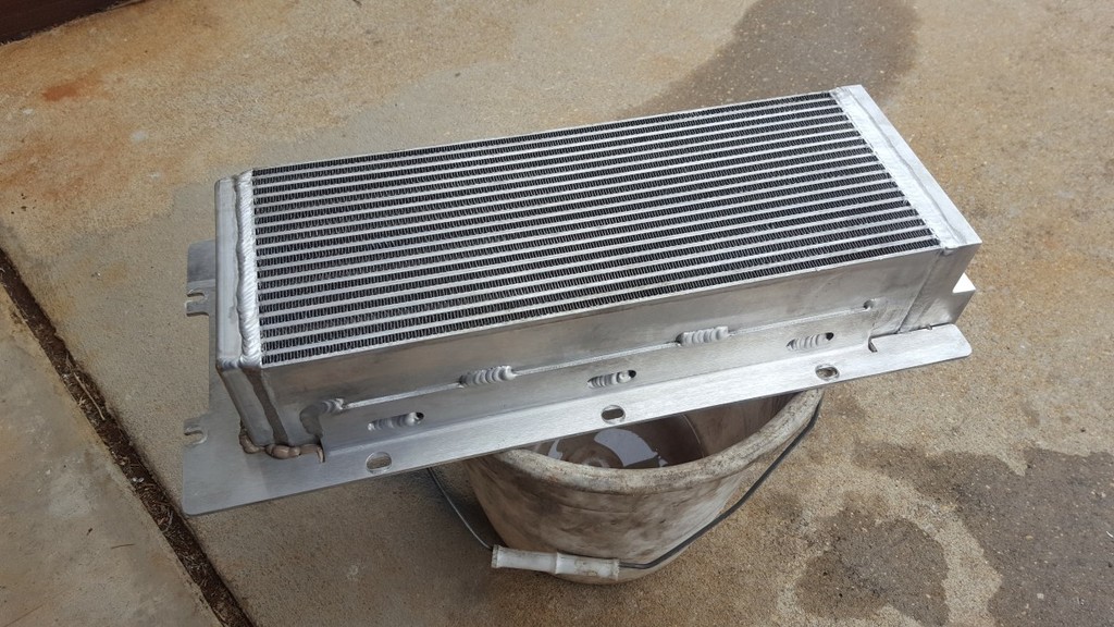

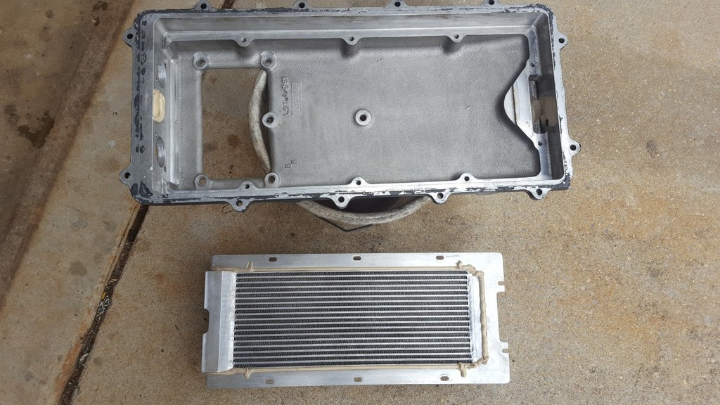

Anyway, after a couple cans of carb cleaner and a pressure washer I have the cleanest intercooler and top manifold in the history of oil soaked whipple parts. I believe there may have been residual oil in the gap between the intercooler and welded on bracket on the side. Also possible under/around the silicone on the intercooler. Thats what im going with anyway to explain where it came from.

I got my -12an to -8anO fittings in and very interestingly they had different IDs...they are vibrant brand. I drilled them both out to 1/2" ID so they are the same now, but I had to take a lot more off of one than the other. They are now slightly larger than the stock whipple fittings (which were also drilled).
