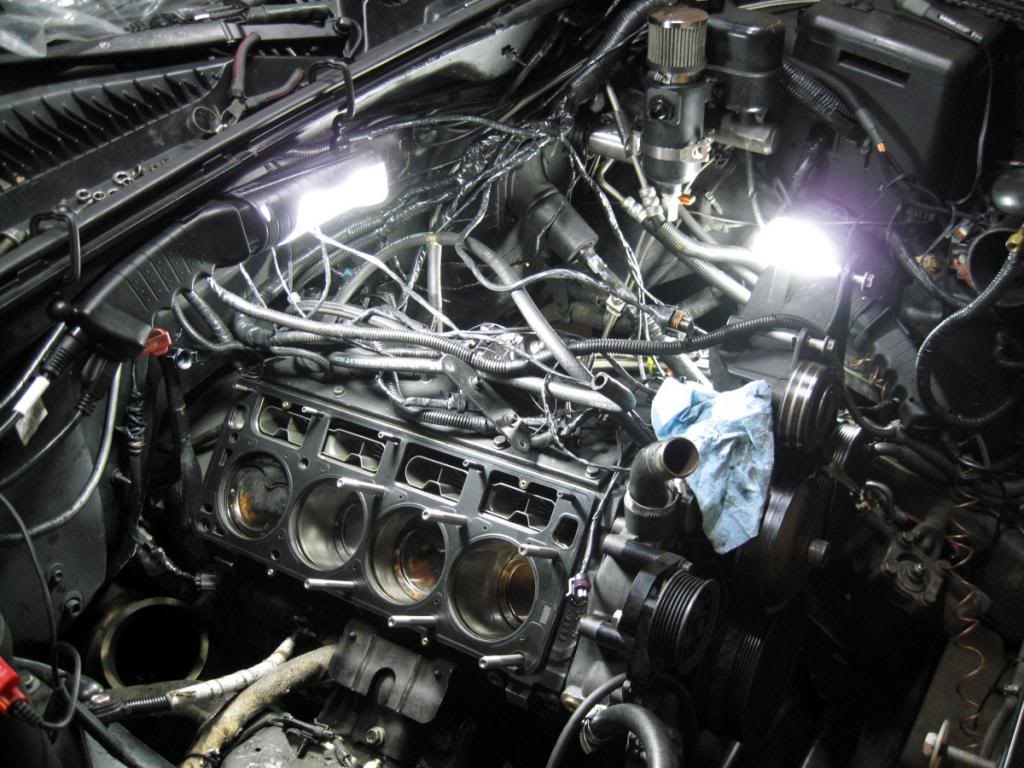

Custom headgaskets:

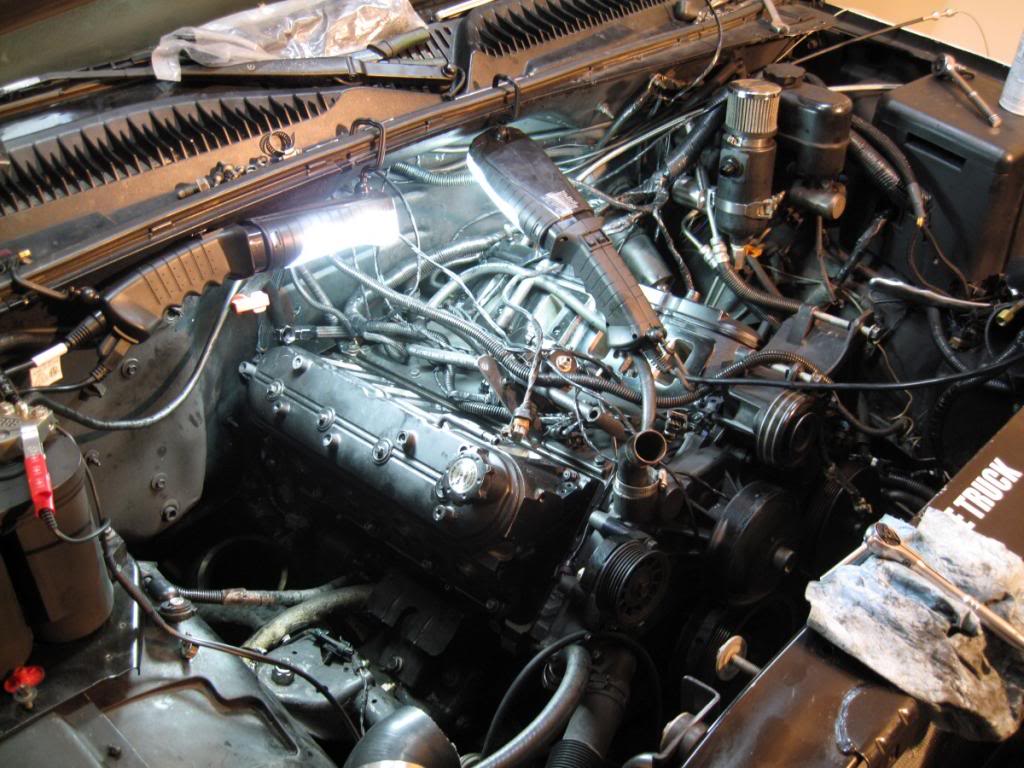

As it sits right now:
Turbo is a BW S400 82mm compression, 96mm turbine, 5" dp, 1.32 housing I think. Runs roughly 20-22 psi right now. Maxed out is only about 25-26psi and ~1200rwhp
The only thing powdercoated is the compressor cover and coolant tank. Everything else is either high-temp bbq grille flat black (the heads) or generic 99 cent home depot flat black. Looks really good in person honestly.
You may notice the new custom battery paint job haha
Also interesting to note is the factory ground cable is a perfect fit for the starter as a power wire with the battery in the secondary spot on the passenger side.
