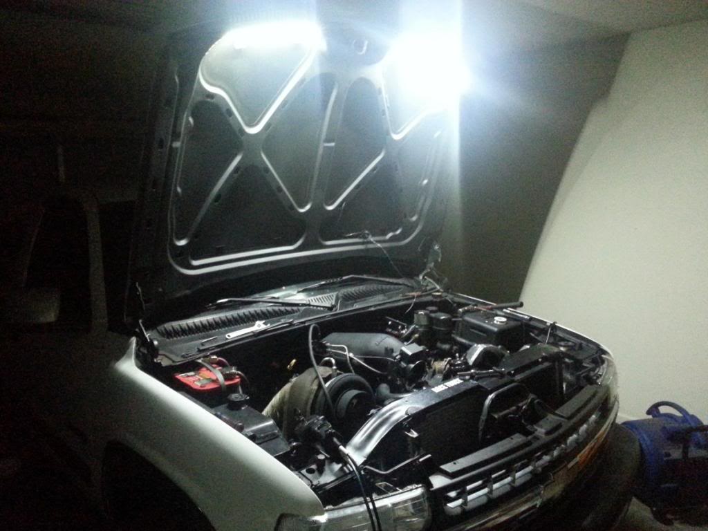

I upgraded the underhood lighting and holy ****, these are 10 times brighter than the ones that were there, I think they are brighter than my worklight

Dayum. You better get SPF 45 if you plan to work under the hood
