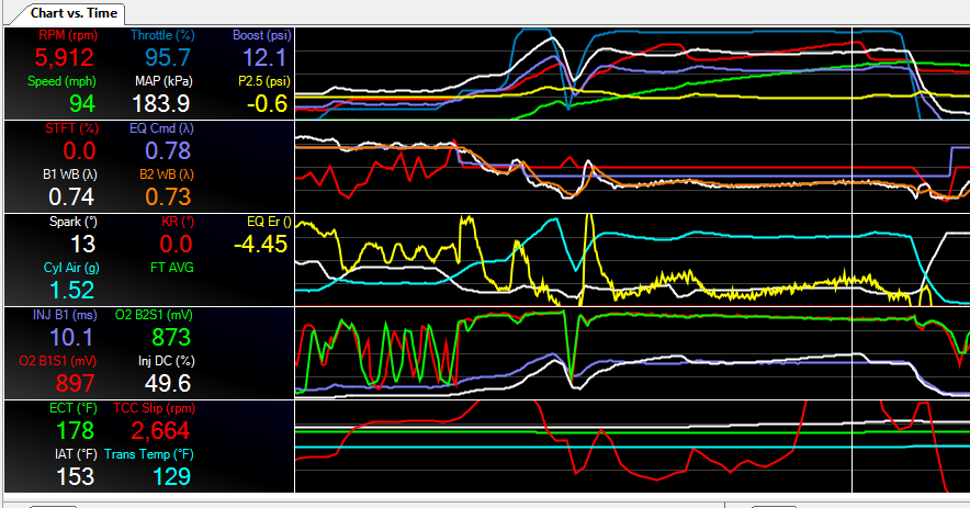

Well got to the track last night with the new gates, it looks like they are working great! Also installed the pressure sensor between the turbos and supercharger in the charge pipe. It looks like I was right and in that there is vacuum between the blower and the turbos on transients, and during a run. Controlling the turbos in a tight window is going to be the challenge now since I want something between 6 and 10psi from them eventually. They light off surprisingly fast once I get the controller set, which I am still working on. I added a lot of fuel in the lower VE area and that cured most of my transient stumble delay issue.
The track was garbage last night, and I was only running the rear slicks and have done exactly *nothing* to the suspension wise from when I had it set up in 4wd, so I wasnt expecting to do wheelies or anything. Got 2 solid runs, had to peddle both hard. I am driving by basically looking at the boost gauge so I didnt realize this but by the end I am barely giving it 30% throttle
Here is a video, it does sound cool and even got some fire from the passenger side wastegate dump on the second run
This is a log of the gates wide open. The Yellow line in the top section is the sensor between the turbos and blower, essentially turbo boost. The purple/white line is blower+turbo.
Run 4, gates wide open
So as you see there is a slightly vacuum between the turbos and blower during this run, the turbos are basically just coasting along.
On the next run I lowered the gate activation pressure to around 13.5psi and increased the duty cycle from 40 to 60%.
Run 5, more aggressive controller settings
This one is more interesting as you can see the turbos working pretty well, but me being scared im only giving it ~37% throttle and it still makes 19psi, and a moment later the turbos are actually making more boost than the turbo+blower total, so I'm basically choking it with the throttle and the efficiency is garbage
