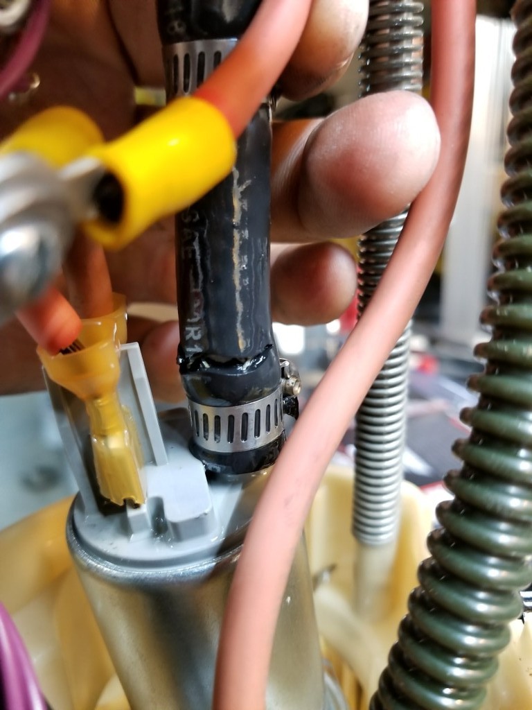

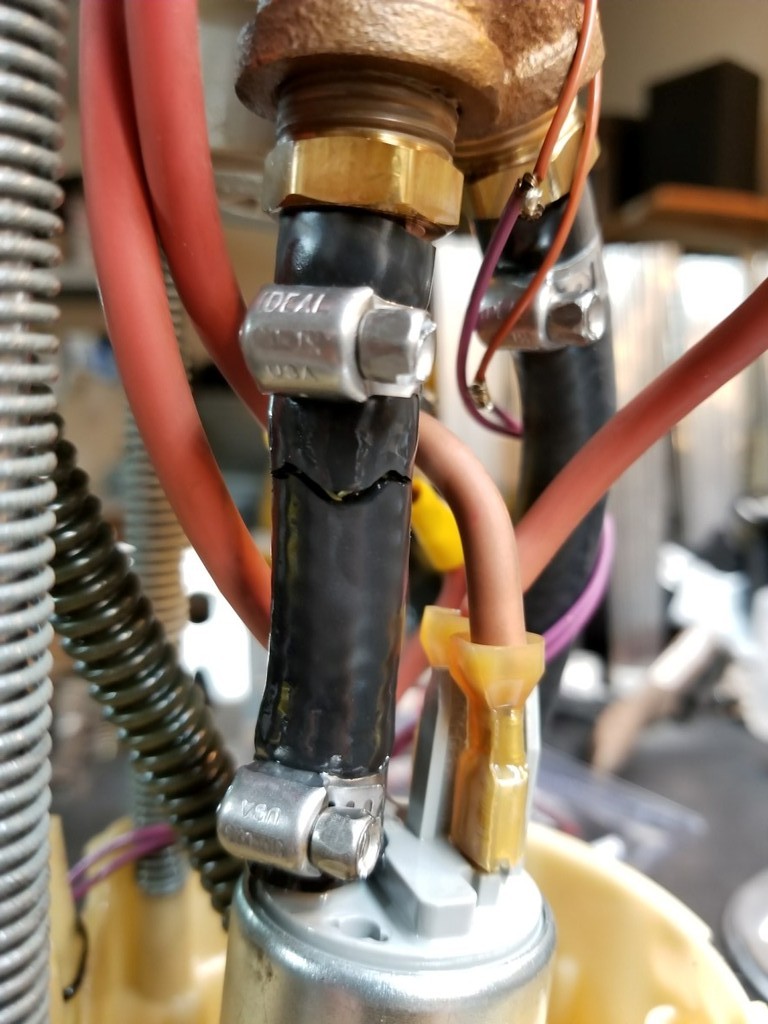

Well found my problem after the new diaphragm for the regulator didnt work. The only place left to look was in the tank. I am just not having good luck with hoses lately it seems.
This does explain the shower head I was hearing in the tank though.
The hose managed to split in 2 places at the same time. This is the nice $20/ft hose. The one right beside it looks perfectly fine so not sure what happened. Best I can figure when I took the feed hose end off the bulkhead it rotated it and tore it open. Mustve been about to fail anyway if thats what did it in.
Oh well, new hose should be here Thursday and I can finally put the bed back on.

what's wrong with using the OEM style plastic flexible line?
Old Apr 26, 2017 | 12:35 PM
  #1760
Atomic's Avatar
I have a gauge for that
Posts: 16,282
Likes: 438
I would if I could. That style is not very forgiving for barb sizes. I have tried it before but could not get it seated to the pump, even heating it. I measured the hose barb at 9mm, and they offer 8mm and 10mm hoses and neither work obviously.
To elaborate more, I think I know what happened. When I built the dual pump assembly I built it on the bench obviously so everything was extended. When installed in the tank I am guessing it had to compress which forced the failed 3" hose to twist slightly. Fine for years, but when my main feed line failed and I took the hose end off, I think I twisted the bulkhead some (not much), but enough to tear the hose near the barbs. I didnt take it out to look at it while replacing the main line, so here we are.
