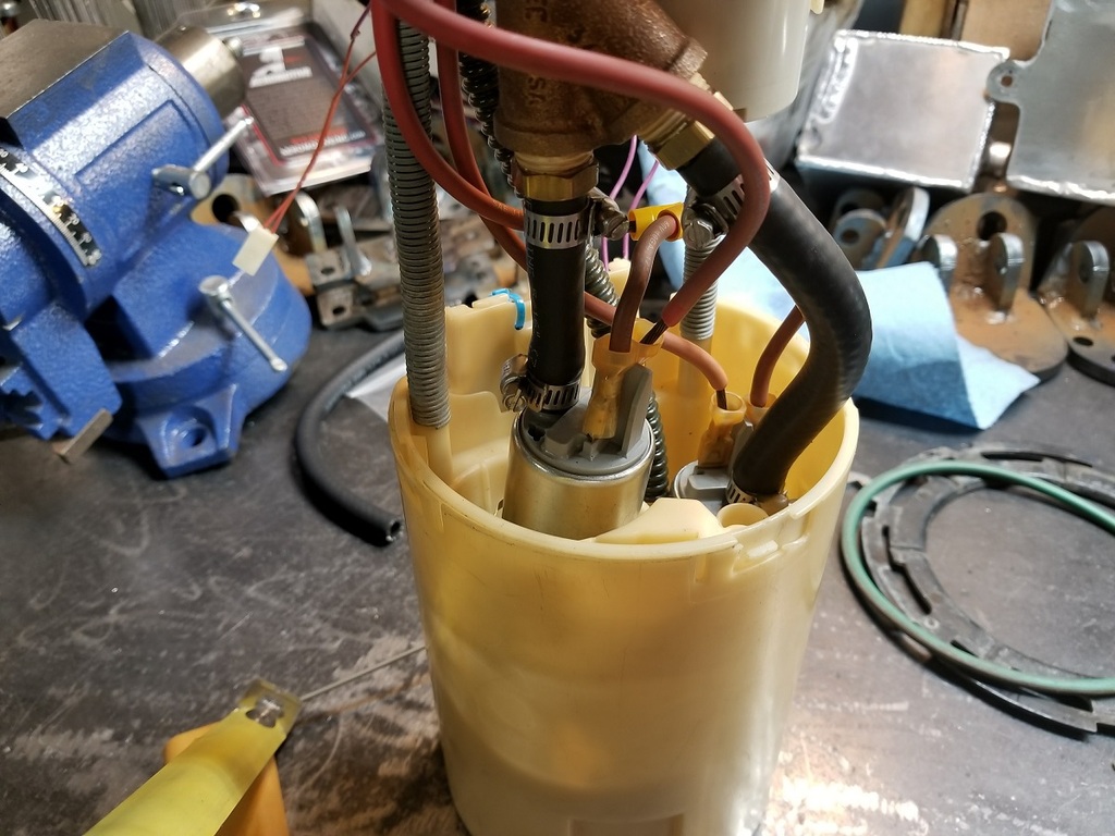

Got it fixed last night and made sure to compress it to the installed height first, ended up only needing a 2.5" section of hose to fix it. Straight shot from the pump to the barb. Its also funny just how big this bucket is. Tons of room in there for fluid to keep the pumps submerged. No external holes except for the flapper valves at the bottom. My setup is a bit bastardized, its an 05 bottom bucket with an 07 top in an 07 tank.
Installed and tested both pumps and everything is good now. Also got the reference line to the cutout ran to a vacuum block off the lower manifold.

No way to put a loop in that hose? Probably what I would have tried. Would have given you some room to play with.
