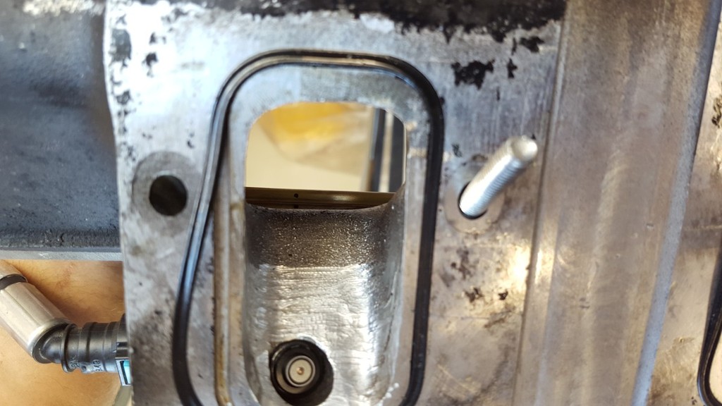

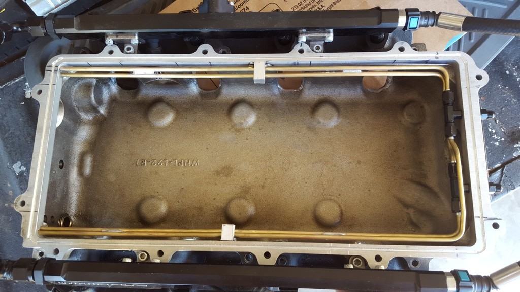

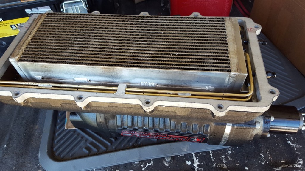

Got a chance to take the blower off and test fit the spray bar setup. Only ran into 1 snag with the tube hitting part of the intercooler but a little dremel work and all is good now. Replacing the fuel rail screws with some flat hex head ones makes more than enough clearance.
In the top part,
You can see the screws I was talking about here (bottom half),
I have some oil in the bottom of the lower manifold when I took the blower off, kind of pooled near the back. I am not sure where its coming from as my PCV vents to atmosphere and it cant come from anywhere else, so not really sure about that.

Looks good. Is it definitely oil from your engine? Or is it from the previous owner? Did you have it apart and clean before putting it on?
Old Apr 18, 2016 | 10:58 AM
  #1447
kbracing96's Avatar
iTrader: (26)
Posts: 9,485
Likes: 31
From: Oakland, OR
Probably entrapped in the intercooler from it's previous life would be my guess.
Old Apr 18, 2016 | 12:01 PM
  #1448
Atomic's Avatar
I have a gauge for that
Posts: 16,282
Likes: 438
Not sure if its from mine or not...I thought I hosed out the intercooler...maybe not.
