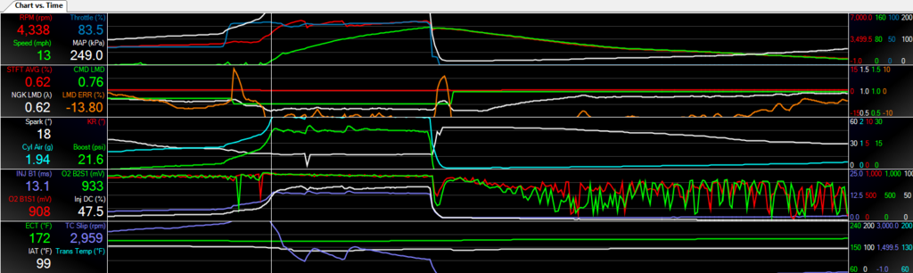

Just for fun, heres a clip of one of the last runs I did with the turbo. Looks like the converter stalls to about 4000 with that power level.
I havent messed with more timing, but you are right, if 17 was the limit at 23psi then I could probably run more at 12psi

I would say add more time down low until about 4k. Then 17-18 the rest of the way.
