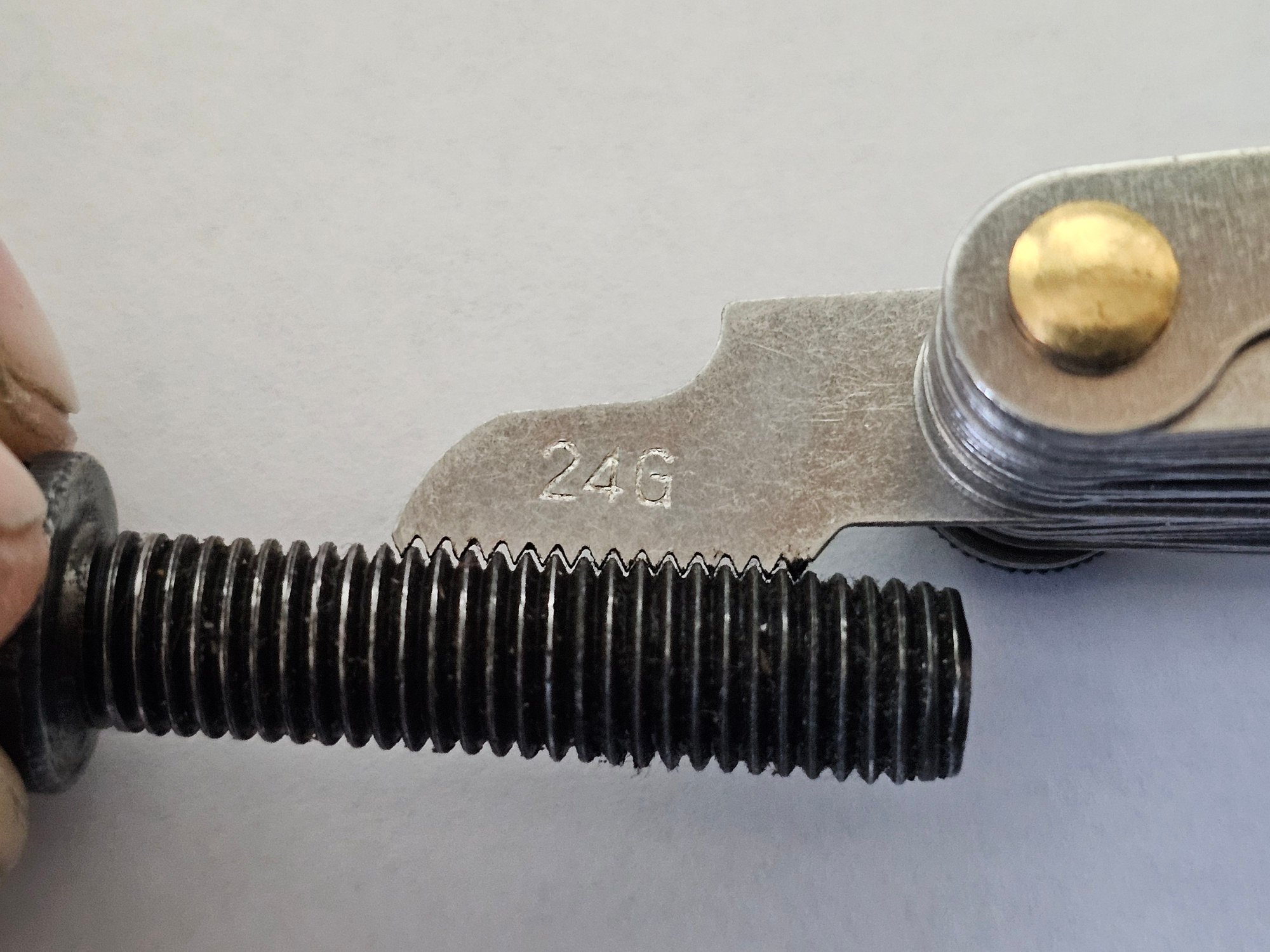

One of those thread gauges would be handy
They are not that expensive... these are just generic ones from KBC tools.

Well, bought the tool, it is indeed a 5/16-24 but with metric markings on the head and fits an 11mm wrench. Weird.
That is Classic China and there Chinese games....
