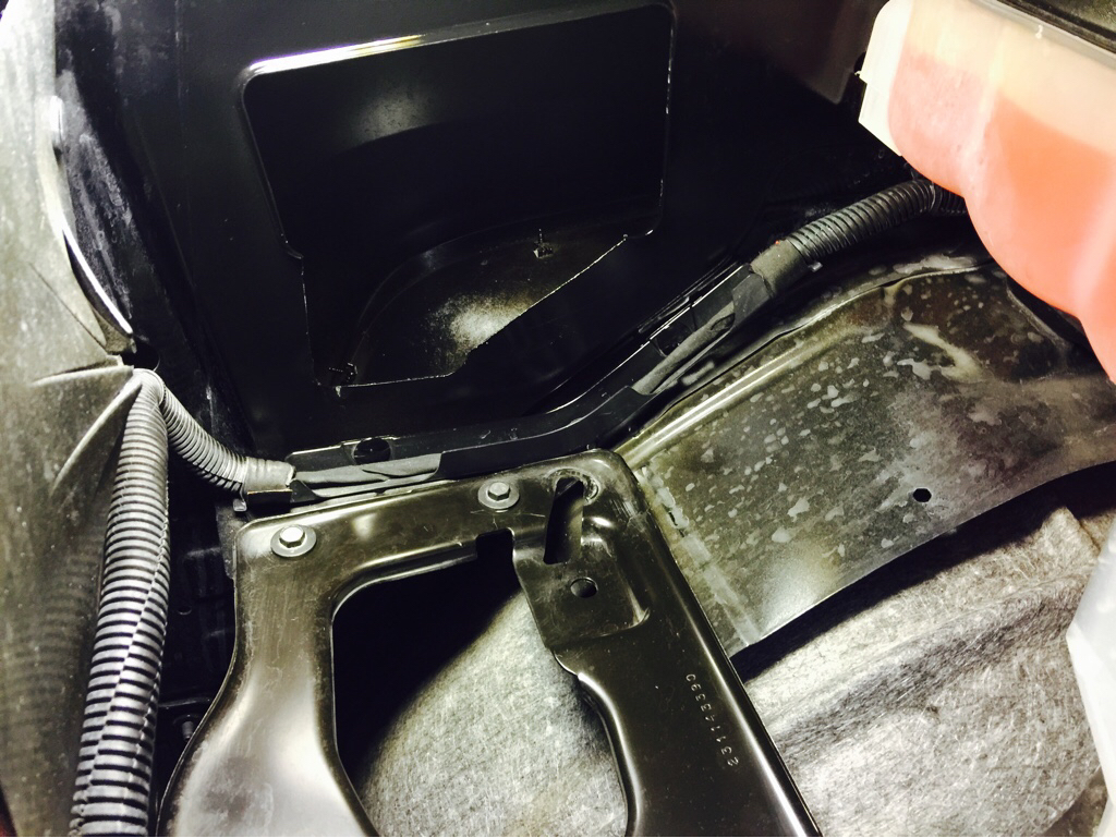

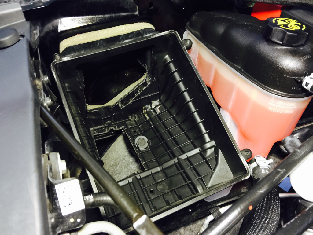

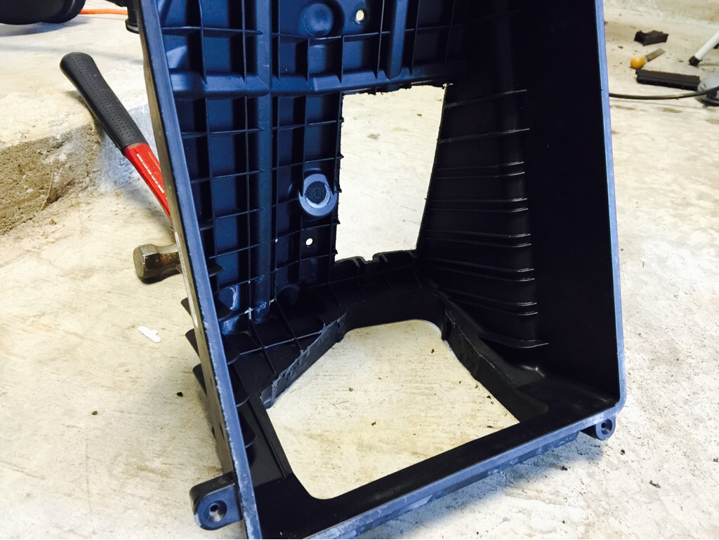

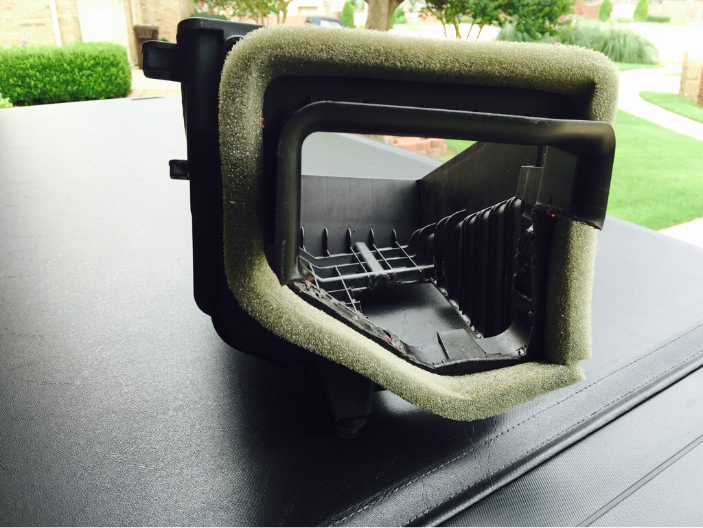

Air box mod complete.

what upper box/tube are you running? can't remember but for some reason my memory says it's the aFe?

No, just the Airaid MIT.

Looks good! Similar to how I cut my air box except I did an opening on the front side instead of the bottom.
