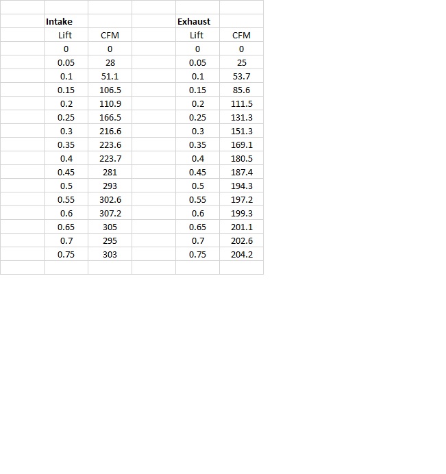

Little update: Heads have been flowed and assembled. The L92 head flowed pretty good for a stock casting in my opinion. Better than I anticipated for sure.

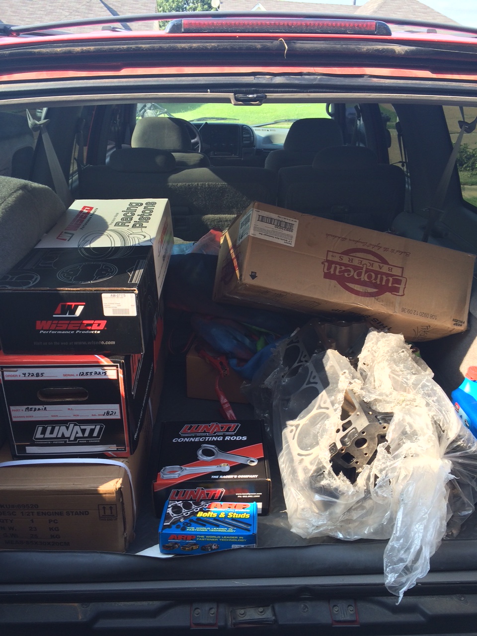

As of this morning I got the Burban all loaded up with block, crank, pistons, etc and headed over to start the assembly process. Still waiting on my head studs and head gaskets to get here. Got my oil pump other little stuff in. Ready to get the long block assembled!! Long time coming.
I attached the flow numbers from the test. We really didn't have to do it, but we were curious to do a before and after for when I decide to pull them and have them ported along with the blower.

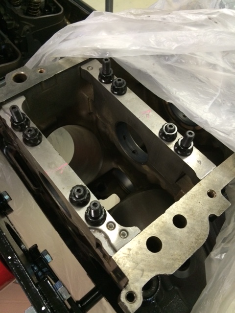

Threads cleaned out, bearings main caps and main studs installed. Cam is done, got oil pump, timing set, and stuff in and ready to go in finally. Getting closer and closer.

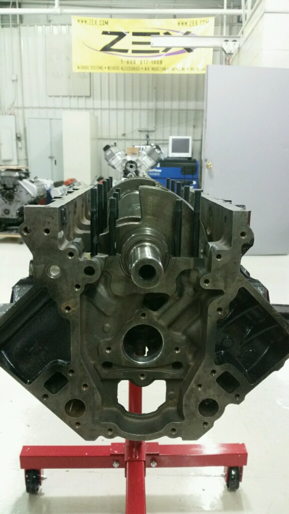

crank set in and measured for oil clearances. Head studs will be here monday with some nick nacks I'm missing like Head studs, head gaskets, front and rear cover bolts, etc.
