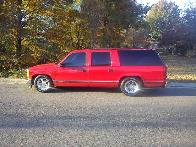

So a little update gents. The crank was saved!!! What initially looked burnt smooth up just needed a good hot tank bath and a little polishing and she is right as rain. Didn't take much of anything to balance it either. Had a touch of a holdup, as I got in a situation where I needed a new daily driver. I picked up this little gem which is by far the cleanest 96 i have EVER seen. The irony is that now, I've got a RED 96 suburban, a WHITE 85 C30 dually, and a BLUE '00 RCSB 'rado....... # generations of chevy's, red, white and blue..... 'MERICA!!!!
