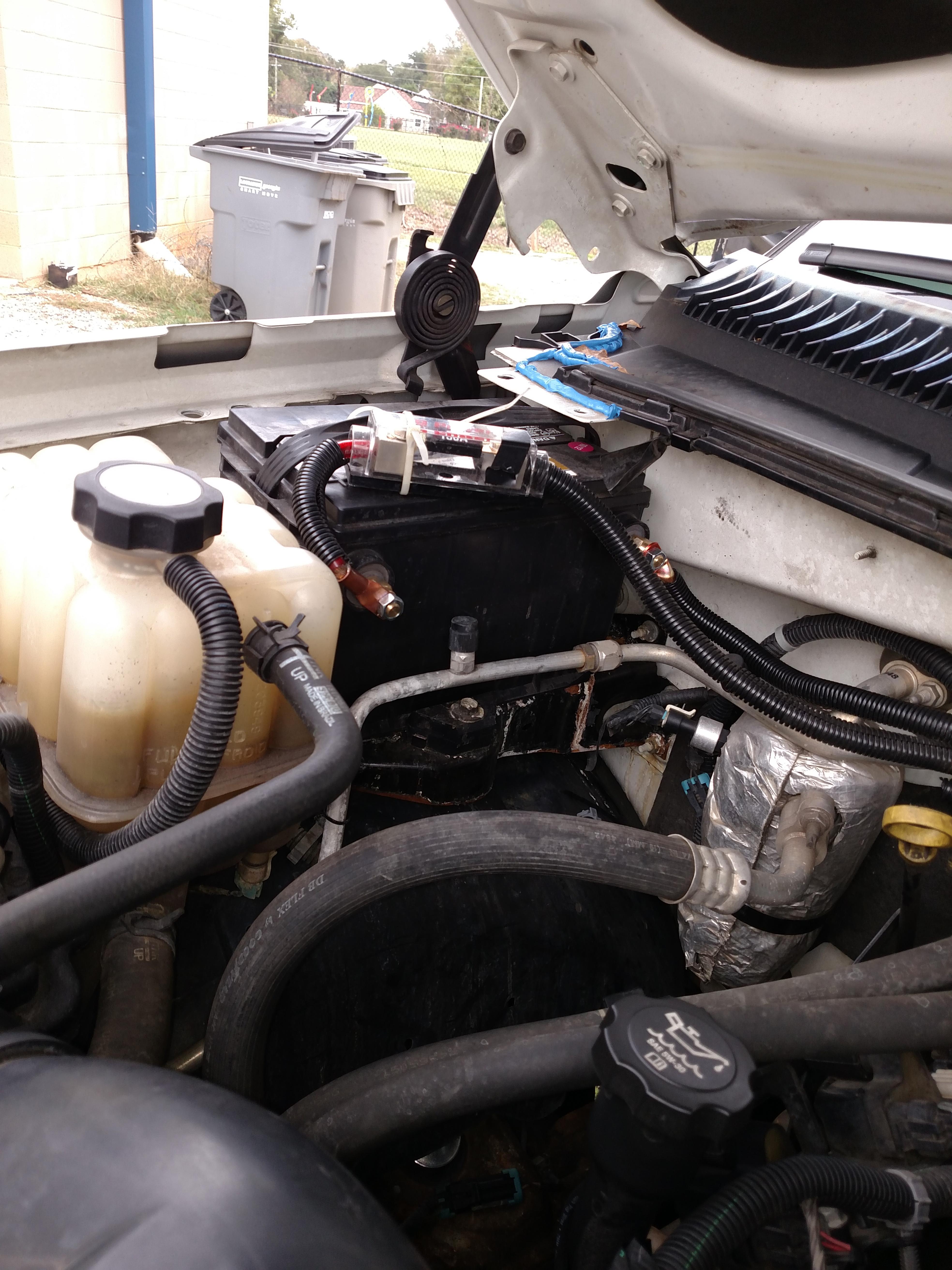

Since the supercharger makes the throttle body angle out towards the driver side headlight, and my air box is currently on the passenger side, I think I am going to move the battery to the bed and do a makeshift air box there behind the driver headlight. Or just make them swap sides, probably easier. Don't really give a damn about saving weight. Just want less work and stuff to fit right.
You could just mount your battery on the other side in the diesel secondary battery spot. Just make sure it is an AGM battery so rain water does not get into it like mine did.
