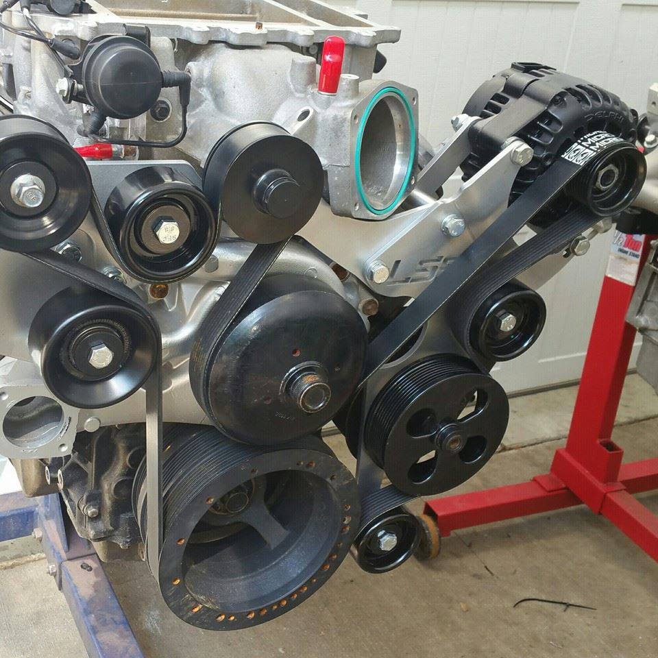

Hey what bracket and pulley setup are you going to run?
I'm looking at the new LS SIMPLE kit versus the GM performance $900 package.

I ran the ls simple setup converted to 8 rib running power bond damper 10% overdriven, innovators west ps and alt and a Lingenfelter solid coupler, and bolt on hub pulley setup can't remember the size there was one smaller I could get but can't remember, FYI your gonna have to run a 07+ water pump to clear actuator
This is what I'm pretty sure I'm gonna rock. His new 8 rib setup
