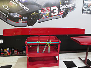

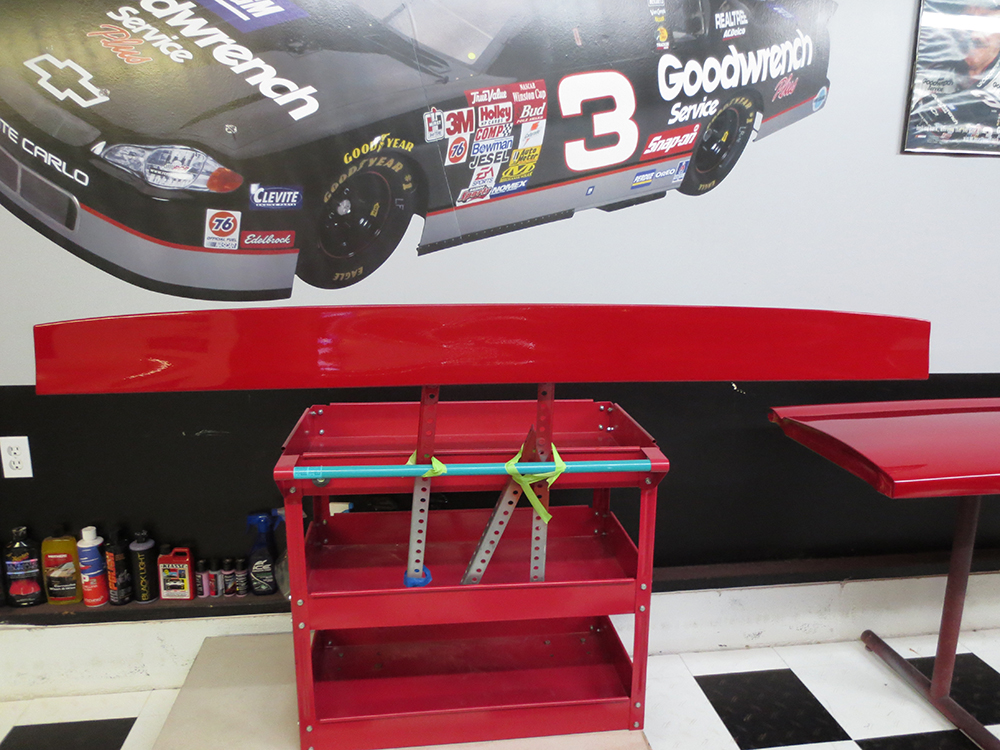

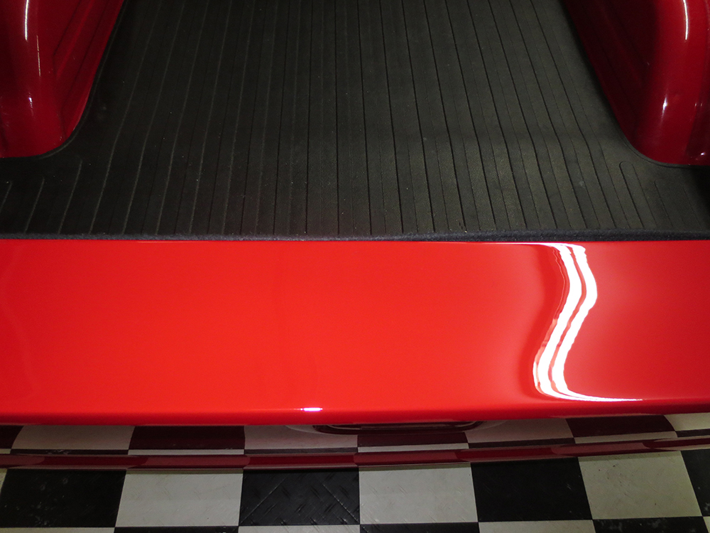

The SS spoiler is a good look but yeah not many options.
The first time I shot my tailgate I just filled the holes and it looked good but kinda plane looking. Ordered a re-pop RST fiberglass spoiler and the fitment was total garbage, so bad I didn't want to even try to repair, so I sent it back. The second I tried was a urethane spoiler from Street Scene. Loved the look but it was very wavy so I sent it back for a replacement. The replacement looked much better so I spent a couple hours prepping to remove the mold release agent contaminates so it wouldn't fisheye during paint.
Sticks on with double tape, I did run a couple small screws in from the bed side for insurance... eight years and still stuck on lol
