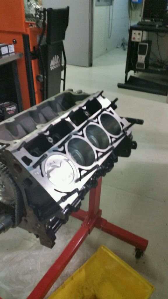

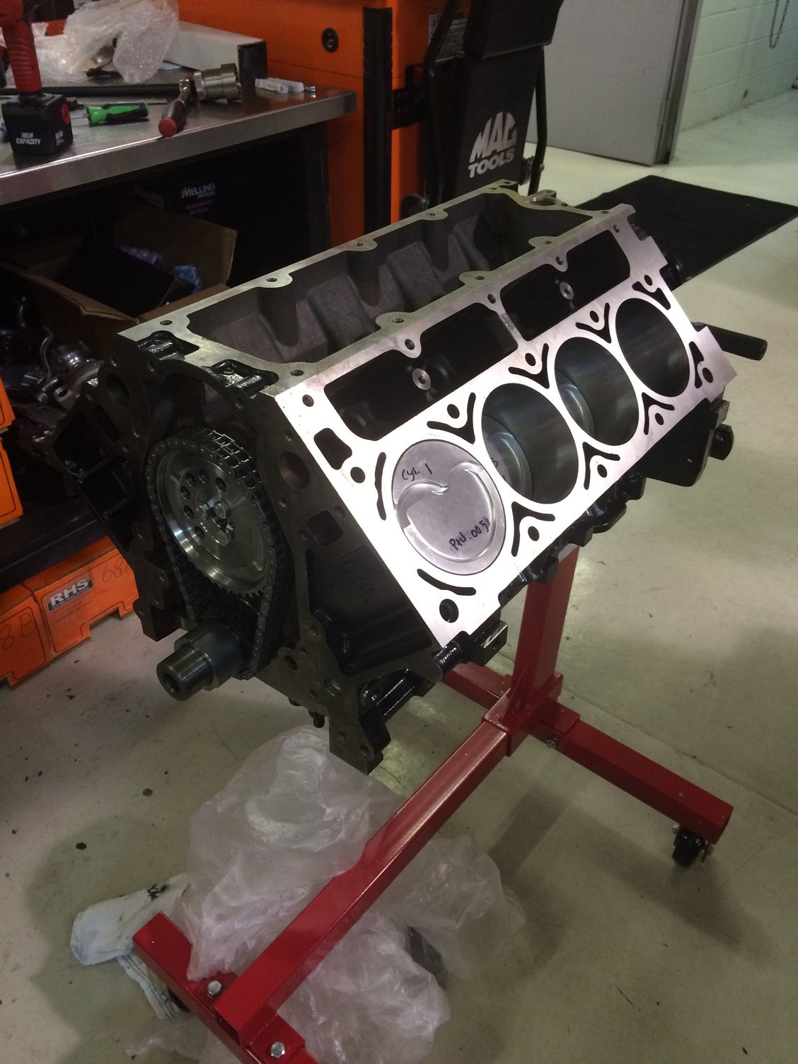

Alright, So it's been almost a month and we've had a few setbacks, mostly with time and money haha. But we are here. bottom end mostly assembled getting ready to check PTV once we chase the threads and put the head studs in. Teaser for now.

Looks like a nice shortblock

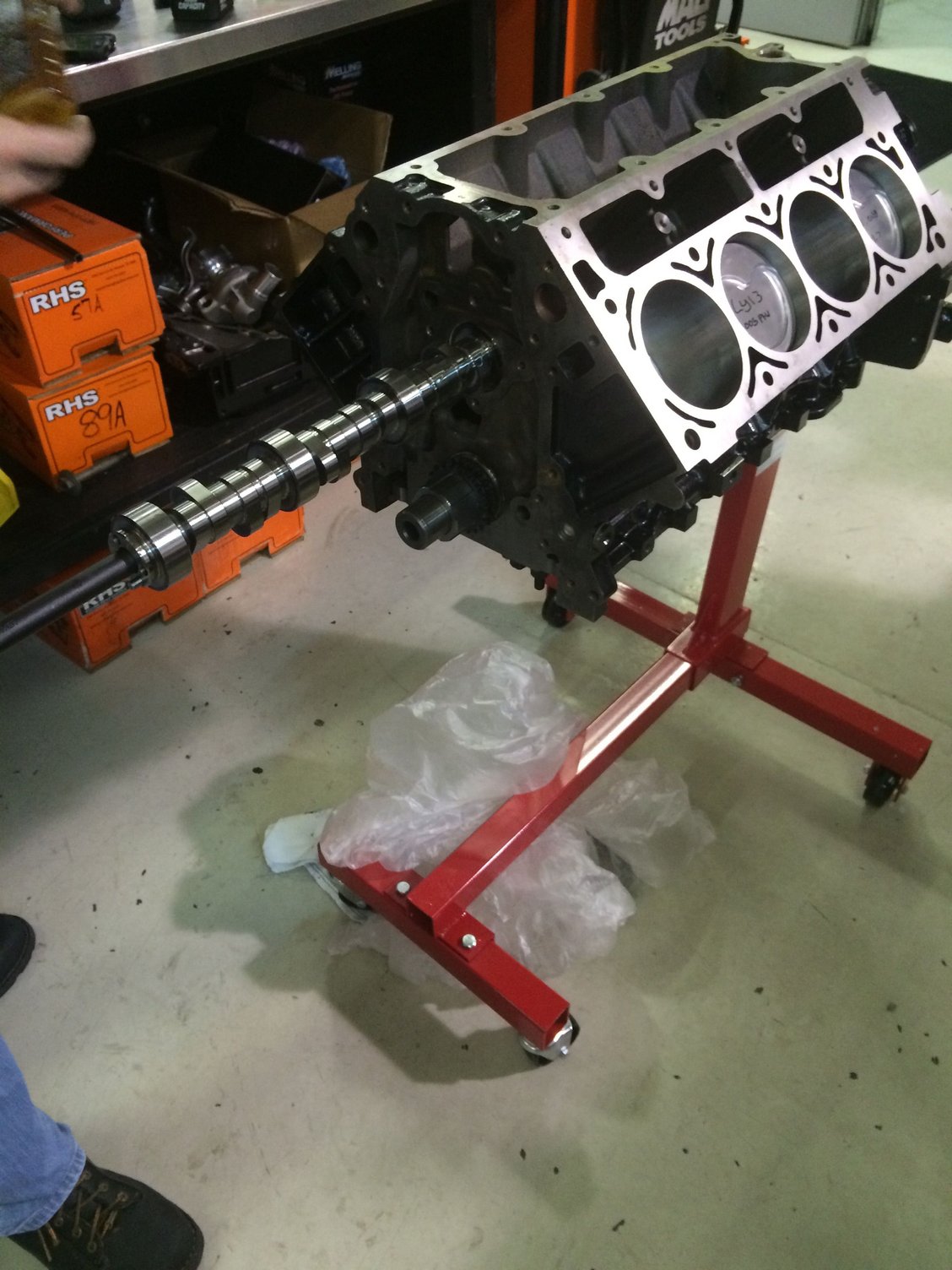

Thank ya brotha! Here's a couple more with the cam and chain on. Comp double roller with a big bump stick

What cam are you running??? Keep thinking about doing this mysef on my 99 and the more i think about it, the more likely i am to do it!!!! Nice build btw!!!
We did a custom grind. 230/242 @.050 627/627 lift on 115lsa. Big nasty

That is a big nasty cam cant wait to see how this turns out

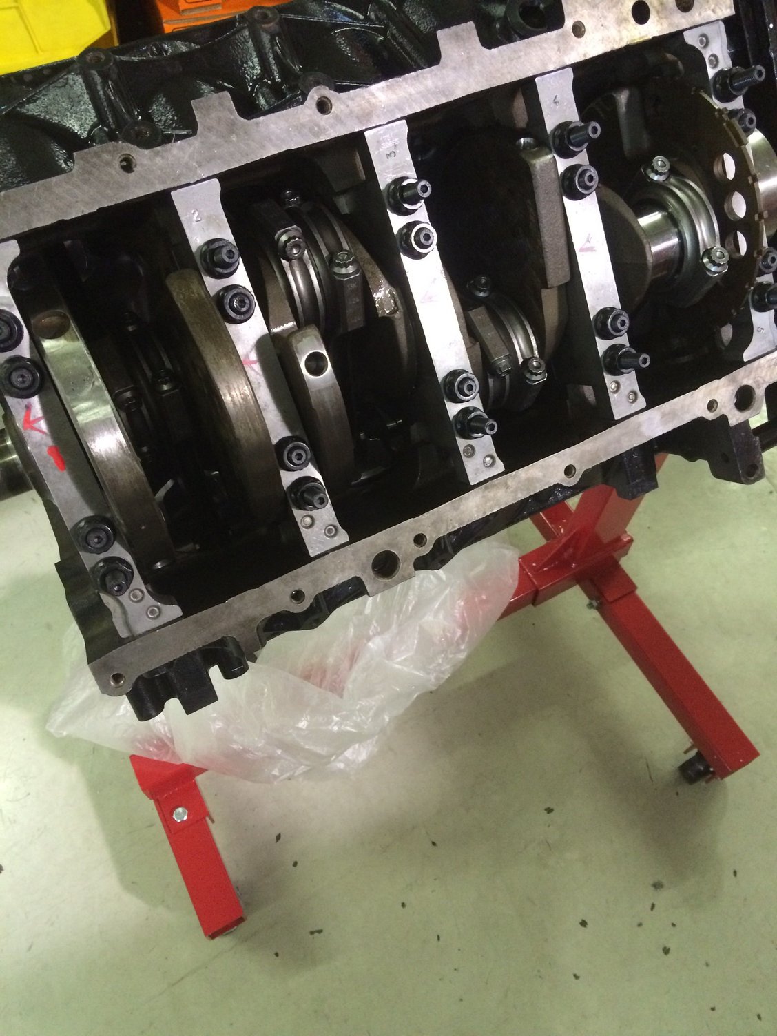

Studded for your pleasure
studded
studded
Ooooohhhhh baby!!! Lol
