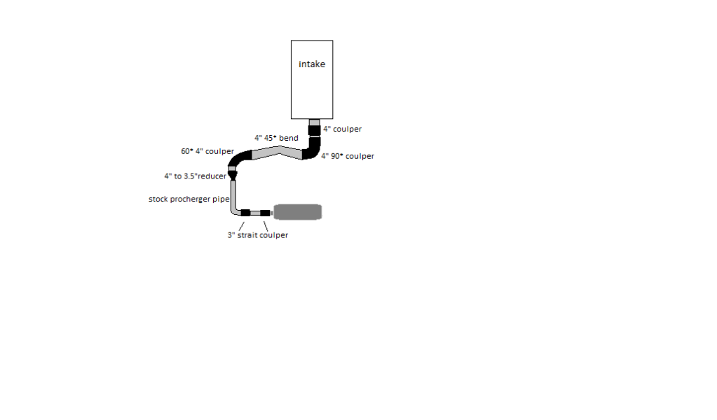

so I picked up a 27x8x4 intercooler. Going to reroute the intake tube from the tb to the intercooler. And weld some nuts for the iat sensor and the meth nozzles. The new intake will look something like this.

That should work, I think my old air to air was a 31x12x3 IIRC.

ordered the intake tubing, some silicone couplers, and some t bolt clamps to help keep it together. The iat sensor showed up today. Thinking about running it in the aluminum pipe just in front of the TB, and run the meth nozzle in the 45* bend pipe just in front of the 90* bend. Just need to find an aluminum 3/8" npt nut to weld onto the tube.

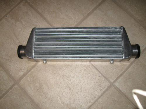

heres a pic of the intercooler from the seller.

I'll take some better ones when it gets here. Its in Hawaii so it might take awhile.
