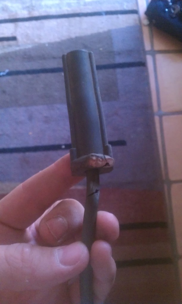

Just did the spray bottle test. Looks like cylinder #5 is not firing. Gonna take the intake manifold off tonight and check the gaskets. Then the valve covers are coming off to look at the springs

Its crazy how it can be the smallest things. lol. Took the filter off to start looking around and the protective sock for the spark plug wire was all the way up next to the coil. Swapped on one of my old MSD wires and fired it up. Idle was way better and afr is back down to 15.2
here is the bad wire

At least now you wont have to pull the intake and valve covers!
