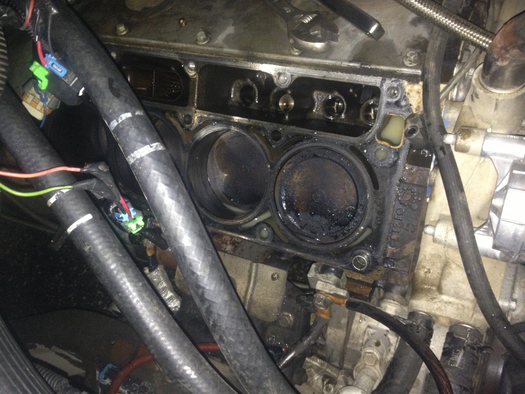

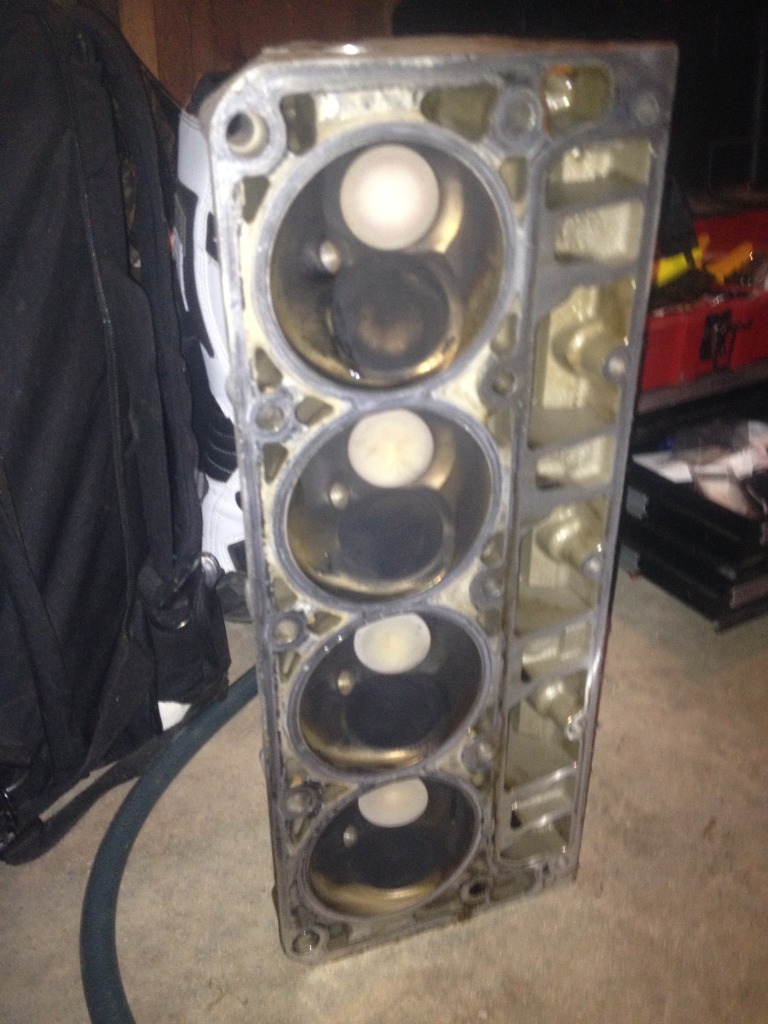

I don't really have a choice though lol. Head is off. Looks okay to me
And the lifters looks good. No pits or uneven wear

When I turn the crank, when piston 2 gets to tdc it gets hard to turn and it seems like it stays there for a bit. So I'm guessing bent rod? The drivers side head is still on. When I get back from the field on Thursday I'm going to take off the procharger and head and see what I can find. But I might be looking for a new 6.0l here soon
