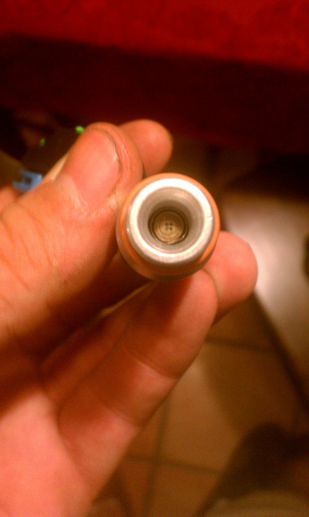

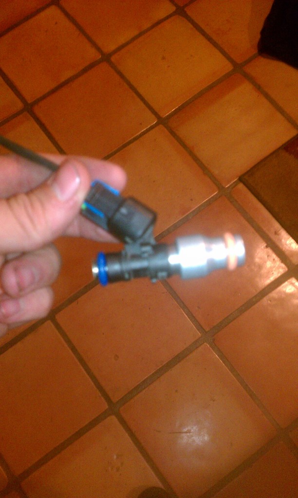

This is what I mean by the spacer
and the adaptors only have about 3" of wire. Should still be enough.

I would think that would change the spray pattern of the injector wouldn't it??

Thats what Im askin about. Anyone have a like to the spacers that I need?

I'm having a hard time understanding why you can't use the spacers above the injectors.
