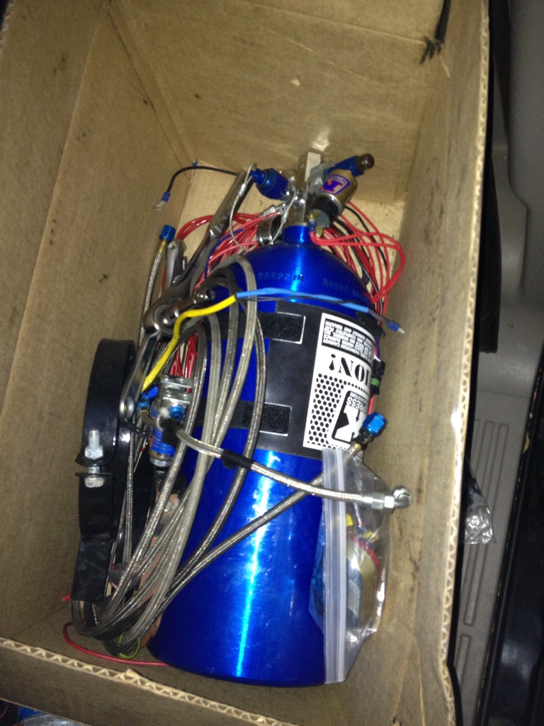

No real updates. I picked up a used nitrous kit last night. Going to jet it for 50hp. Hope to have it set up and ready for the track on the 19th. What jets do I want for a 50hp shot?
Old Jan 13, 2013 | 11:27 AM
  #1039
smokeshow's Avatar
Mod with training wheels
Joined: Feb 2009
Posts: 7,741
Likes: 207
From: Detroit
I found this site to be useful and accurate:
Nitrous Oxide fuel Jet size and HP Calculator nos n2o

Thanks. And I picked up the kit. Need some help with the wiring though. I'm going to use a push button to activate the system for now. Eventually I will get a window switch to activate it.
