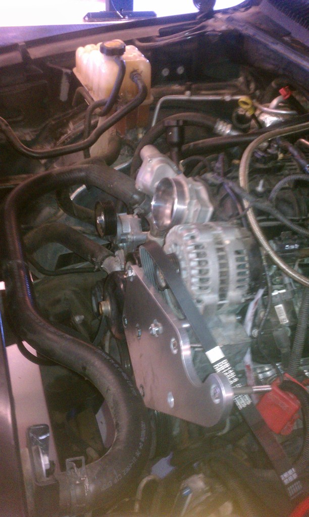

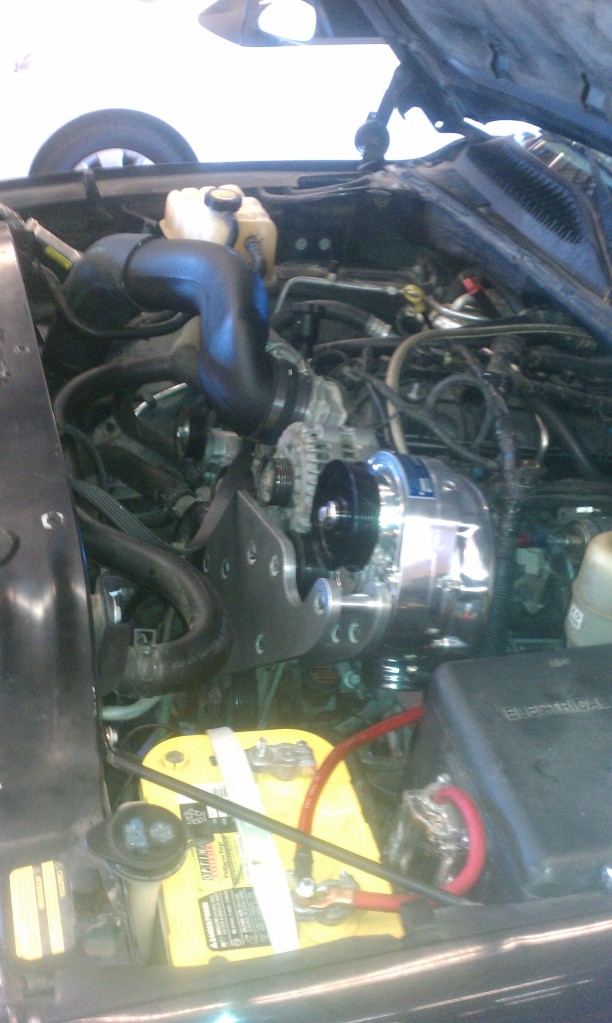

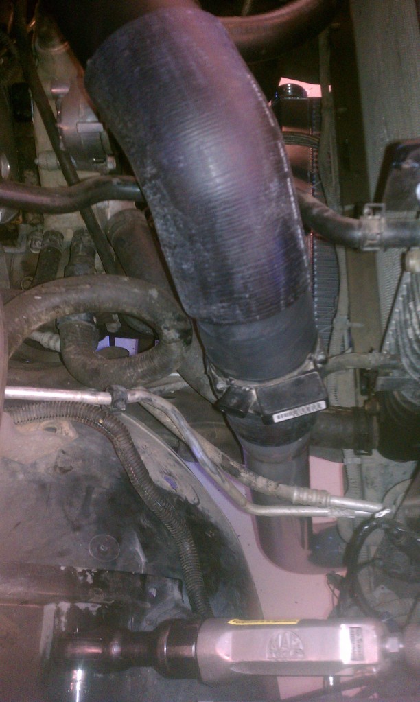

some more pics of the install. since the brackets were for a 05 the porcharger outlet was strait down, This made it hit the alternator bracket. I had to re clock the procharger and grind alittle off the corner of the bracket.

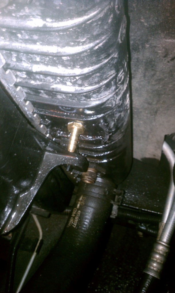

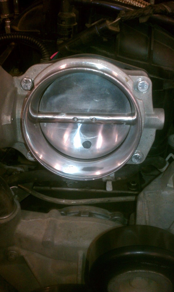

Accidentally broke the plastic barb that goes across to the TB. This was the fix

Thanks. Im kinda amazed that I was able to drill and tap the radiator for the fitting. But its working great. No leaks.

Had to re clock and grind a spot on mine also, I was nervous I was going to screw something up with the pro charger.
